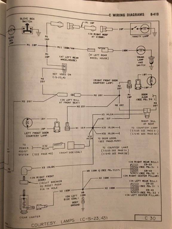

Yes I did... it’s a pink wire running parallel to the wires feeding the left rear reading light from the same part of the harness coming up from the floor. Seemed like the long way home to me.
Here’s page C30 showing it coming from the same place.

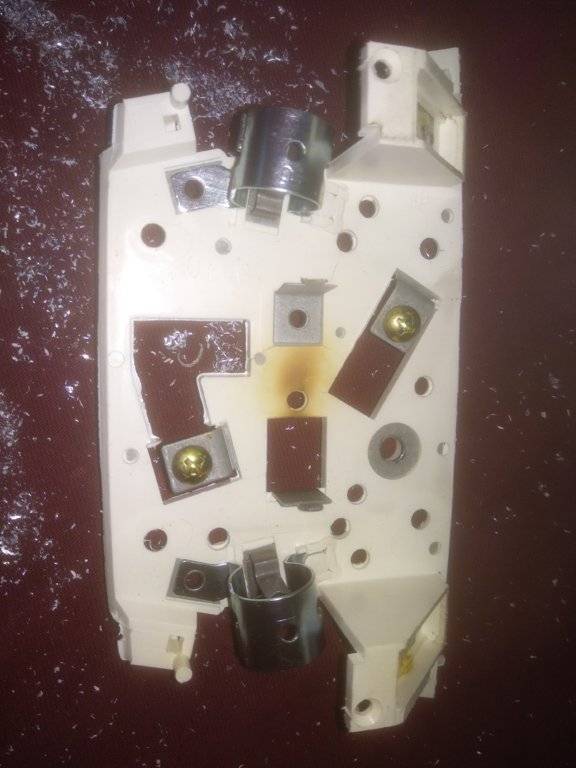

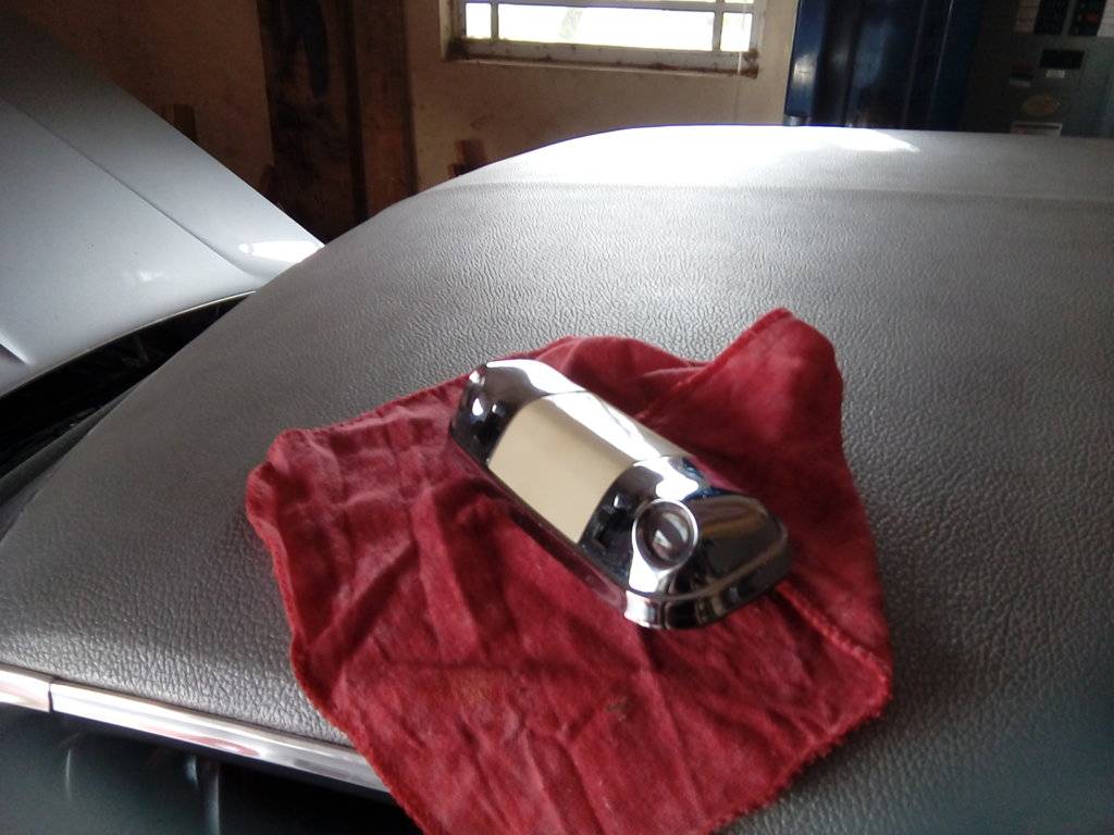

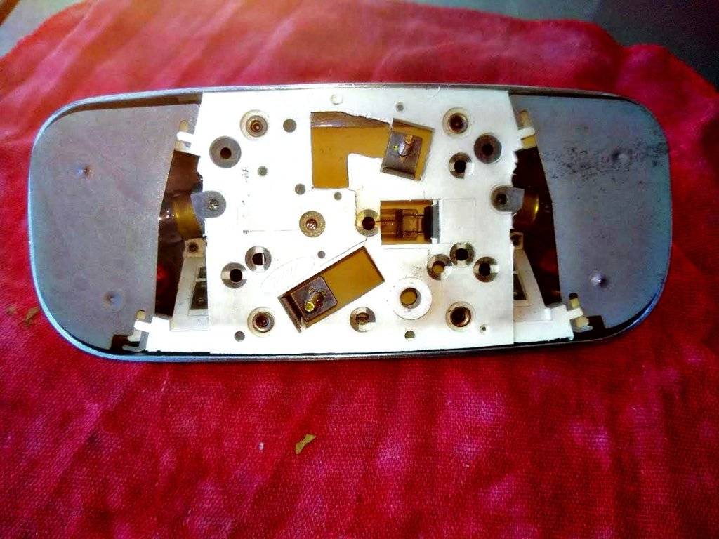

I looked at the diagram and there are two wires going to my dome light.
One wire is hot.
One wire is the ground wire when the circuit is completed by door switch when the door is open.
You following this? You with me?

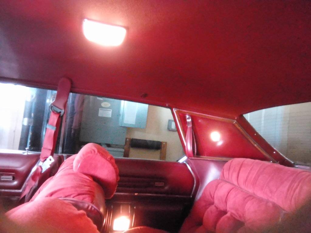

All I have to do is run the hot lead to the dome lamp and the two reading lamps. I then will simply have the switched reading lamps go to ground.
That’s exactly what I did.
But please note that the alternating line goes from negative to positive.
So you will need to isolate it accordingly.
Likewise, the logic of my fixture is set up for the reverse (full time ground with alternating hot). Yours may be different as mine came from a Mark IV and yours from a truck.
One advantage to the dome lights and map light combo with our wiring is that the positive load from the map lights is actually shared by both wires when the door is closed.
One concern I had was that the resistance in the 14 wire might get hot with the map light on for an extended period while driving.
Will probably change to LED’s for more light and lower load throughout all the interior lights.
All those lights are a hell of a draw against the battery..... and cook the lenses.

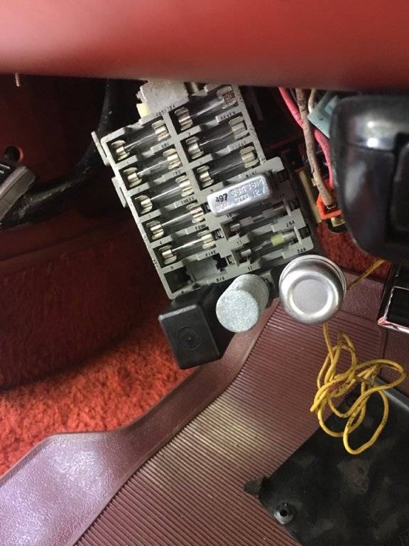

I had a few timers I scavenged back when UPick was UPick.
It was just missing the timer on the fuse panel. Easy fix.
Simple plug and play. Light stays on for a bit over 7 seconds after door is closed. Happy!!!
