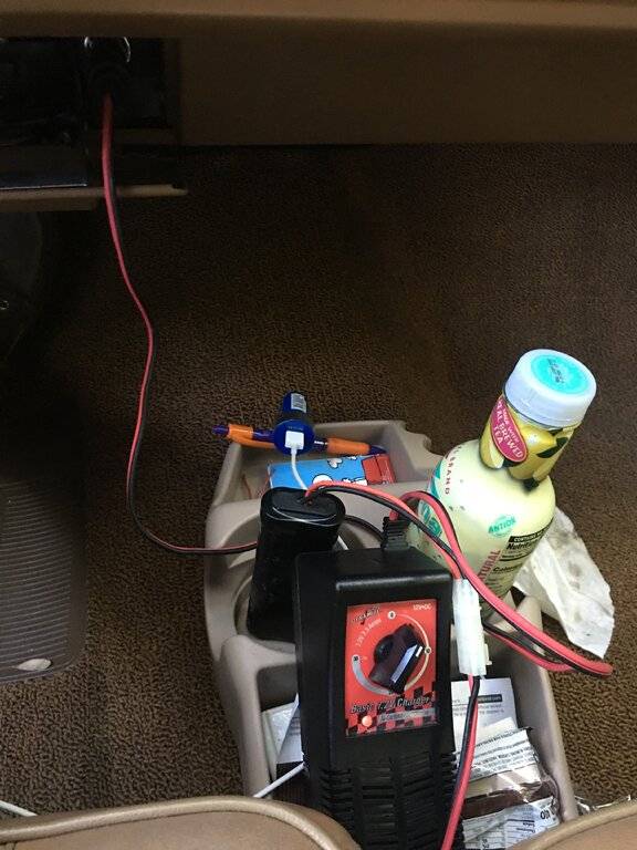

I also have a car charger for the battery....

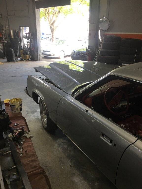

Cut and polished now.....

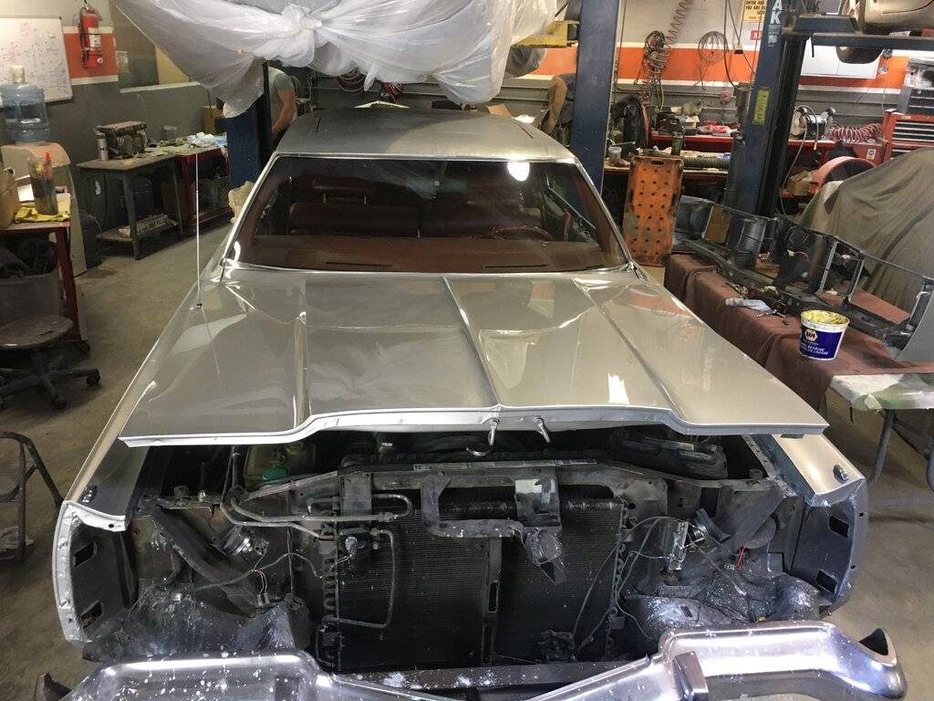

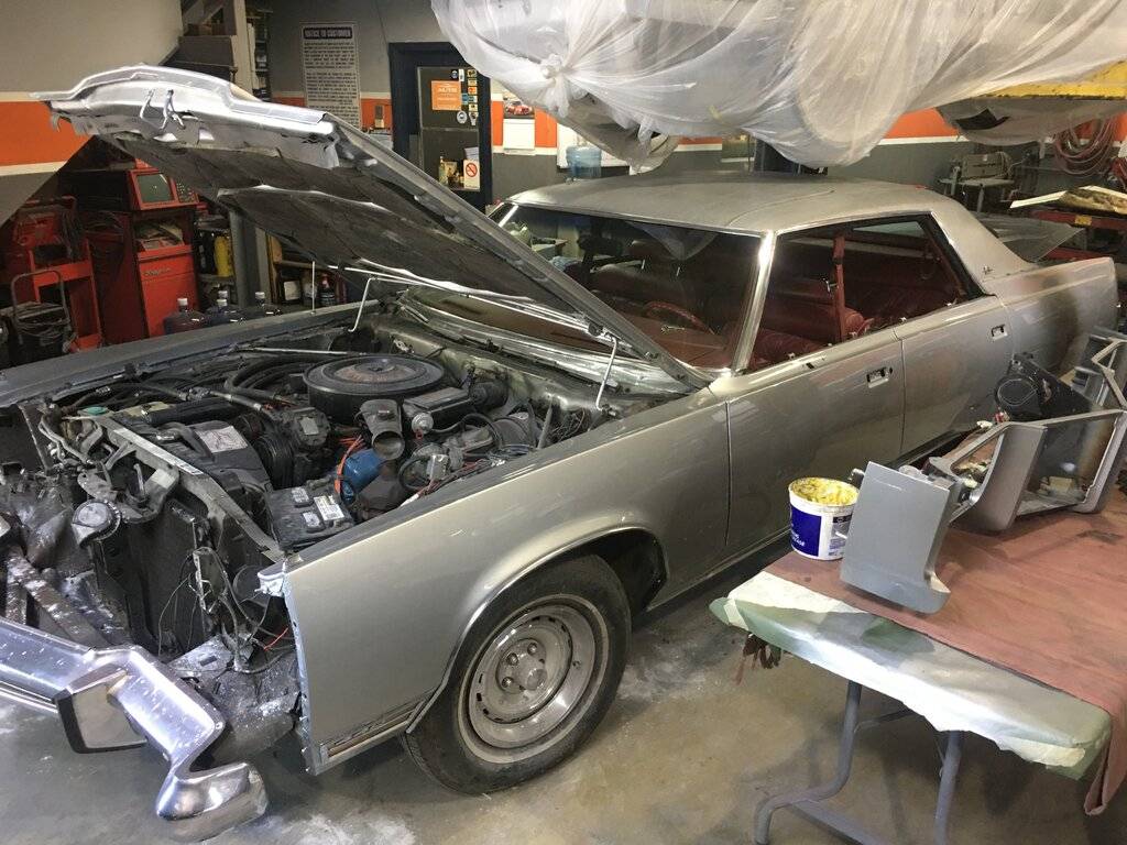

Hood on and looking like a mirror..... look at the reflection. Way to go guys!

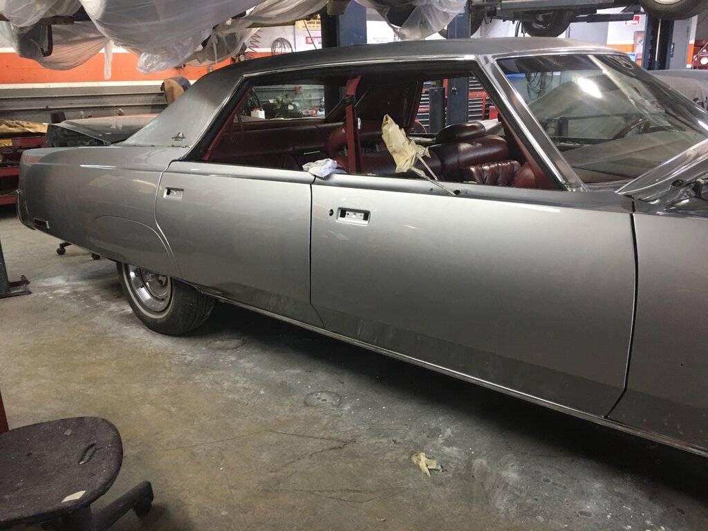

3/4 front. looking shiny!

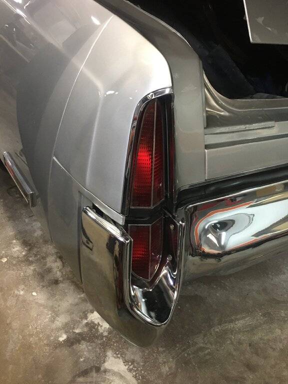

Tail light and trim detail of body line rehab.

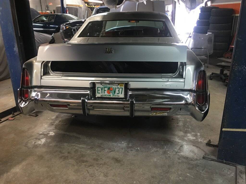

Rear bumper cleaned up and installed. Left the sticker for FCBO on.
I really love how the color changes as you go down and highlights the sculptural lines on the body.

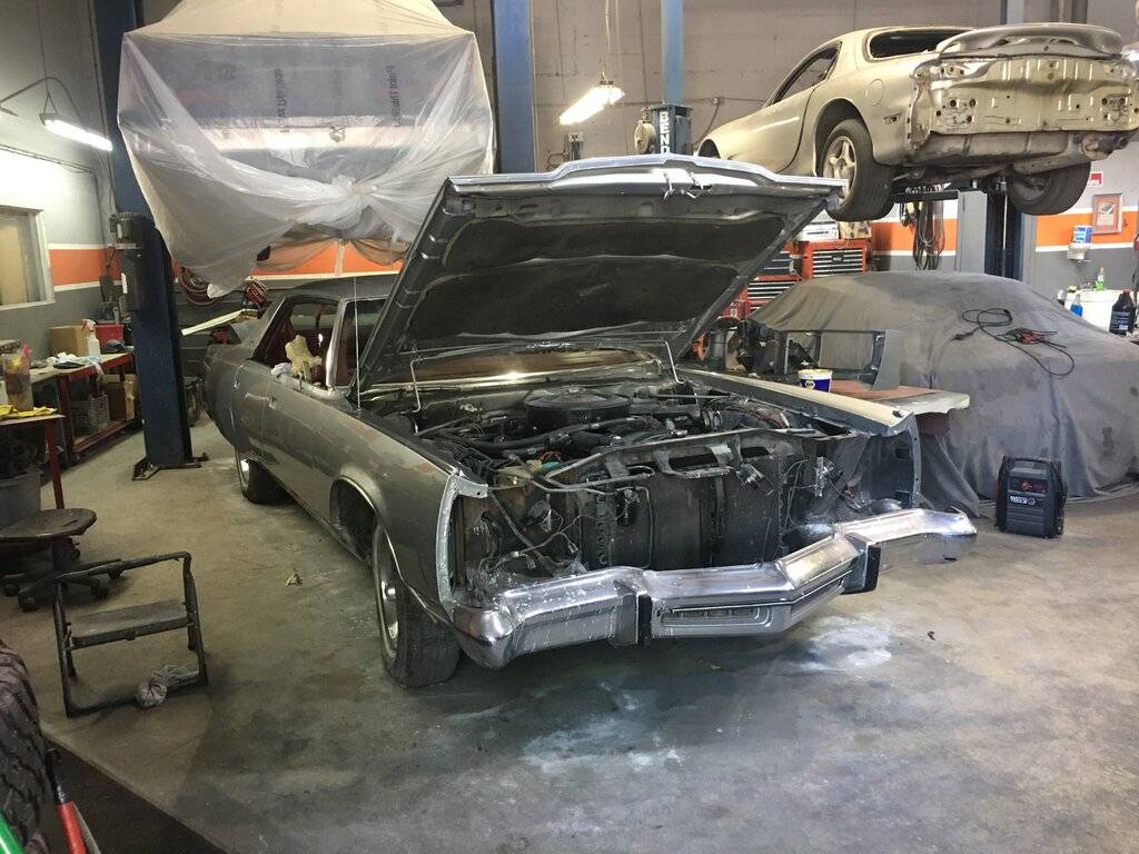

3/4 from front with newly reattached hood

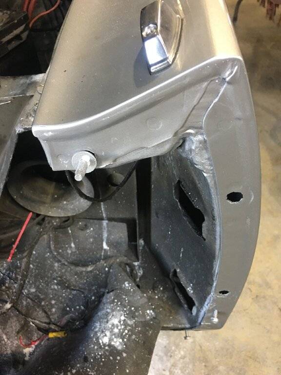

Front cap having lights assembled
More.... some details

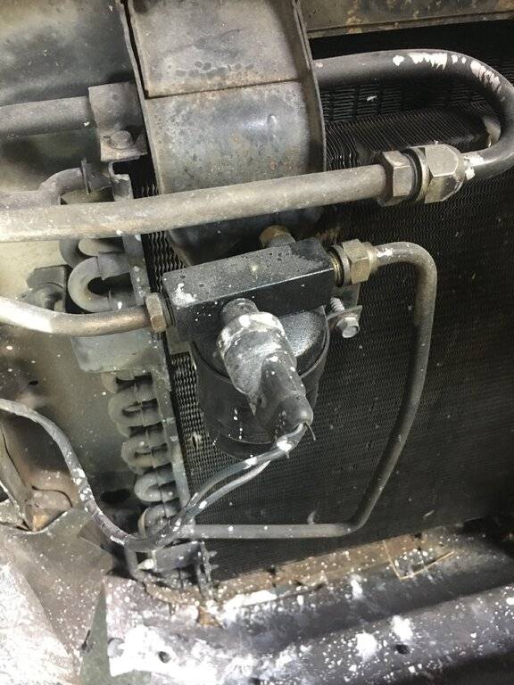

New dryer went in before paint and system was vacuumed down to test and given a shot of good old R12 to hold a little pressure and keep things dry. Unfortunately, it was a victim of the polishing compound.

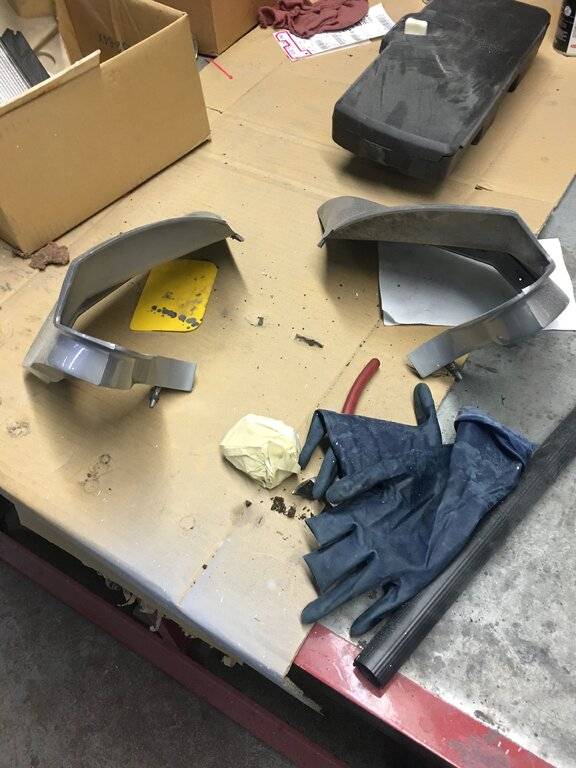

Decided to epoxy the screws back I. When I assemble it. Should be fine.

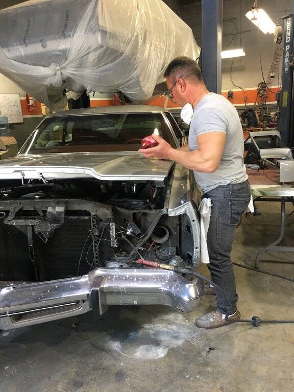

Final wax started. That’s Nestor Díaz.... the man of the hour. He was literally running from back to front to get the streak free silver on right

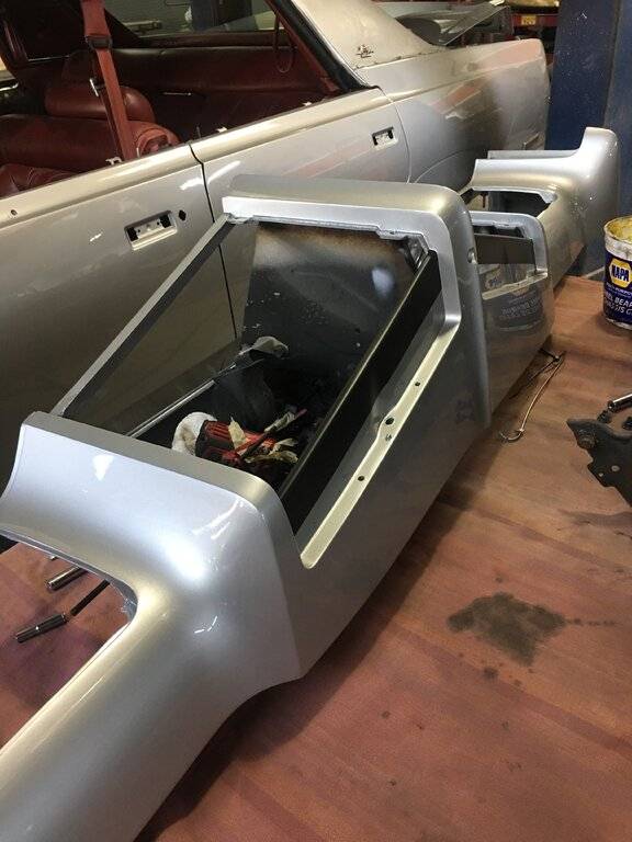

Front fillers ready to go on.
Front filler pieces and bumper ends

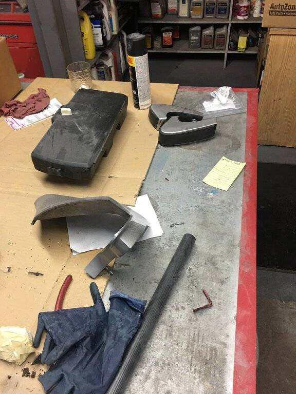

Javier, Let me know how you plan on doing this. Will you drill out the fiberglass and then epoxy in a long stud, or try to use the factory stud that has the screw end and the machine screw end? Almost all of these screws have the nuts rusted on them, so they have backed out of the fiberglass. I am not sure very many will be reuable.
