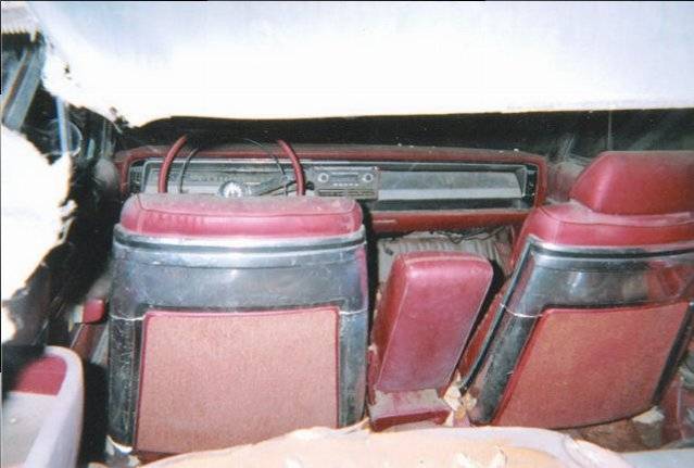

That is what appears to be a very nice 1966 Imperial LeBaron, it is not a 65. I also own one. It has a 440/727 and is a joy to drive. Imperials are a little different than ordinary Cbodies in that, for one thing, they are still full frame cars in 1966.
Love that model. The rear view should be projected on a screen as you drive.

That red interior is to die for - beautiful. But then so is the whole car. One of my favorite years for Imperial. Just one note, if you are looking at adding something to the rear springs because they're sagging, you might just be able to re-arch them. I did that with my Fury - they had lost so much of their 'spring' that they were starting to arch down instead of up. Re-arching did wonders, even after several years have gone by. Won't affect the ride like adding another spring or something would. Just a thought.

You have a '66, so it's gonna have the 440 versus the 413 in the earlier Imperials. Nice things about the '66 are: No pushbutton shift. No need for a rear drum puller for a brake job! Real walnut veneer trim.
Beautiful interior!!!
A couple of more giveaways to readily identify a '66 versus a '64 or '65:
The '66 has a small "Imperial" script on the right side of the trunk lid.
Of course, the grille is readily apparent.
The reverse lights are in the bumper, and there are four tail light lenses on a '66 versus two for the '64 - '65 cars.
The wheel covers used on the '66 are the same through 1968. I had an alleged '66 "expert" try to tell me I had the wrong wheel covers on my '66; to which I replied to him "So, I guess every other '66 out there running these is wrong, too, eh? Oh, check your dealer brochure, too, buddy!" --- He sure pissed me off with the attitude!

i'm a fan of chrysler corps interior color combos with the metalic tones , my 65 880 rag has dark n lite red met . fresh its very cool looking , i can see why the gal that bought the car new fell in love with it when see saw it on the floor of the dodge dealership . white with a black top and that two tone red met interior most have been a site . one of my 67 300 rags has red met interior in leather . did it come in the dark red as well ? sorry on pics of the 65 880 rag , got in an issue with the interior right now , damm guy lost the yardage , how ?
