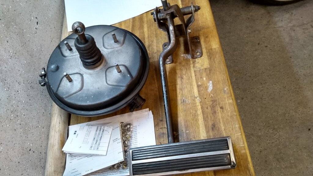

Today i disassembled booster and pedal.

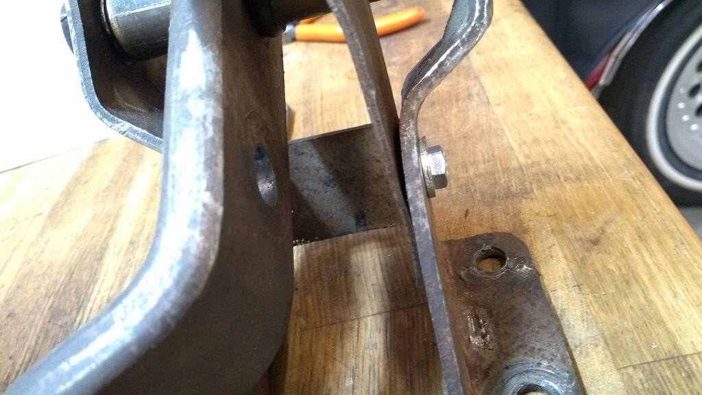

First I cut the screw from the bracket for the brake light switch. It pressed against the rubber bellows of the booster from behind. The next few days I will mount the pedal a bit higher so that the bolt fits better and everything is easier to move.
So, i reassembled the car. The pedal works much easier, the bolt of the booster fits perfect, but the problem is not solved. I think i'll need a new booster.
Does anybody have an idea where to get an old one, which i can rebuild in US and then send to germany.
Rebuilding my own one is no solution. I dont want to pay shipping two times and wait the whole summer. The car drives in this condition.....
