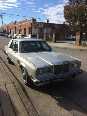

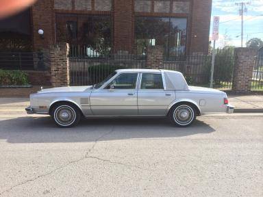

Thanks for all of the help. New tires and an alignment sorted out most of the issues I had with the car. I still need new shocks, but that can wait a few weeks. The car was slow to go into reverse this morning when it was cold. My Fury and Polara do that too. The interior is near perfect with only a little wear on the plastic, fake wood finishes. The steering is not very responsive and it does pull slightly to the right when I firs step on the brakes. After that it stops straight. Here are a couple of pictures.

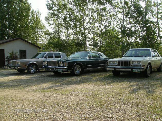

Sweet car. Enjoy. As I said I love my M bodies. (Please excuse the Cordoba between them.).
Commando- ouch. I'm wounded!
Yes they stole cues from the Monte, but I find the Cordoba a far more attractive car. Plus it will actually get me places- unlike the GM.
Weren't we discussing somewhere else of how Chrysler Corp designers looked at other makes when they were designing? This is just another example. Remember, stacked headlights made a comeback in the late 70's and Mopar needed to stay "modern".
