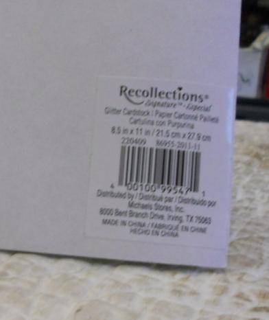

Solution. Buy textured cardboard stock at hobby store and paint satin black.
Perfect match to dash.
Now I have something to glue to new gauge face plate:
As bought:
What it is:
Painted:

2gvt2jn.jpgNice little detail work for the winter time if you have a winter. :) You'll have .0001 percent Chinese parts in it then though.
View attachment 6085Nice little detail work for the winter time if you have a winter. :) You'll have .0001 percent Chinese parts in it then though.
That recyled material in the card stock originated from the USA.........was liberated by Stan and reclaimed as American material. The gage is now 100% American parts. LOL!
