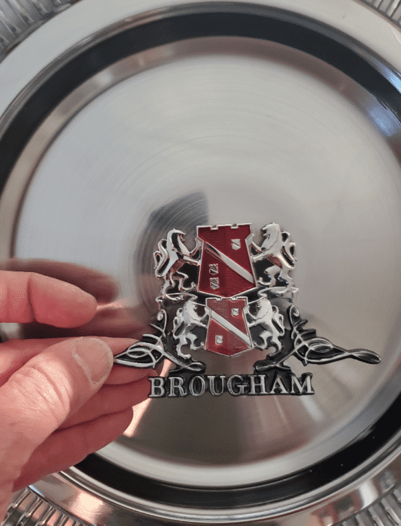

Here are the Pics. There is a plastic and plexiglass place around the corner from my house. After I add the burgundy paint I will see what they can do.

I got around to painting the Emblems on the Hub caps yesterday.

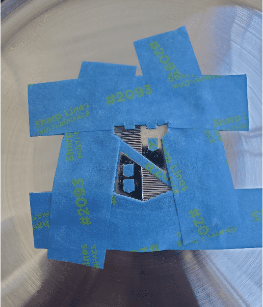

Taped them off and took them outside for painting.

Here is the painted Emblem.
To compare the color I used a NOS Roof Emblem that I have. Two different Dupli-Color red paints were used to come as close a possible to the original red. (2 coats of the lighter red followed by 1 of the darker red then a clear gloss.) The match was close enough to satisfy me.

Man that's nice!! They're so nice I'd put them up on the shelf and just look at 'em....Really! Too nice to put back on the car LOL!
