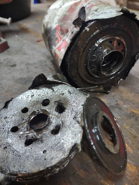

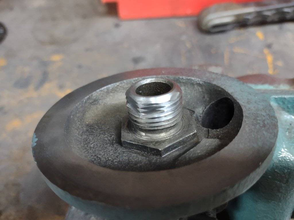

So my oil filter would not come off and after trying everything i could, i pulled the oil pump, put it on the bench and used a die grinder and chisel.

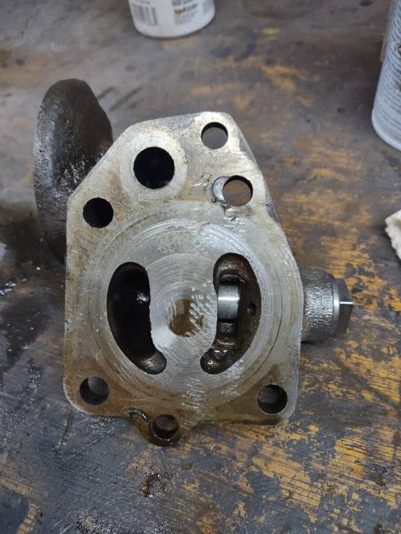

Picture of the threads on the oil pump housing?
not madly in love with where the vice jaws dug into the surface...i'd just slam a new pump onto it...prime it first
See those vice jaw marks? Basically that pump is now junk. That face has to be smooth so the rotors can turn smoothly and needs to have minimal clearance to maintain oil pressure.
It might work OK, but if it were me, I'd toss that one over my shoulder.
And like @volksworld says, prime the new one first. Some guys cram grease or vaseline in it, but my preference would be to use a driver and a drill to prime it.
Thats why i show pictures cause i never really saw that. Just got it clean. Must have come from trying to get that filter from hell off.
