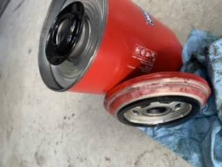

I did have the motor at TDC when I pulled the oil pump gear began spinning the drill counterclockwise. I didn't yet begin turning the engine to actually allow the oil through the various parts of the valvetrain yet. It was less than five seconds once I felt the drill jolt and hear fluid moving before the filter burst open at the rolled end of the seam near the base of the filter. At least the pump is oiled now and should pick up oil faster when I try again tomorrow with the Wix filter.

Blown up filter off. New wix filter on and gauge hooked up. Clicked the drill for and instant and pressure over 100psi . Time to drop the pump?
You should not be getting 100psi, pressure relief valve is stuck.

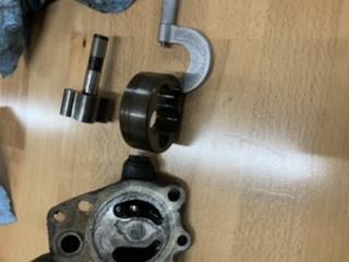

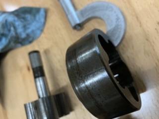

Well removing the pump was a PIA. Getting it back on will be worse. I see a large score on the outside rotor . It is strange to see a vertical mark. Some other horizontal scoring that looks like it could be buffed out. The relief valve plunger is stuck. Not sure I can get it out easily. Looking like time for a new oil pump?

Wow, didn't know they were even capable of 100 psi, thanks for the post!
Yes, new pump. Take apart and clean when you get it
