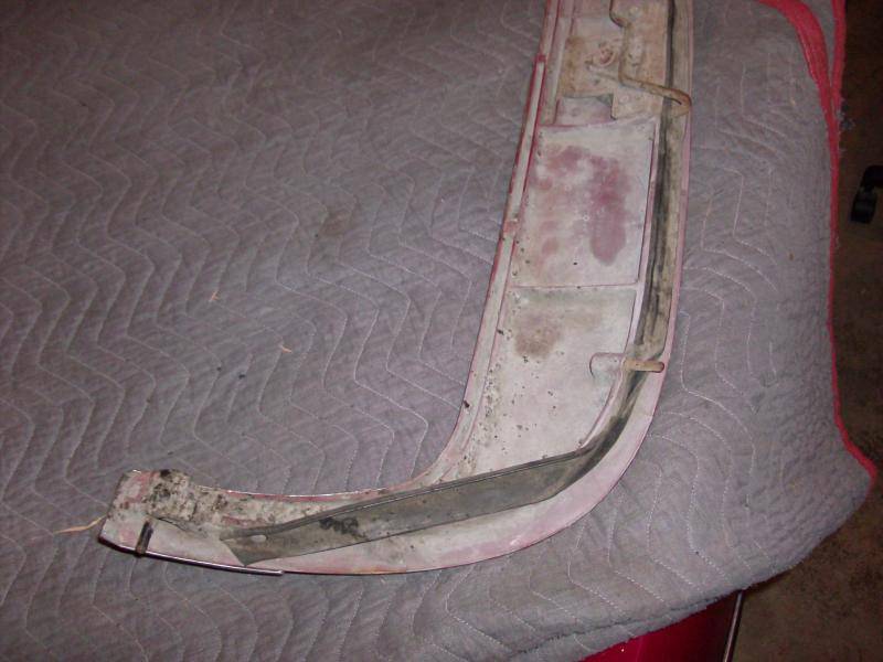

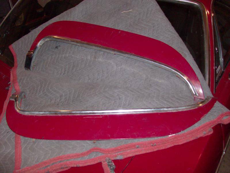

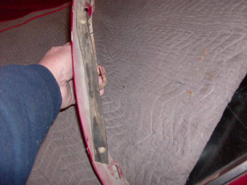

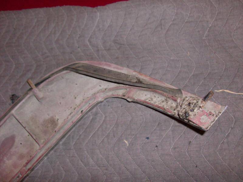

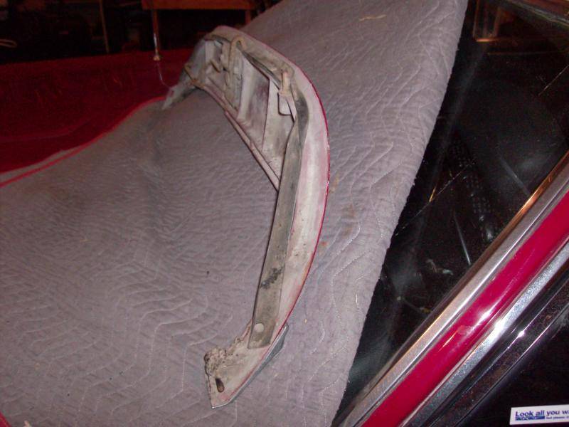

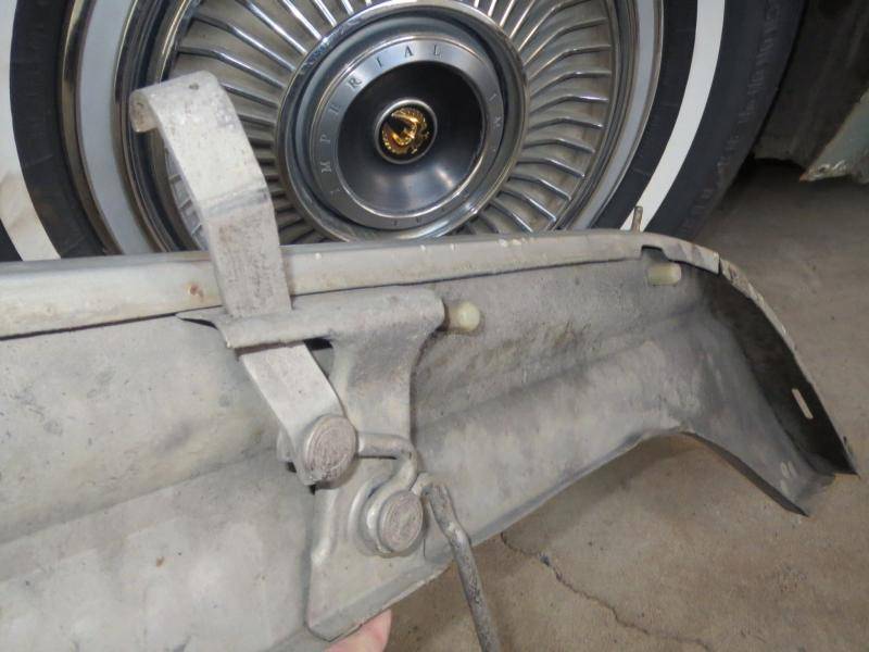

Stopped at the Chrysler Dealership on the slim hope that they would have some hardware. No dice. Like I thought,holes will have to be made for the two pins. He also thought that two more pins would have to be added that go through the two slots on the other end of them. These would have to face downward. He felt that the pins do nothing more than keep the skirts from rattling, the locking function is done by the hook on the end of the rod. He wasn't sure if the rod hook goes into something also,or just hooks on the wheel well lip. He also recommended unscrewing the existing pins and matching the skirts to the car to ensure accurate fit and measurement for the holes. I'm not sure I would want pins facing downward since I might not want to run skirts all of the time. I'm adding pics for viewing and opinions.
