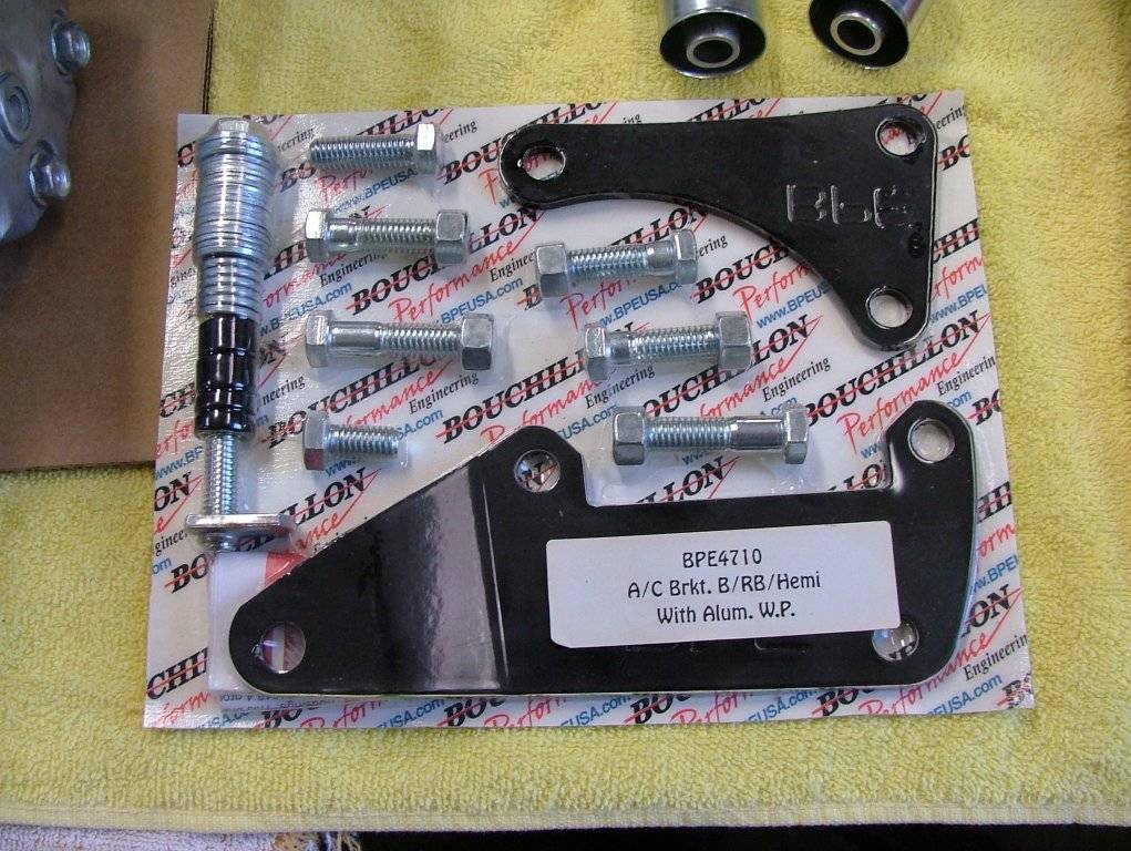

If you have a 383 or 440 this is what I used from Bouchillon.

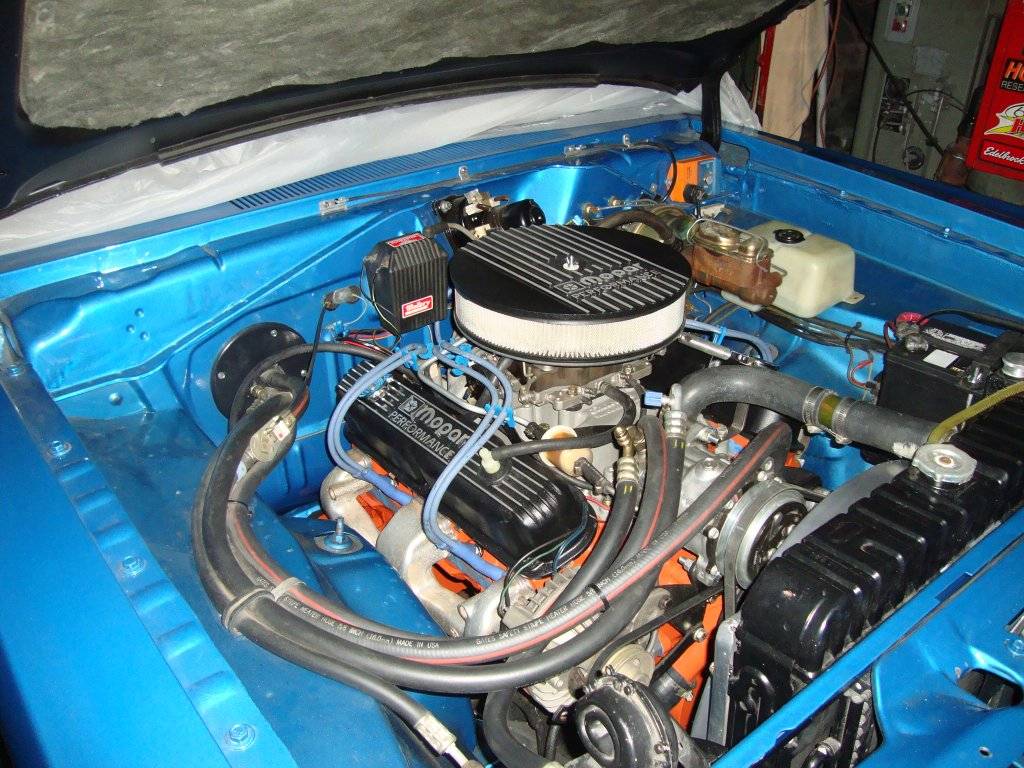

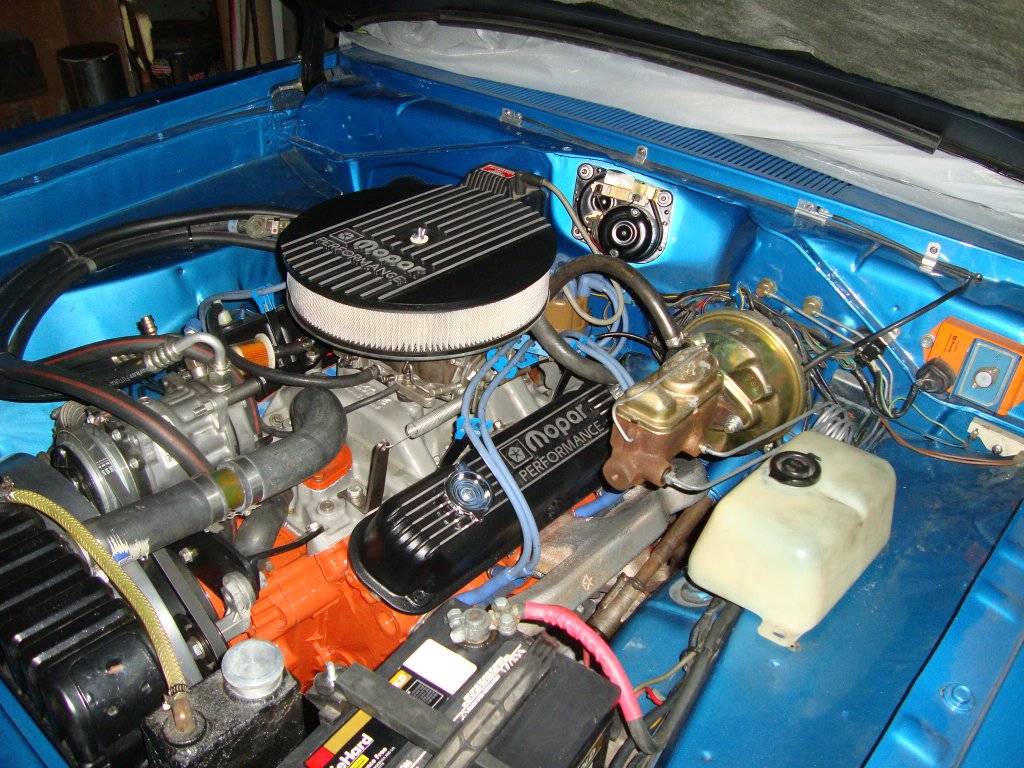

well we are running a12 from duracool , it's friendly with all types of coolant lines and fittings . it's a tiki torch fuel . it's cooler than 134 or r12 and it uses a low head pressure so leaks don't happen and its easier on the whole system . we used it on this 340 4spd duster a my buds buick with a 500 inch cad in it .
just a note regarding the evac of the system , my buds cad makes 22 inches a vac , so he used the running engine to evac the a/c system , then just let the charge in and normalize and free it of any bubbles in the system using the sight eye on the a/c system itself . so you don't need any equipment to get this recharging process done .
