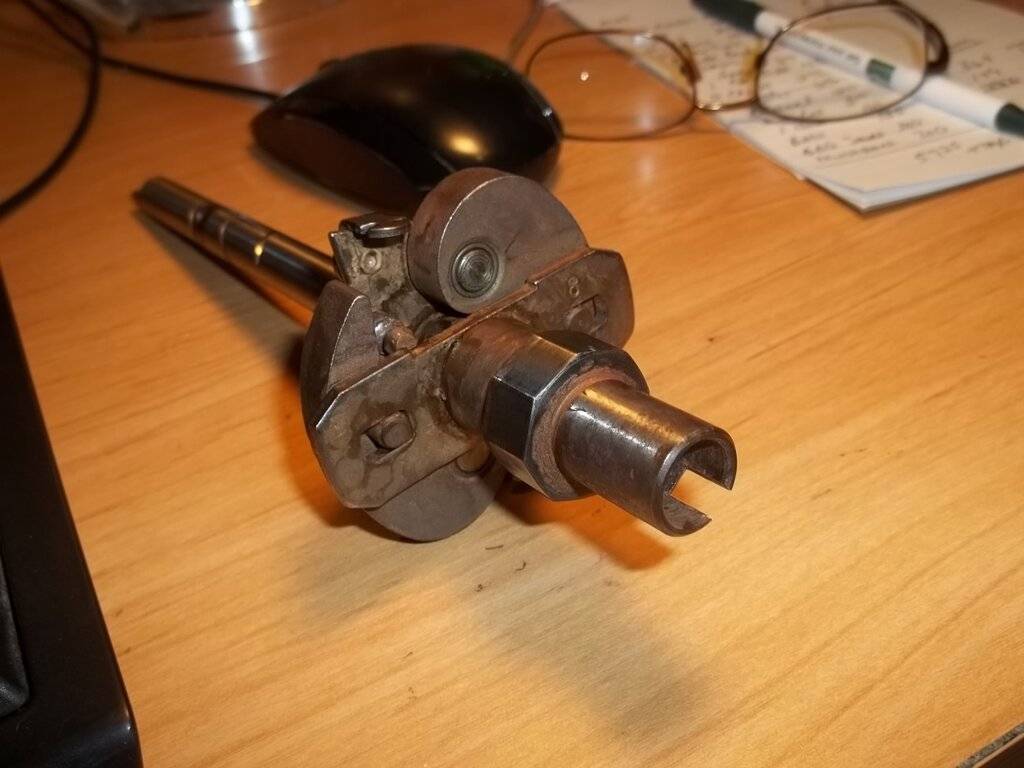

I pulled the distributor out of the engine today.
I could tell something wasn't right. So I disassembled it. Sadly I broke the nylon retaining ring with a mis strike while removing the roll pin.
Sure enough, the advance weights were gummed up and wouldn't move. With the springs pulled, they were still gummy and stiff.
A can of Brakleen later and now they are loose as a goose.
But what's with this advance spring that is so heavy you can barely stretch it. I've no desire to put ultralite springs in the advance but this is ridiculous!
And I need nylon retaining rings...and a couple of thrust washers.
Pic for fun...yes was worse than that!

Primary and secondary. The stiff spring is what keeps it from advancing all the way until you get to higher rpm. First spring ( light) regulates your initial mechanical advance up through about 1500 rpm. If the light spring is too loose or has slack your mechanical will start advancing around idle. You don’t want that. It should start allowing the weights to start going out around 1000 -1050 rpm. Then the centrifugal force starts working on the heavy spring keeping the advance steady up through 5000 engine rpm.
Probably not the best technical description, but in simpler terms.

If you need distributor parts check with @halifaxhops. He rebuilds and can also set a custom advance curve I believe. I know he has Sun distributor machines.
I toss those nylon collars they always break usually in the engine. PM me on needs.
After installing a new collar from Mopar, which had to be drilled to fit, I installed the distributor today. No shaft play at all now.
Mechanical advance is now functional, but it took a while to get the stubborn stumble out. It was combination of several things. Timing, idle mix and even accelerator pump squirt all had to be puttered with until the stutter all but disappeared.
The effort paid off with a lot more bottom power. Miz Ruby will spin the tires on gravel and wants to spin on pavement now!
