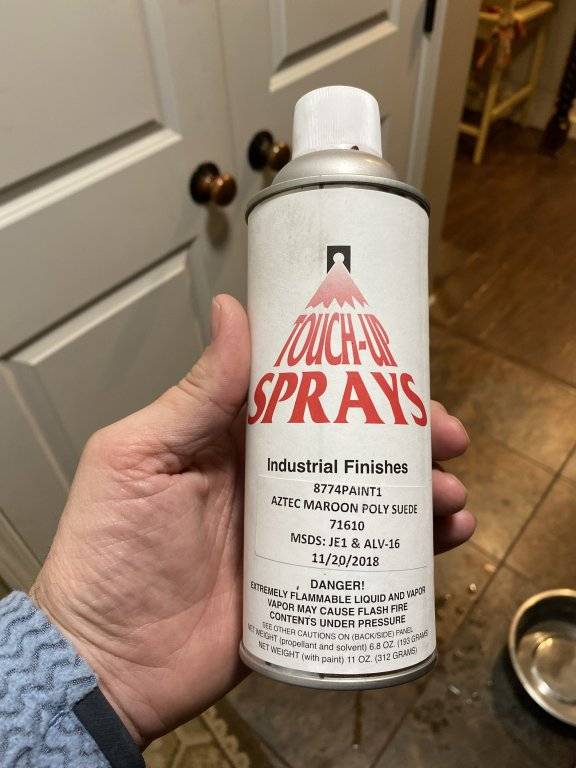

The Suede finish is the way to go. I had the paint shop finish mine in satin. It wasn’t the right texture. Go online or give this guy a call right he can mix the proper suede color in a rattle can. You will probably need two. It was perfect.
8774paint1.com. It is also his phone number. Very helpful over the phone.
This is my correct color for my 68 Polara dash.
