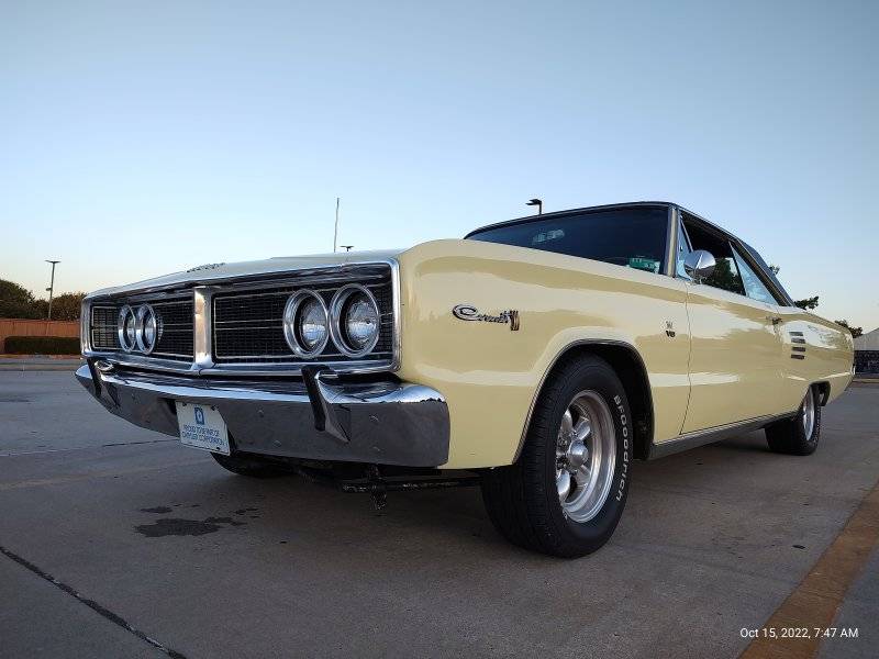

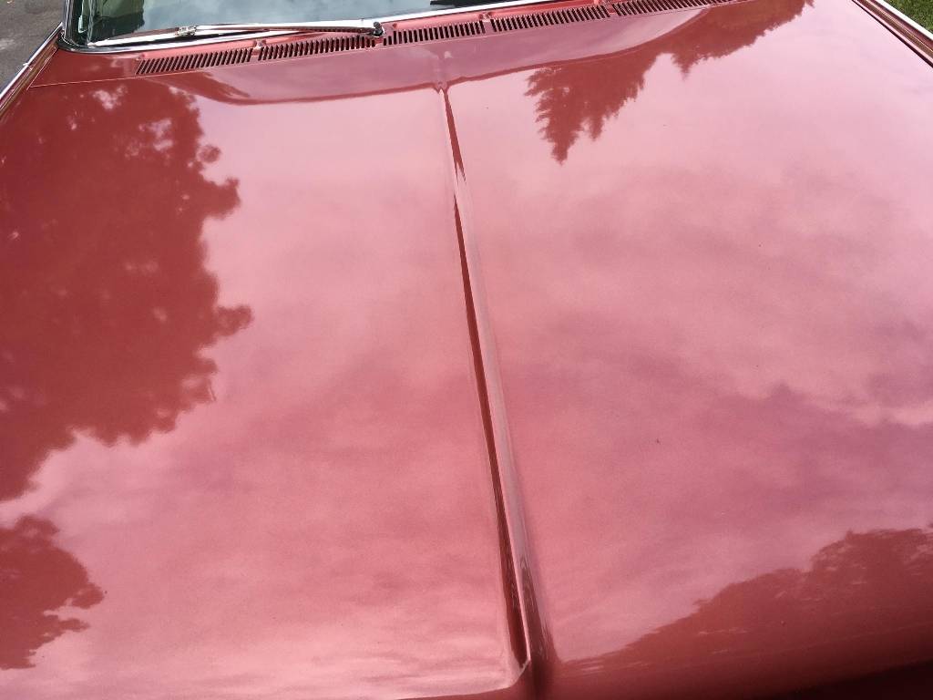

I had a pro do a color correction on the Coronet in January 2022. The paint was is good shape, overall; but it had been painted in 1984 and really needed the pro touch. No matter what I did on that paint, it never really looked right. I'd seen much of my friend's work over the year prior, and was pretty impressed! So, for the princely sum of $600, he made the exterior of the Coronet look brand new, and I mean new! Both pics show the car at two events last Summer.
