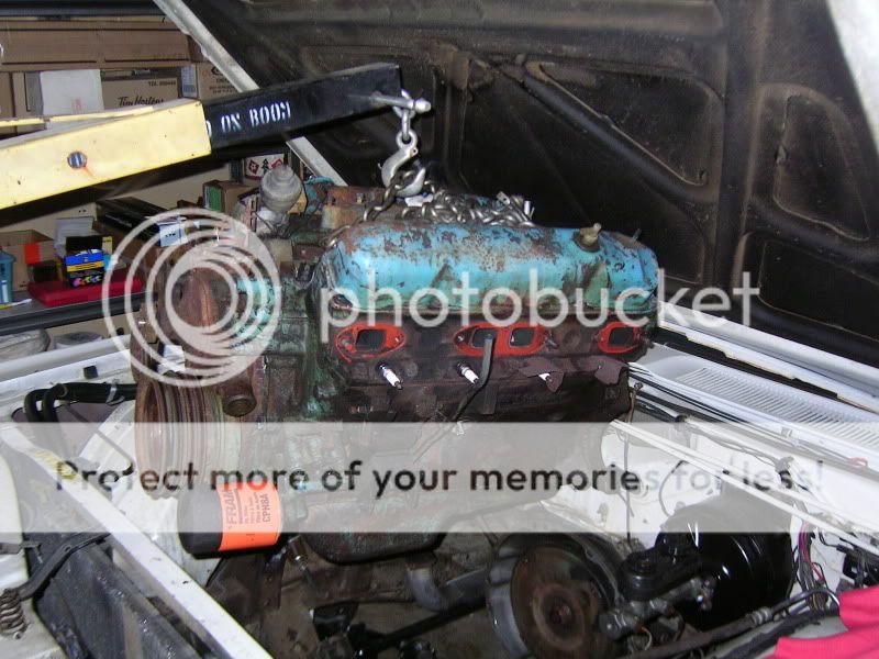

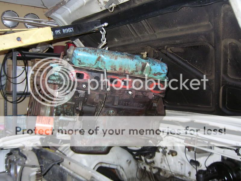

I showed up at the body shop a number of years back just in time to help put the motor and tranny in a freshly done 'Cuda. The car had the rear axle under it and the front was on stands. The motor was bolted to the K Frame. I (and I'm no muscleman) picked the front of the car up (easily) while the shop owner and one other guy slide it underneath, and lined it up to be bolted in place. When i asked why he did it that way he said because he'd scuffed one to many engine bays and had to repaint them.

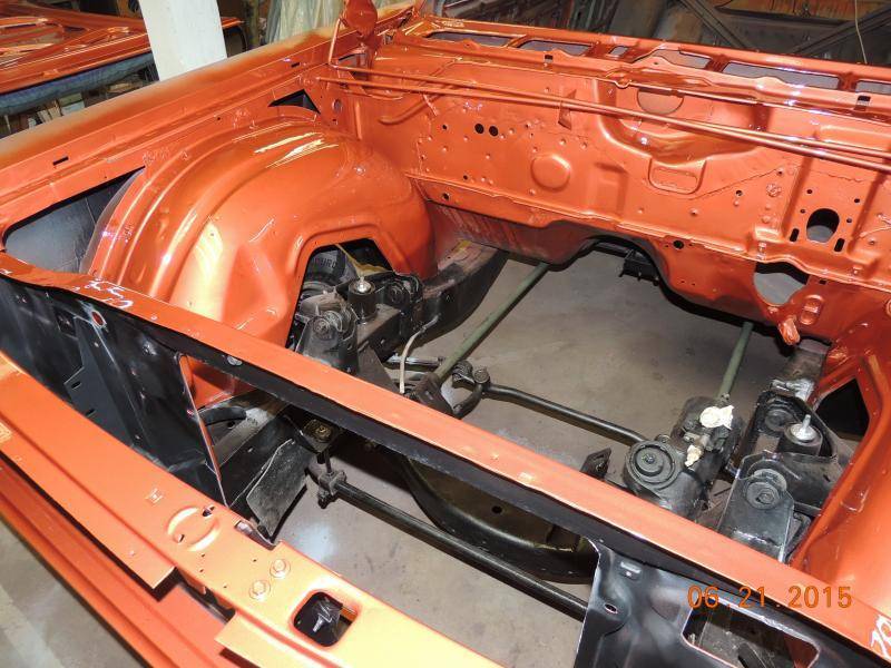

When I took my NYB to be painted they took the hood, doors and deck lid off the car and painted them along with the main body so all were done at the same time. That way, every nook and cranny got the new color. Turned out awesome! They detailed the engine bay like factory original, with the inner fenders in black satin and the fire wall in a satin body color along with the rad support. I'm an original kind of guy, but I have to admit your engine bay looks GREAT in your body color. I guess it all depends on what kind resto you're looking for. I can't wait to see the rest of your car and good luck with it!

Personally, I would prefer to have the hood off when removing or installing an engine. I removed my hood when I pulled the engine out of my truck to rebuild it. When I helped a buddy remove and then re-install the engine in his '69 Galaxie, we not only removed the hood, but also removed the fenders, grille, rad support and inner fenders. I'm not suggesting you do that, but it sure was nice having all of that room to work. :)

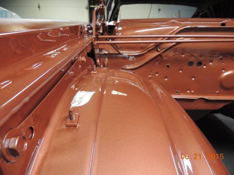

The whole car is not painted yet. Door jambs, hood (back side) and the engine compartment only. Trunk lid is next.
My main concern is hood alignment after the paint is done and color/metallic particles on the hood looking same as the rest of the car. However, having enough room to work in the engine bay and install the motor is important.

Could you assemble and install the engine, install the hood and then finish painting the car? You could wrap the engine with plastic to keep any overspray off of it.
