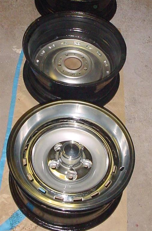

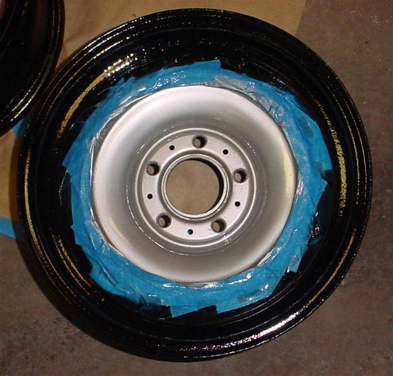

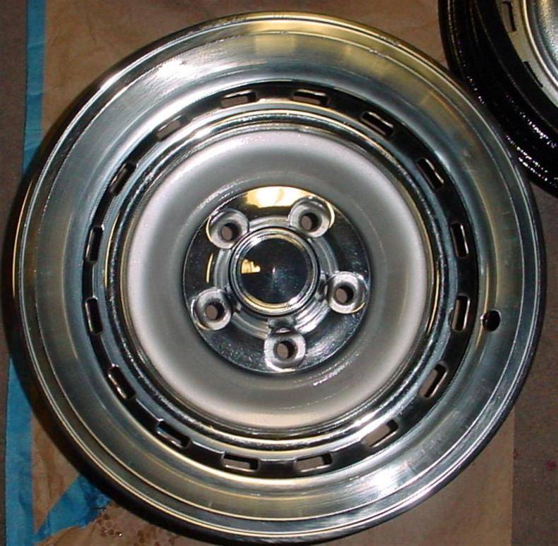

I completely refinished 5 wheels for my 300 just a few months ago. Stans method of taping works well.
I masked off the chrome with duct tape and had them sandblasted on the backside and the inner rim area.
Then polished the chrome, and used a satin silver auto base paint that was on the shelf. The rim was painted black and a clear coat over everything.
I painted the backside of the hub section with "chrome" rattle can. No one can see it but it looks cool.
They are really easy to keep clean too.
