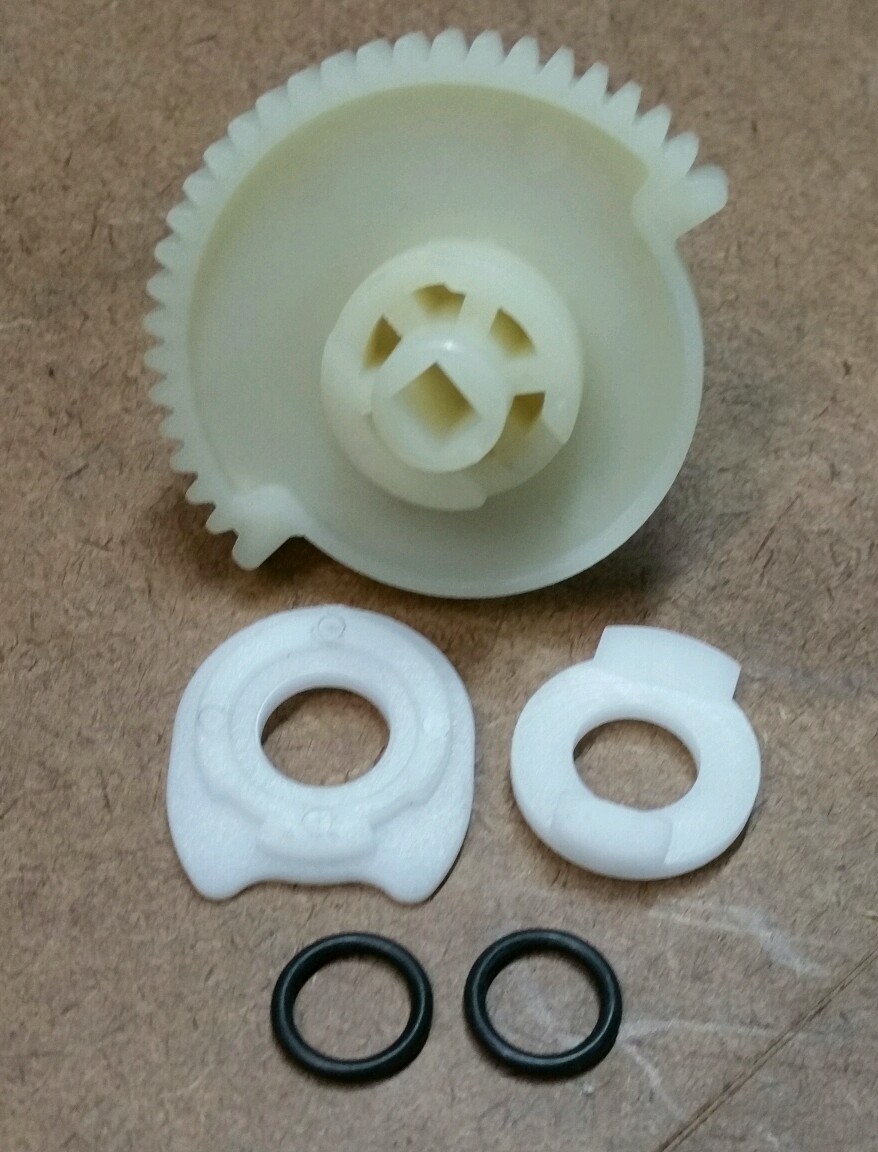

This guy sells a reproduction gear. Products / Services
I have a motor that was "rebuilt" by him. Nice gear, but I wouldn't use his other services.

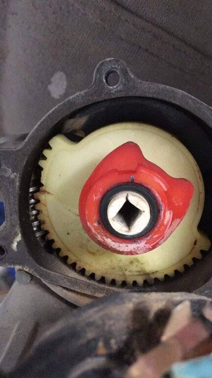

I'm not familiar with the inner workings of this particular headlight motor, but a number of these motors use the same gear/guts as a Ford power window motor. Anybody got a picture of the '68 300 motor to compare the bits?
After I get the new motor. I will open and post a picture of the old motor.
I kind of doubt that. The motor itself (armature, case etc) might use some of the same components, but the mechanism on the head is going to be quite different. Some pictures on this thread, starting at post #1409. It continues off and on for a couple pages.

I do think the Ford window motor shares a lot with the Mopar version. I bought some delrin rollers off Ebay for a Ford that will fit my Mopar.
1969 Imperial progress thread
I have seen that same gear on Ebay new for sale. It is not the same gear as my 68 300 one. My motor works fine the gear is bad and the contacts are poor.
The repop gear is a little different. It's not a full 360° like the original is. The repop is 180°. But it works because it only rotates 90°. I would think that was done to save some tooling cost.
That is assuming that the 68 motor is the same as the 69 and later motor. I'm not 100% certain but I believe it is.
I think the size of the thumbwheel on the end was the only difference through the years.
