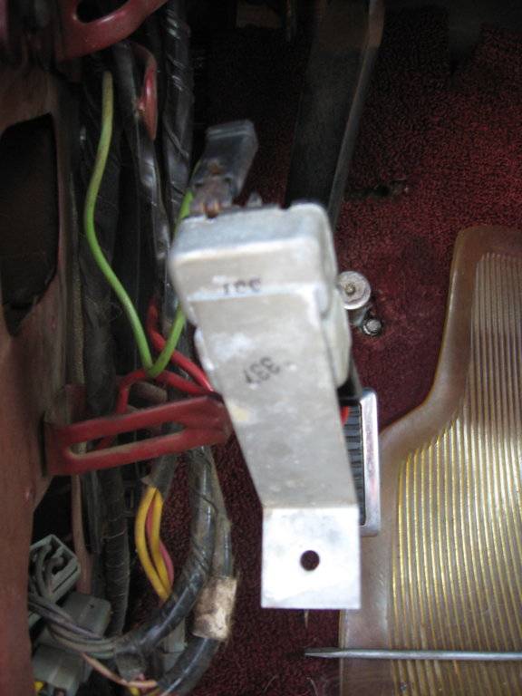

The part I am trying to identify has no part number on it except for 3 numbers 337 cant find any listing in the 67 parts book for it. it has 2 15 amp breakers attached together by the bracket its attached to. here is a picture of it.
That’ll be in your factory service manual. I’m having a brain fart as to what that is at the moment...
If I am not mistaken those might show up in the wiring diagram in the FSM, I believe auxiliary circuit breaker/s. Around the dash area. My ‘68 Polara diagram shows one in the dash harness but nothing connected to it.
They’re behind the a-pillar kick panel.

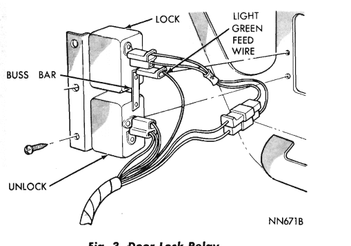

I know from the FSM that its for the power door locks which I am trying to fix , I am trying to find a replacement. I replaced the other one on the passenger side but still no power to the door solenoids. I am following the diagnosis steps from the FSM.
Relay: 2580306
I was reluctant to post the number because it doesn't look much like your picture. Expensive part, I think I'd try generic circuit breakers and find some way to attach to the existing bracket. I think the bracket is the only proprietary part of it.
69 300 vert: the picture you posted is the one that is on the passenger side behind the kick panel. I have a NOS of that one already. I switched it and still no power to the door solenoids. Thanks for the help your list helps me.
Uncle! I give up, I can't find it. I think I'd find a way to attach two universal breakers to the bracket, attach the shunt and call it good.
looked @ Delcity.net they sell automotive circuit breakers . Not sure what I would need to make one to work like the factory setup.
