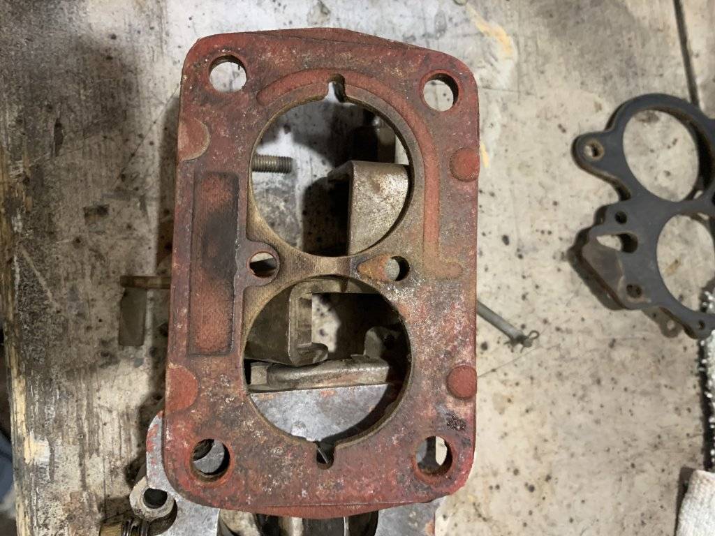

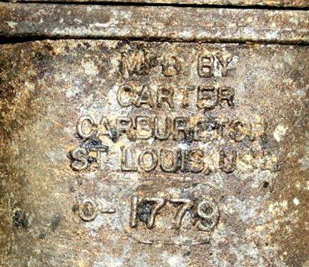

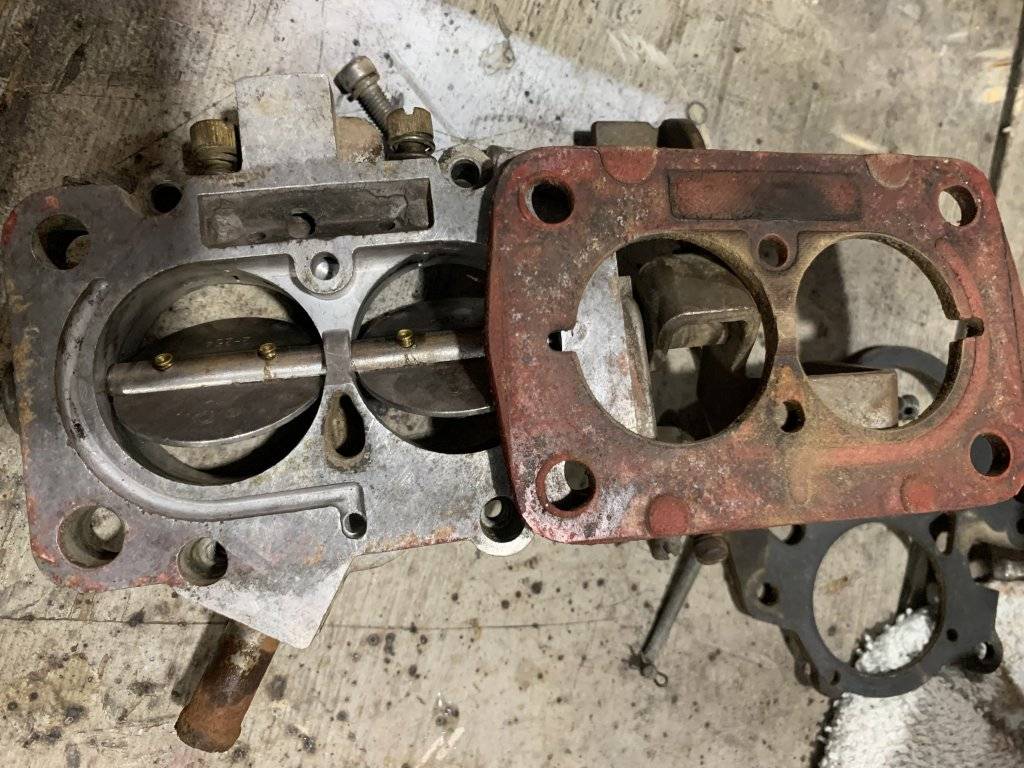

I noticed that my PCV valve had no suction so I pulled the hose from the carb and found the port was completely blocked. I then removed the carb and cleaned the port out however during the inspection I cannot determine where the vacuum comes from. There is no port in the manifold that matches the port on the carb (pics attached). I went to look for a replacement base gasket or carb kit and was using the number located on the fuel bowl which is 1779 and of course it doesn’t correspond with the parts books. At this time I am thinking that the carb has been replaced with a different one which is causing the problem.
Just wondering if this has happened to anyone else. Also does anyone have a reference to the correct part number for the carb.
As a note the number I am referring to is found on the side of the float bowl. I cannot locate any other numbers or tags for reference.

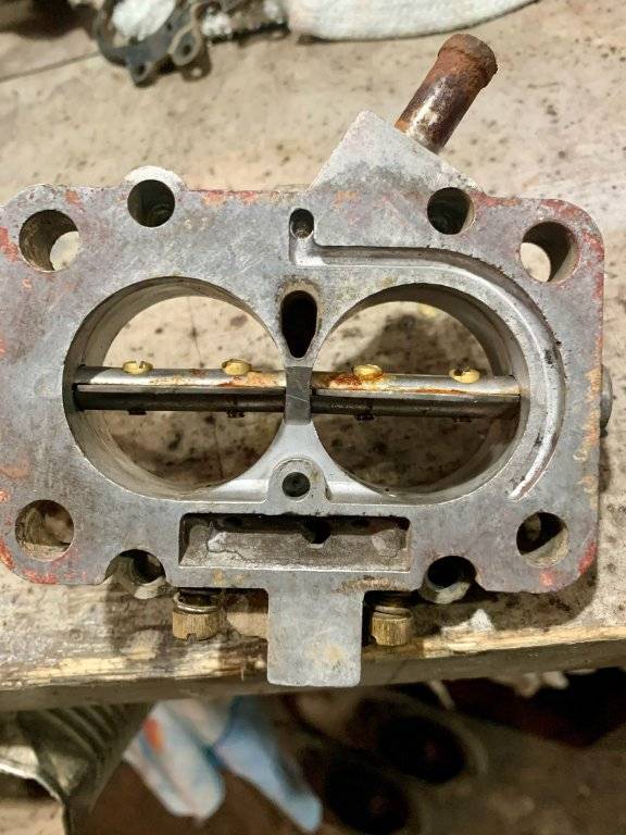

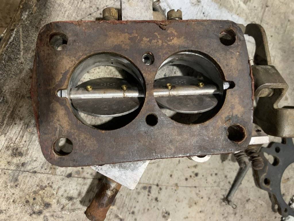

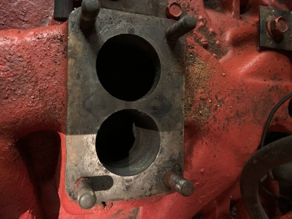

Tried the carb cleaner. The tube is connected to the oblong shaped port. This then matches to the small hole on the base gasket but there is no corresponding opening on the manifold. Kind of stumped. I may just reassemble and try it again.
I am assuming this is the port to the PCV tube? If so I would trim the gasket so it can pick up vacuum from below the throttle plates

Yes it’s a Carter. The only numbers on it are located on the float bowl which is 1779 and they don’t make sense.

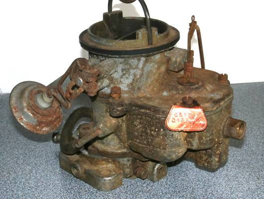

So what you have looks like this:
Well, maybe a little cleaner looking than that. What I did have on my 318 was stamped 1933.

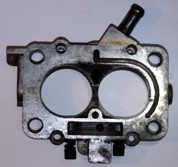

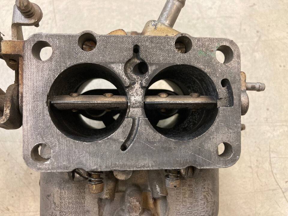

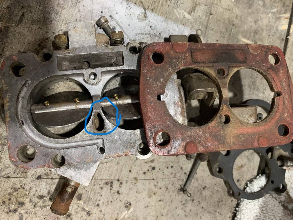

Here is a photo of the carb base. There is an oval or tear-drop hole between the 2 bores, hard to see in this photo.

Good news. I trimmed the base gasket to create a port for vacuum and everything is good now. I have a strong vacuum at the pcv now. Thanks for the help.
