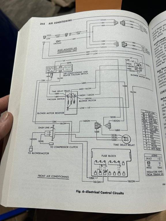

Follow the schematic. This is for a 1968, but I believe that it is the same:

Gents. The vacuum doesn’t do anything but direct the air and set the temperature of the air.
The ac compressor is purely electrical.
Look at the drawings in the FSM as well as the slideshow that I referenced.
It appears that the switch that you both have is not the correct one.

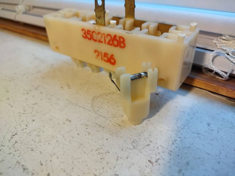

I bought an NOS vacuum switch on eBay, part #3431020...for my '70 Suburban non-ATC wagon. The vacuum part now works great, but the AC compressor and blower motor stay on all the time regardless of what mode button is depressed. I've heard that Chrysler did that on purpose in some later years, but my original switch didn't do that and I don't want that. The part number stamped on the NOS switch is the same number as the original one I replaced though..so I'm not sure whether the new switch is defective or what....Has anyone had this switch fail in this mode?
I know there are a variety of part numbers that these switches supposedly interchange with, but I never see any mention of which ones keep the blower and compressor energized and which ones don't. I could put an external switch in for the compressor, but I really want to keep everything "stock".

had the same vacuum switch. its made to power the compressor in off position. i opened it up and removed the contacts behind the off button. problem solved

I LOVE these self made solution! Didint you mess it up by opening that it wont hold the vacuum anymore ? How did you open and put it back together isn´t it glued or something?
Yes, you will need to open the mode control switch to do this. The enclosure is bonded together (melted plastic studs).
If you look back at my references, you’ll find a link that @Big_John had provided that shows how to split the enclosure and put it back together by tapping holes and with #4 (I believe) screws.

the only solution is to break off the contact from the off switch or just pull the off switch button when your not using the system. pulling the off button will break the contact to the compressor
