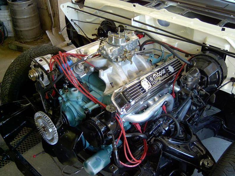

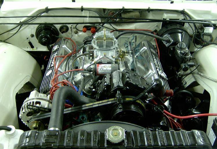

He has a B block, and you have an RB block. Not sure of the bracket dimensions of either, but yours clear. Differences in castings between B/RB intakes?
This one clears because I cut the web on the intake.
