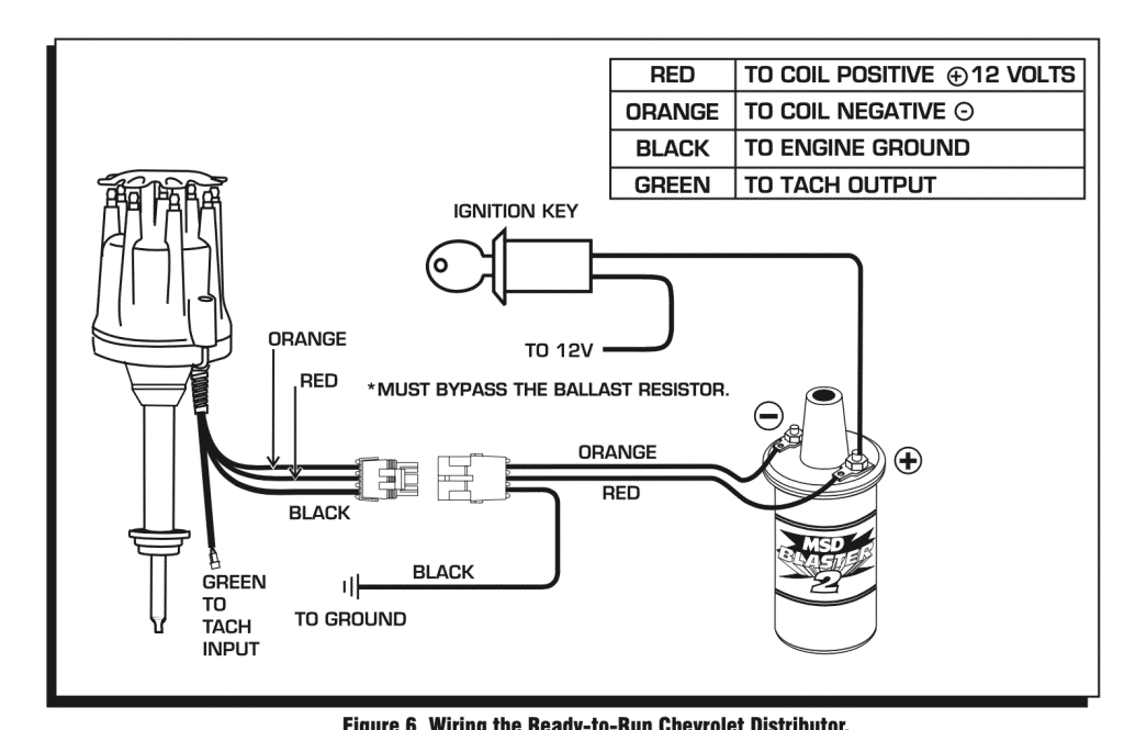

It sounds electrical to me. If you have electronic ignition it could be your ignition module heating up. The biggest cause of that is a poor ground. You can check it with a digital Ohm meter. If you have more than a .5 ohm reading between the CPU case and Neg post on your battery, it is probably causing your problem. What happens when not properly grounded, the current flow will heat up the transistor in the CPU and it will open the circuit until it cools down. Not always the problem but it seems to be very common. It also heats up the coil so it is too hot to touch. That is where I would start.
I'm running an MSD E-Curve electronic distributor (it's an all in one unit, no separate box). I'll double-check the ground. Note that this setup did not change when I changed the the intake manifold and carburetor. But I did send the distributor unit away to be refurbed and maybe I didn't ground it properly when I reconnected everything.

I think I may have found and solved the issue. The wiring/connection from IGN to the coil was chintzy. I think it was heating up and somehow losing its conductivity. I think Sixpactogo was on the right track when he said electrical. I undid the chintzy stuff and put a new connector on and test drove it. Seemed fine. Tomorrow I'll reconnect the brake booster and PCV valve back to the carb and take for a longer test drive.

Ha, that's a good one and apparently describes the issue I was having. Went for and extended test drive today after getting rid of the offending wire and butt connector and no issues so far. Big_John will be happy to know that brake booster is connected and boosting again though still excessively lowering my idle when brake applied. New booster should be here in about two weeks, until then just putting car in N at red lights and easing off the brake.
