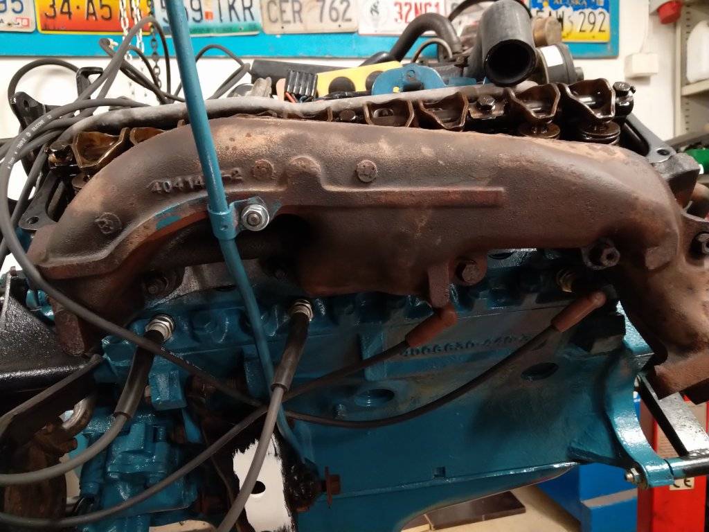

I'm refreshing 78 440 on New Yorker Bourgham and currently installing spark plug wires.

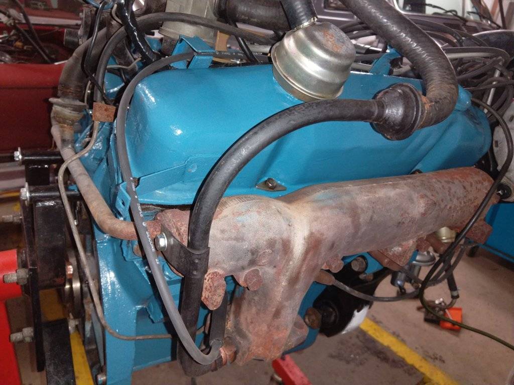

I have Standard brand 7183 set which has 2 wires with almost straight plug end boots (in picture hanging on #1 and #3). Other 6 are 90 degrees. Does anyone have information, where these two belong? Pre-made set has of course wires in different lengths. I haven't found information about which length belongs to which cylinder and I have no existing reference. I'm also thankful on any information on length<->corresponding cyl#.

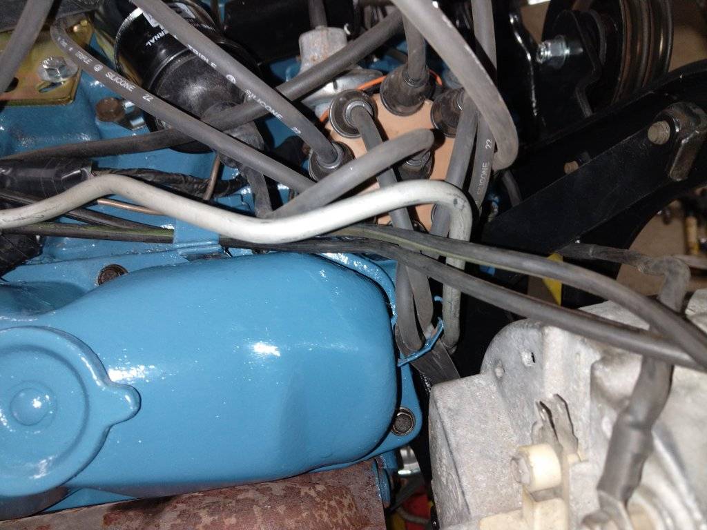

I was also wondering about right bank 2-4-6 wires routing with Lean Burn + 100A + A/C. I found this unrelated picture on 78 FSM, which shows obscure route - wires stuffed through valve cover clip. This is against all principles I have been thought about ignition wire routing, but I believe this since it's The FSM.

the wires with the straight boots run along the top of the valve cover and in behind it before going onto each rear plug #7 and #8 respectively.
An observed issue with many wire sets is that they can consolidate applications under one part number of wires. Which can result in some being a bit longer than normal, in some cases. So seeking to make some work where they were not really designed to fir from the factory. Somewhere in the STD Ignition Catalog are illustrations of each wireset with their individual specs on wire lengths.
A few years earlier, in the Fuselage years and prior C-body cars. #7 and #8 snaked over the valve covers and had straight ends on them to keep them away from the exhaust manifolds back there. By '72, they had gone to a 135 degree boot for the back, as others had used 90 degree boots with those wires coming in from behind the motor rather than otherwise.
No B-body used the 100A alternator, which has the '66-era high mount rather than the lower mount of the normal alternator on your year engine. Although they did have the larger-amp alternators on police vehicles. FWIW
With the lh exhaust manifold you have, which is not that different than some of the B-bpdy manifolds, #7 would have to be a 90 degree end.
Wire routings back then were more about assembly convenience that now. Provided the wires need to cross to prevent induction-crossfiring at some point in their paths. Not necessarily whatr we might like if we were doing it ourselves.
Possibly there is an online illustration of exhaust manifolds for RB/B engines which might equate to your casting number and such, so that other applications might be determined. With the end result of ordering a wireset for that application? Otherwise, if all of the other wire lengths fit, you can gently slide the existing plug boots up on the wire, remove the crimped-on terminals then replace the straight boots with what you need to fix the replacement?

I answer to myself after more research: #3 and #8
This case is resolved.
Dealership data book shows small picture of the engine showing microscopic detail of left bank routing. #3 has 135deg boot avoiding the dipstick tube.

#8 goes nicely through single bracket (plastic grommet missing) and between downstream air injection tube and manifold. 90deg cannot be used here.
