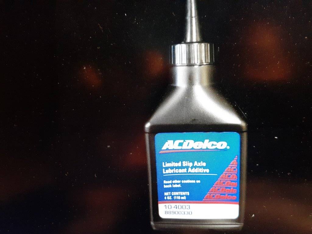

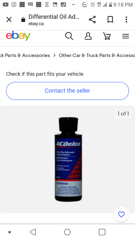

Here is what I use..
ok i will have an extra one on the shelve then.
No problem!
It is a good idea to jack the rear up and run it in gear at idle for 10 minutes to circulate the conditioner.
It is not really necessary just a recommendation if you were experiencing any chattering.
