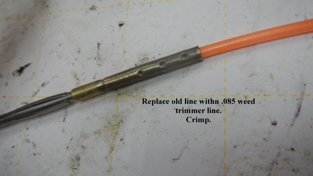

I'm also rebuilding the power antenna of my 72 Imperial because the nylon cord is broken.
Because I cannot find the original/NOS nylon cord anywhere I was very hopeful when I saw this tread, using weed wacker line looked like a pretty good alternative.
I tried .085 and .130 weed wacker lines, both not working correctly, the nylon cord always jams (don't know if that's the correct word).
Is there anyone who can help me with this please?
What's the correct thickness of weed wacker line I should use? Can you give me a brand I should purchase? Is there another solution to replace the nylon cord with?

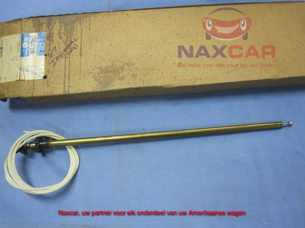

I found a 67 mast. Would this fit into my 72 power antenna?
Thank you,
Patrick Slegers
Braambessenstraat 46 | 2400 Mol | Belgium
slegers.patrick@telenet.be | +32478235996

I think I might have found an alternative, please give me your thoughts.
Yesterday I visited several home depot stores and checked different weed wacker lines. For none of the trimmer lines they could assure me they were nylon, we think they are all plastic.

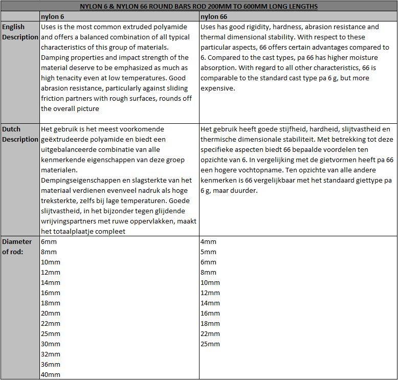

Via ebay I found these nylon round bars rods. What do you think, would this be a good alternative for the original nylon cord? What would you choose, Nylon 6 or Nylon 66? And what would be the best diameter to use?
NYLON 6 & NYLON 66 ROUND BARS ROD IN NATURAL & BLACK 200MM TO 600MM LONG LENGTHS | eBay
I also found this 67 mast. Strange thing though, the seller says Mopar part # 2771994 is not available anymore but he has this 67 mast for sale. When I check part # 2771994 I see this is for a 67-73 C-body.
What would you recommend?

I think that the word "nylon" might be tripping you up. The word is often used generically for plastics of all types, especially for flexible plastics.
IMHO, the nylon shown on the eBay add is probably going to be too rigid for your use.
I'm afraid it might be trail and error to find the right line, but I would say that you have to stay around the same diameter and the shape is going to be important. Much of string trimmer line I've seen has been extruded into a more aggressive shape to cut grass and weeds better.
If you think about it, the line has to push, pull and not bind against itself. It has to be strong enough to pull the antenna back in and push it back out. At the same time, it has to be flexible enough to wind around a ~2" diameter spool.
I would revisit the string trimmer line. I would be sure it's round and near the size needed. Possibly a little smaller. I would also measure the piece of line being used with a micrometer every inch or so. Remember, this stuff is manufactured to cut grass. Inconsistencies in diameter might not bother a string trimmer, but it may not pull through the antenna correctly or jam if it's a little "fat" for a couple inches. In other words, don't just grab a length, be selective and inspect it before assembling it.
