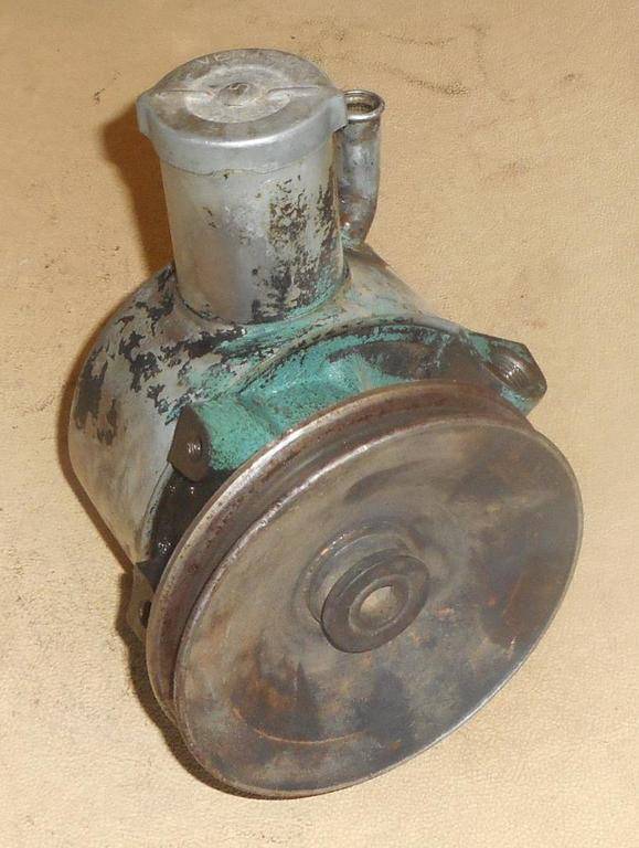

Putting my 67 383 Fury back together and I have a TRW power steering pump with a round looking bolt holding the pulley on. Does anyone know where I can get a reman or a link? Having a hell of a time finding any info.
Need more information. Are you looking for a re-man power steering pump or just the nut that holds the pulley? Pic's of what you need are always helpful.
Isnt the pull pressed on? I don't exactly understand what you're asking. Are you looking to replace the whole pump?
The pulley is a press-on type.
You need specifically a PS Pulley Puller.
In the center of that round looking "bolt" is a hole.
The puller utilizes that hole.
