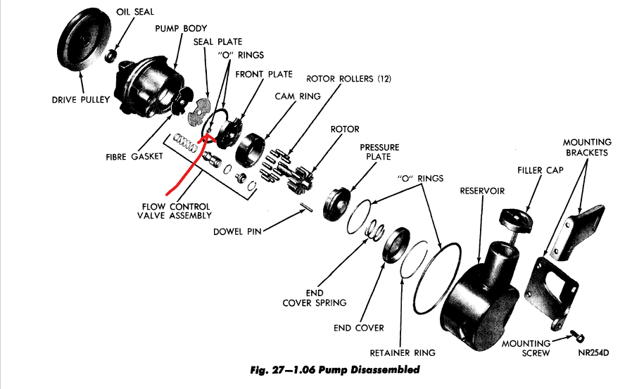

Among other things, my power steering pump is leaking badly. I replaced the large O ring on the reservoir, hoping that would be enough, but unfortunately the shaft seal is shot as well. I'm stumped as to how to change it, the FSM mentions several specialist tools but I think those are hard to come by. Also, it says not to just press the seal and pulley in place as this will result in serious damage to the pump. Can this be done without the tools mentioned in the FSM? Anyone got some tips or tricks for me?
It's a federal (1.06) pump.
Thanks in advance!

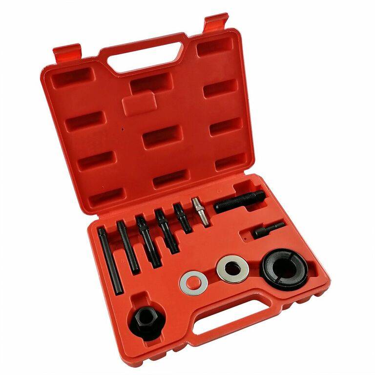

You usually need one of these universal pulley installer/remover tools to service the power steering pump. The exception would be the pumps that use a nut to retain the pulley.
Pulley Puller and Installer Power Steering Pump Remover Alternator - 13PC Kit 19 | eBay

Couldn't find one of those power steering pulley remover/installer locally unfortunately so had to order one online. Was a little hesitant but since it would probably be a single use for me I just got a cheap one from Amazon, even though there were several negative reviews. How bad could it be. Finally arrived this morning. Last couple of days I had been soaking the pulley in some penetrating oil. Wasn't feeling really confident with first assembly of the tool so decided to apply some heat as well. After a few cranks it scared the crap out of me when it let out a loud snapping sound, what did I break? All the threads were still okay so tried it again. Kept making the sound every turn and it took me a while to realize it was just the pulley slipping on the shaft. All is good, pulley seperated and leak definitely found the leak. Not only did the rubber completely separate from the seal housing, it was petrified and crumbled in my hands. Just need to remove old seal housing, install new seal, flush system and I'm good to go.

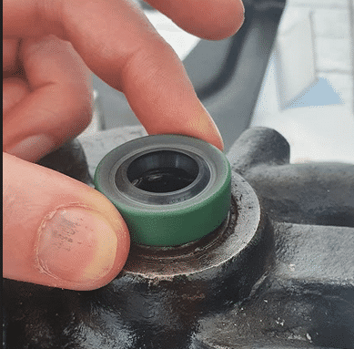

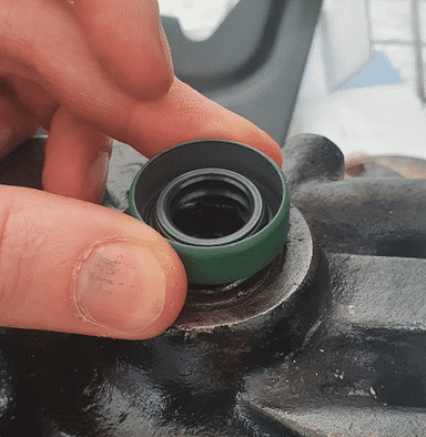

Just to be sure, which way do I install the new seal?
The one on the left, correct?

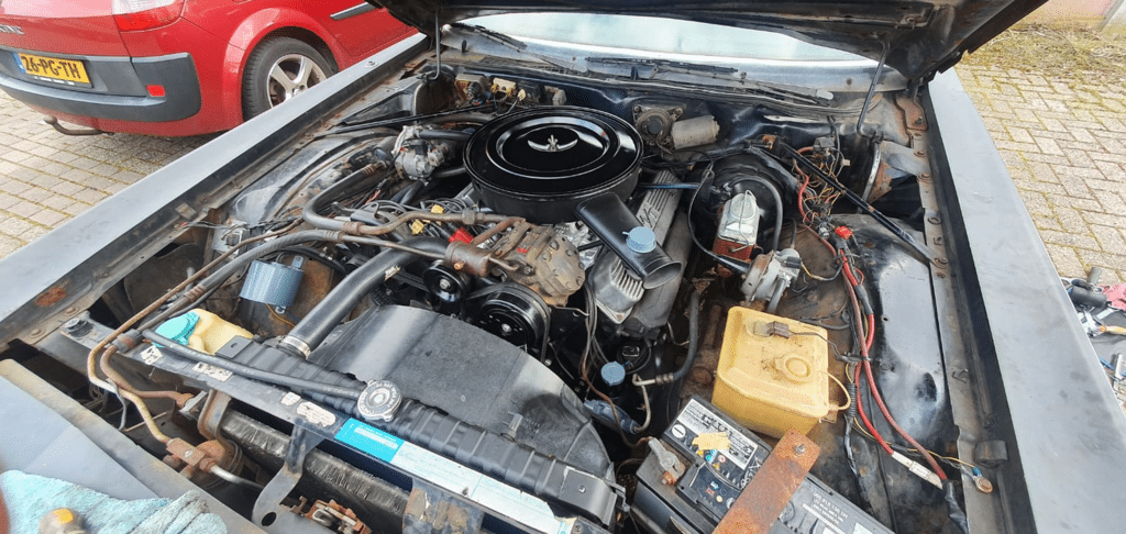

Replacing al the seals in this power steering pump has been an absolute PITA, but it is finally back together again. This had better work perfectly now and not spill a drop as I really don't want to go through that again.
Wanted to share my progress with you guys. There is still plenty to do, but for the first time in months she can move on her own again. I couldn't be happier, what a way to start the week.
View attachment 452935View attachment 452936
My guess would be the photo on the left but I would install it in the same orientation as the previous seal.
One can buy a power steering pump seal replacement tool set from any Autozone Store. They are universal.
