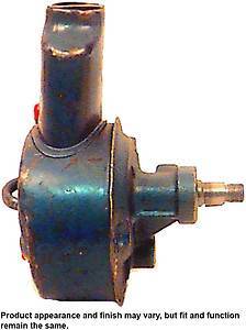

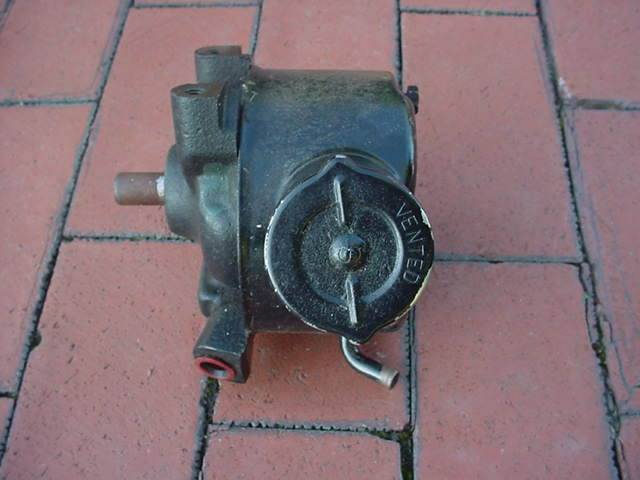

Here's pics of the federal, and the Saginaw. I don't have any pics of the Thompson.
Best way I can describe is Saginaw has a tall neck that is kinda oval and return line loops in from side to back pressure fitting sticks straight out the back, bolts onto bracket from front behind pulley. Federal has pressure and return on side and bolts from side, Thompson almost same but pulley non removable
I've found that most 440's used the Federal pump.... High pressure hose connects to the top front..... and to the lower rear on a saginaw.

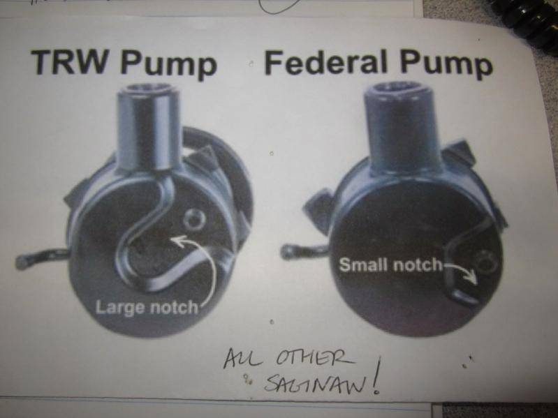

heres a quick pics showing the difference between TRW and Federal.The saginaw has a taller filler neck which is oval shaped and no indentations on the backside like the others.IMG_1323.jpg

I can help you ID them Jer. BTW, the early Saginaw uses the same pressure hose fitting as the Federal and TRW. The later Saginaw uses an o-ring.
