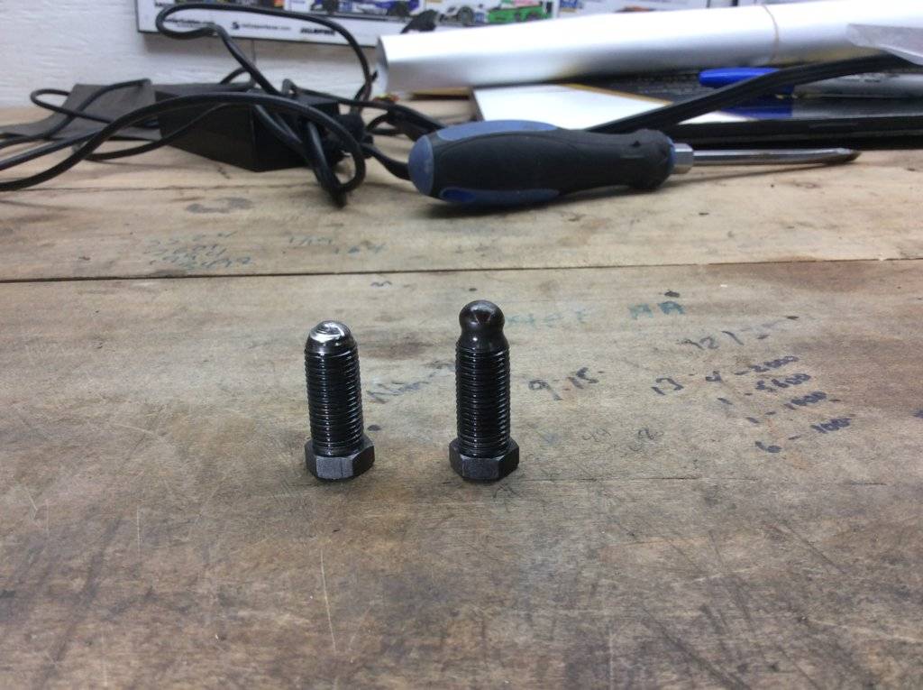

PROBLEM SOLVED. sort of.
Turns out it was the rocker arm adjustment screws getting all tore up for whatever reason.
They were originals and looked fine going back in. Everything else looks new so these took the brunt of some wear for some reason. Not all of them maybe 8 of 16 as I wiggle them around.

Those are just flat worn out, probably from an oiling problem before the engine was rebuilt. You should check the push rods for abnormal wear also. You can still buy the 318 poly complete rockers on ebay for about $160 a set. The other and cheaper alternative would be to find someone with a junk 318 that would be willing to sell you the rocker set. As far as I know, the adjusters themselves are not available.

they pushrods have been inspected and they are still looking like new. No wear in spite of what some of the adjusters look like.
The adjusters in there are one piece. Some on eBay are one piece, some are two piece. Both claim to be for ‘60 318’s. I think I have tripped across the two piece adjusters on the web.
Is it possible there is a second version that is avail or should I stick with trying to find one-piece adjusters?

I would stay with whatever you have now as the push rods are probably not the same. There was an early and a late style but I no longer remember for sure what years are the same. I think the 55-59 was the early style and the 60-66 was the late style. A member here would probably willing to make you a deal on a rocker set, or maybe just the adjusters, if you ask as there are lots of junk poly engines around.
