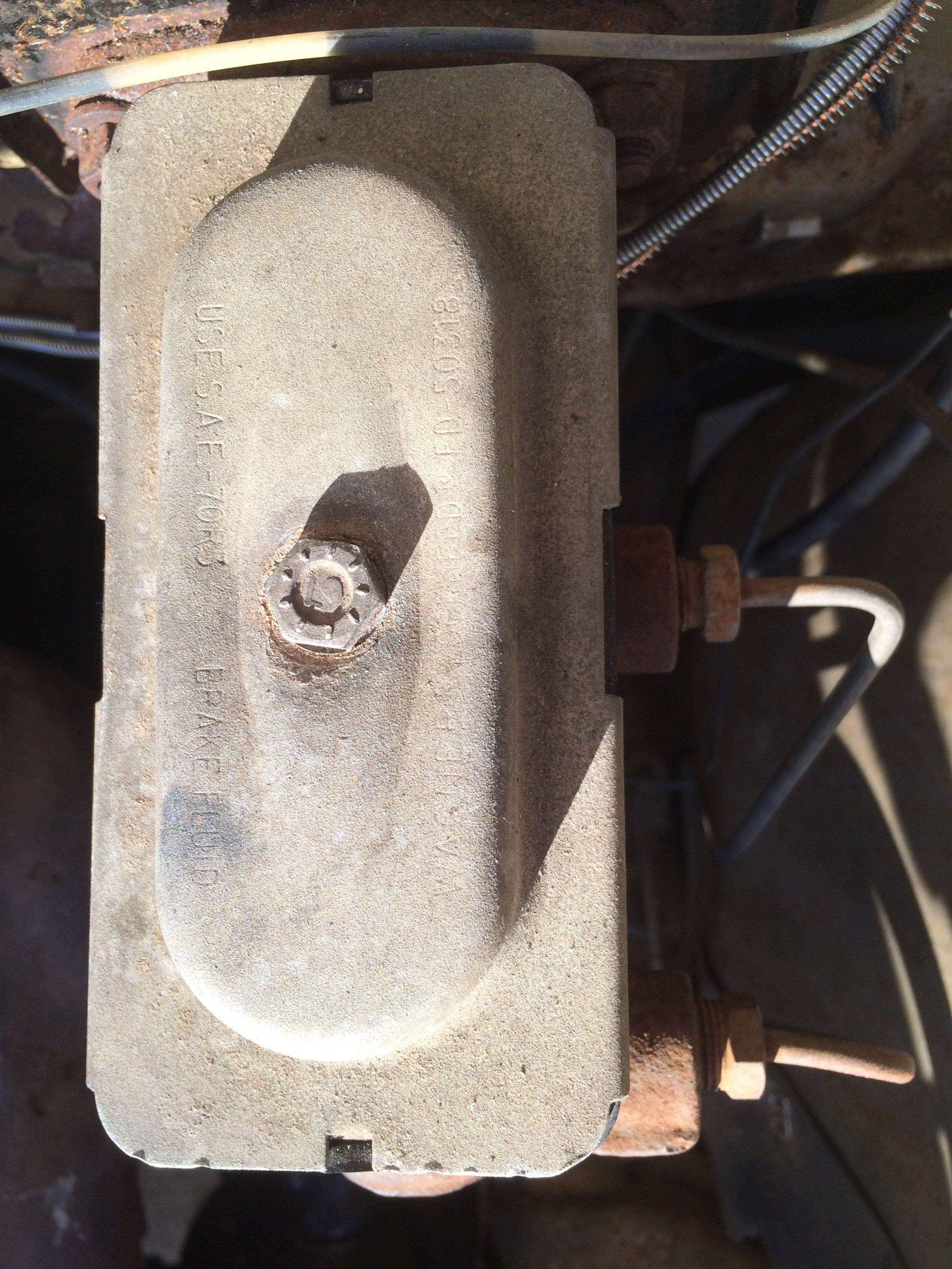

looks like no boosty there now..
was it always a dual system, or did it have a single pot on there before?

It's a 1968 Fury. That's the original dual system that was on it when I bought the car, manual drums all around. I had disc brakes put on up front - the guy at the shop mentioned a proportioning valve, but I had no idea about the MC swap.
The disc brake caliper pistons need a lot more fluid than drum brakes do... the master will have a big reservoir for the front circuit. Without it you could run out of fluid as the pads wear. It may be a different diameter piston, which is much more important. The prop valve for discs will include a hold off valve and may be balanced differently. Your guy should have done the job completely, which makes me question his knowledge and ethics... but I don't know the guy, and I'm not there to find out. If a similar car could donate it's pedal and loaded booster, you would at least have build cores and a correct pedal.
