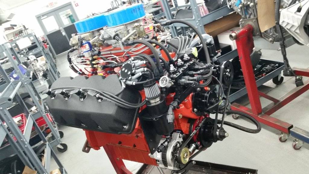

My new engine for my Fury to be installed next month has aluminum heads ,intake ,water pump and housing on it to replace the all cast iron 440 in the car now. I am guessing it will be 80 to 90 pounds lighter than my present engine. Will I notice a handling improvement? I really don't know. I have my doubts.

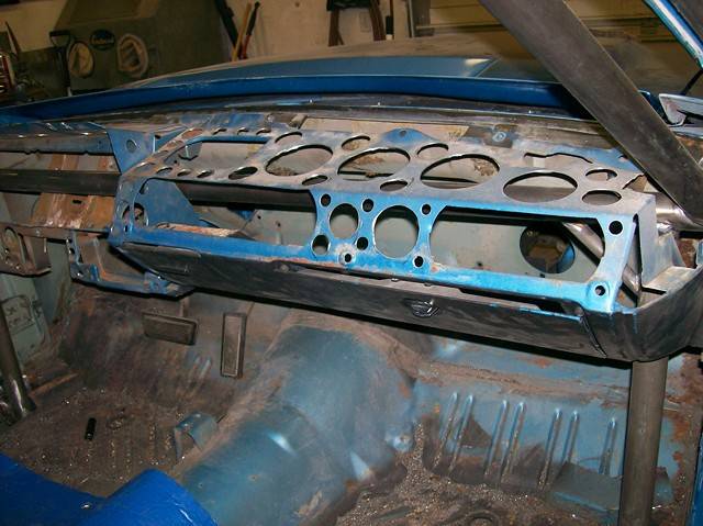

I hole sawed everywhere I could in my E body Challenger that wouldn't be seen, added light weight aluminum and carbon fiber wherever I could. Alum, heads, intake, water pump and housing, radiator, seats, etc. However, adding the weight of the chromoly cage and Mega Block put weight back on. Still an all glass window, steel car it is no lightweight at 3760 with me in it.
