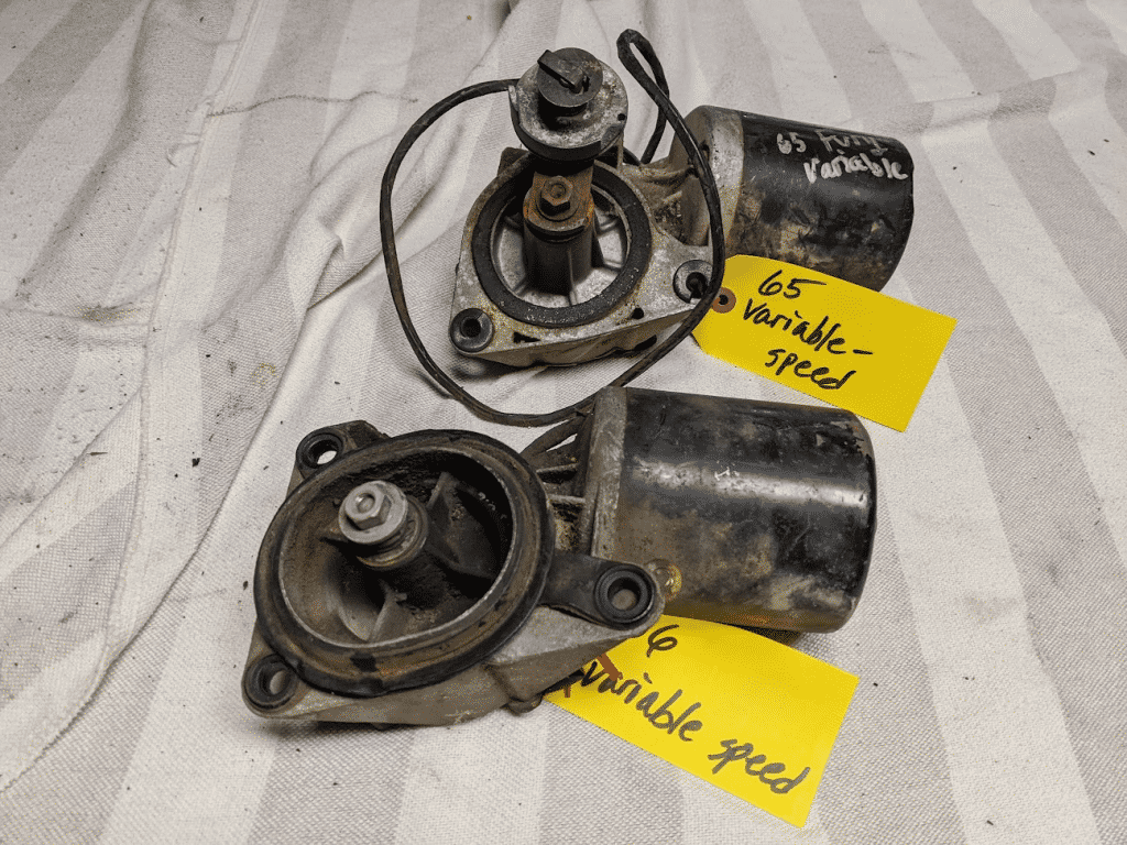

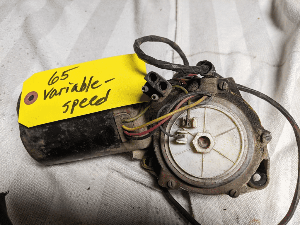

I did a little digging, from motors I have on the shelf, and some googling.
Things to note from all the pics below:
65 and 66-newer have different mounting pattern and hole thru the firewall. This is yet another difference between 65 and 66 C-bodies. Whooda thunk the firewall stamping would be different for that???
My 66 motor has no connector, so cannot compare it to the NOS one. My 66 is variable-speed, the NOS is 2/3-speed. Connectors may or may not differ?
If the connector differs, then it dictates a different underhood harness part#. Between AC, idiot lights vs gauges, SB vs BB - there could be a whole matrix of underhood harness part#s, and wipers would complicate it further.
My 68 Fury has 2-speed wipers and the motor looks like this style, with the motor can protruding forward. (this is a google pic)

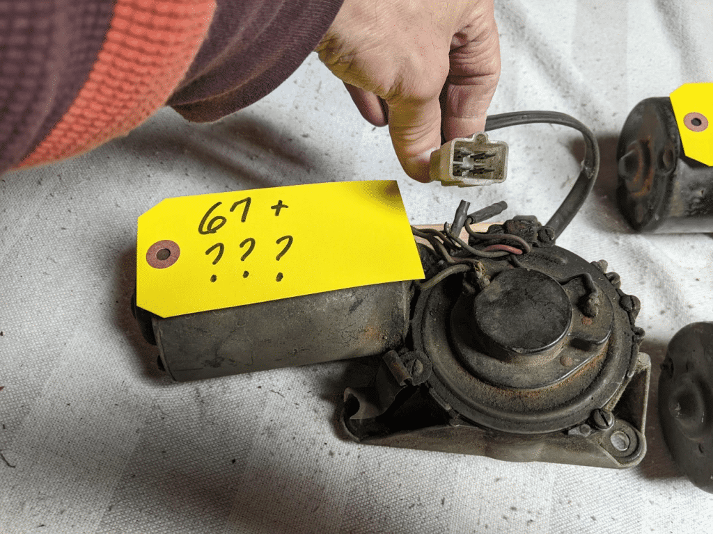

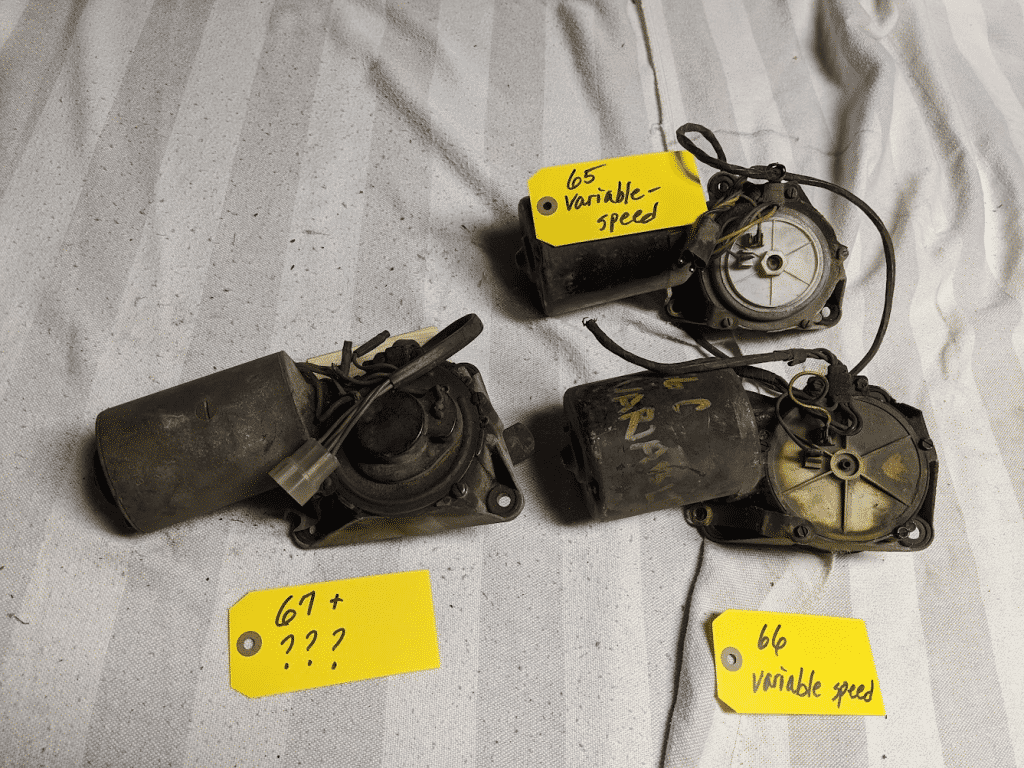

Here is a pic of 65-66 variable-speed motors and a 3rd one, I have no idea where I got it. (my photos)

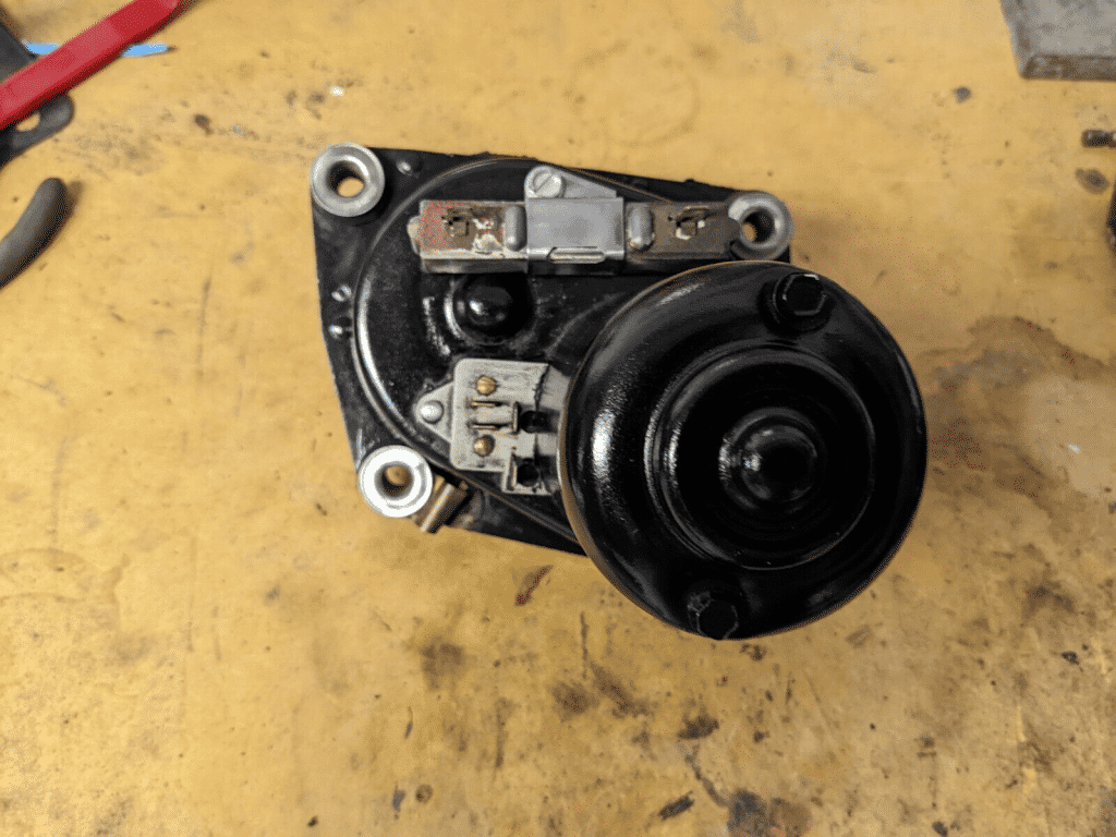

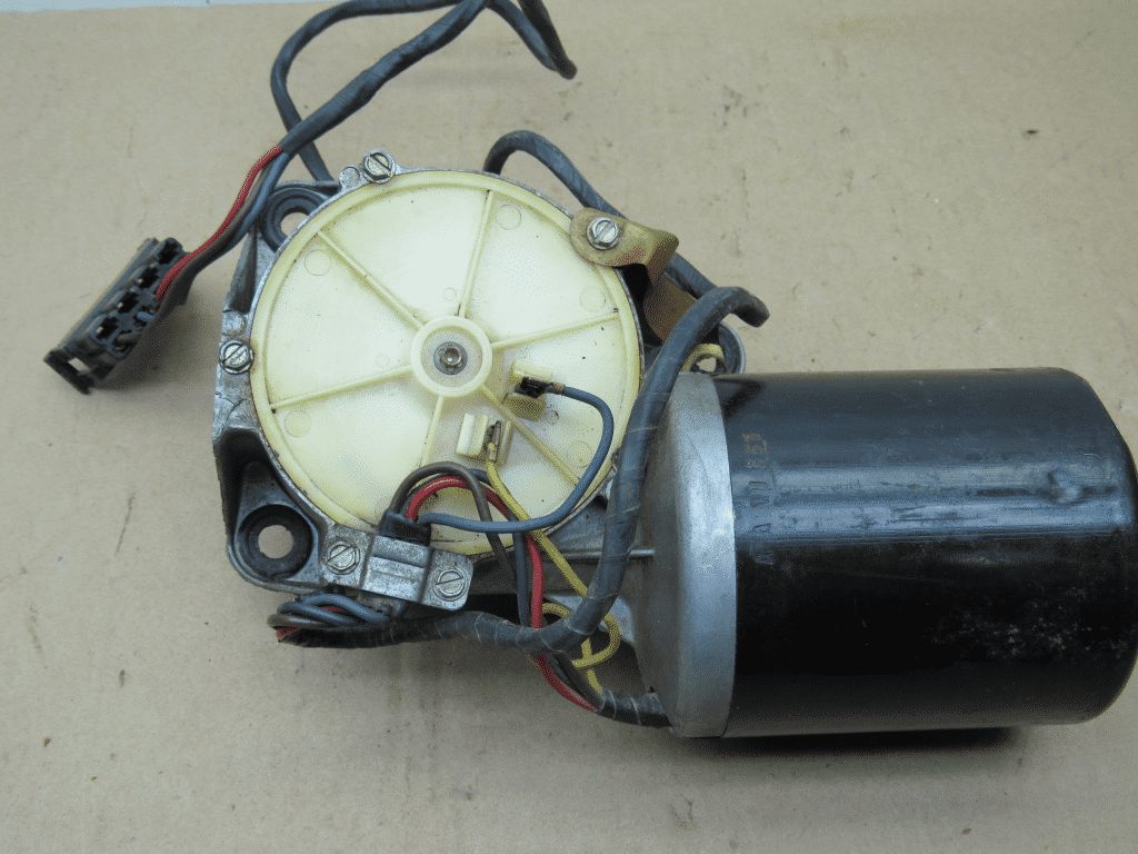

Here is another one:
Wiper Motor# 2586988 - 2 / 3 Speed - C - Body - 1966-67 - NOS - Blue Star Performance
Wiper Motor# 2586988 – 2 / 3 Speed – C – Body – 1966-67 – NOS
Fits 1966-67 C body;1966-67 Dodge Polara, 500, Monaco, 500, Plymouth Fury I, II, III, Sport Fury, VIP, Chrysler Newport, 300, New Yorker, 1967 Chrysler Newport, 300, New Yorker, Imperial models. Can be used with either 2 or 3 speed wiper systems on Dodge and Plymouth models,3 speed on Chrysler applications. This is a complete wiper motor assembly,aluminum housing,with black metal motor. It has a 4 wire harness,with brown,blue,red,and green wires,includes the black plastic connector. Motor has stamping date of 36th week 1965. Supersedes to part# 3004112. 23-67-98.

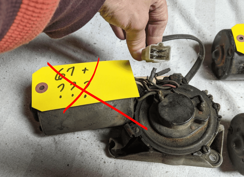

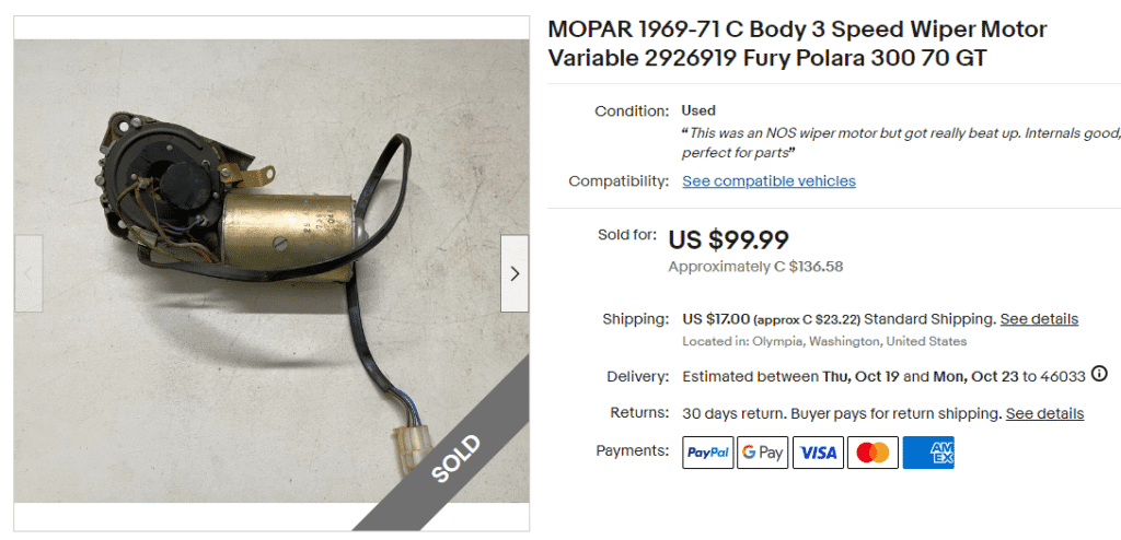

Based on this pic below, my 3rd one looks like a 3-speed motor. (motor below is noted to be damaged to the wiring cap)
Although the wiring harness on mine is notably shorter. I dunno, perhaps mine is a 68?

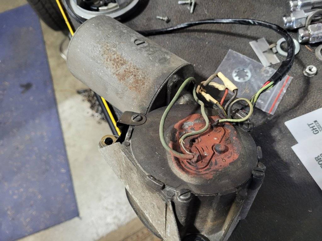

This is the spare motor I have, it's the same I have on my '67 Monaco:
Some-what "ugly" way they've connected the wires to the motor. The service manual says the 3-speed switch is optional, all cars have 2-speed standard. The "medium" speed is apparently the 3'rd speed that is optional. The motor probably can do 3 speeds, getting the right switch can do it, but maybe it was never offered on Monaco/Polara ?

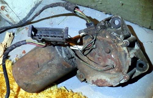

Jumping in a little late here because I just had the (what I think is) variable speed wiper motor from my '66 Fury VIP take a crap.
Mostly I'm jumping in to add the picture that might help someone in the future.
