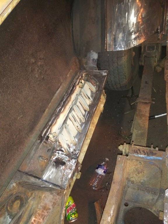

I used 73 chrysler extensions in my 71. Had to get creative to make them work. But they are in and when all the finish work is complete, it will be hard to tell the difference. And if you can tell the difference you spent to long looking at my trunk and I am gonna shut it. Ha.

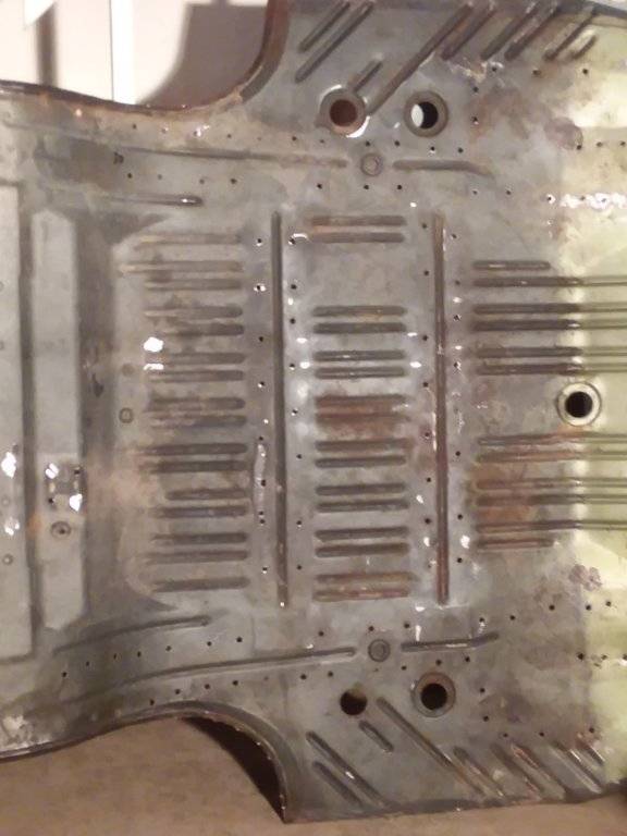

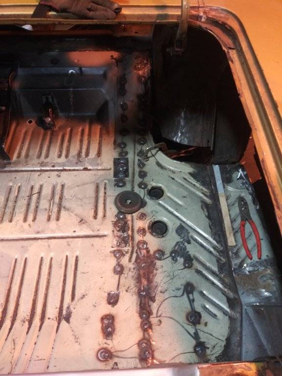

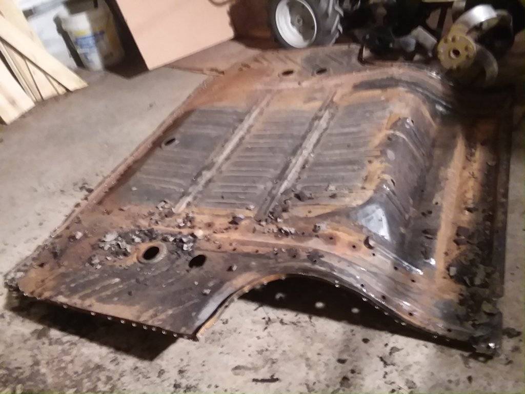

I posted pics awhile back...I removed a clean pan out of a 72 c body supplied by Murray Park....
Very nice. Done that many times myself.

Trunk floors are very time consuming to properly cut out. That does ad to the price. And they are no fun to do either. $500 sounds like a lot but after spending the better part of a day cutting it out and preparing it for shipping it's not a real moneymaker.
Ya im finding thst out this is kicking my butt broke 4 spot bits
