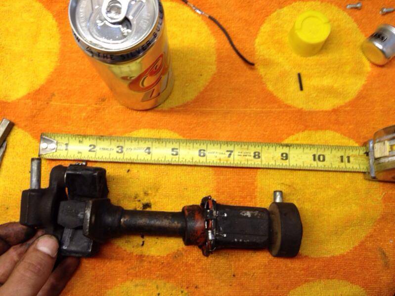

Well here it is taken out. The length from spline to spline is 9". Am I measuring this correctly? Yes the rag joint is broken so it's just a kind of rough measurement. Sorry for the bad photo

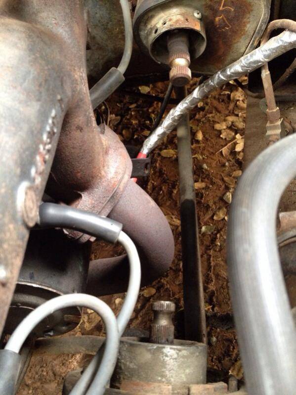

Another pic to show what I'm working with, in the car. Top is the column spline and the bottom is the steering box. Power steering btw.

Do they make some sort of extension that reaches from the steering box shaft to the steering column that will allow a u joint to be used? This is all Chinese to me. Looking forward to learning about all this

So to make this thread gold, spline count and shaft diameter for the shafts. Then anyone can order 2 joints and a length of shaft for replacement parts without having to disassemble first.
Column- 3/4"x36
Box-5/8"x36
They look like they have just what I need. 2 u joints and a length of shaft that you can cut to fit. Ask and you shall recieve. This forum is awesome. Thanks for the help guys!!!
