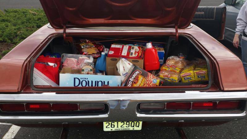

So we had her out Sunday...... forget the boring tired old joke about the six dead bodies....That's two full ,overflowing shopping carts from the Sams club in there

It would have to be degraded grease or maybe rust/pitting contamination from sitting. I can't seen rollers flattening or races getting notches in them from sitting. You would think that some springtime potholes with the 6 bodies in the trunk would impact the bearing more than sitting still.
