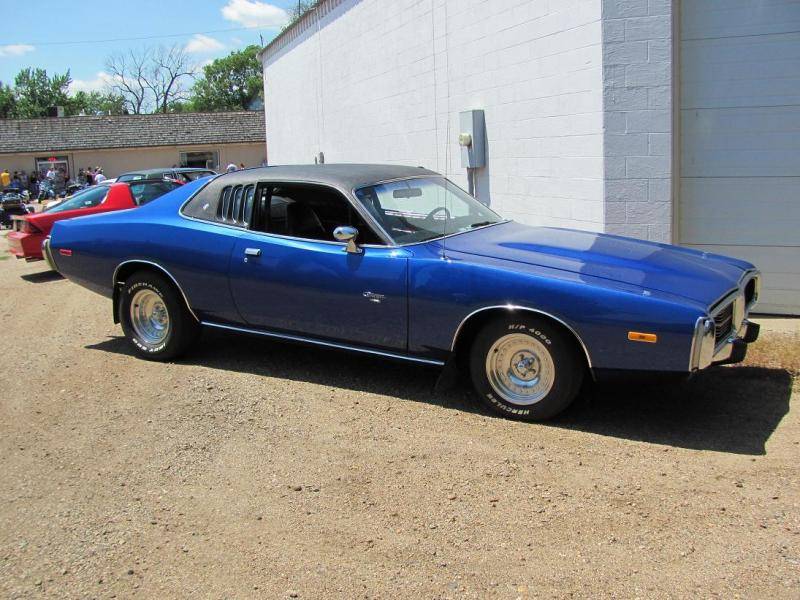

The 8 3/4 rear in this car was a bolt in swap from a '68? (so I was told) C-body, so I think it may be worth your time to get a tape and do some checking...
