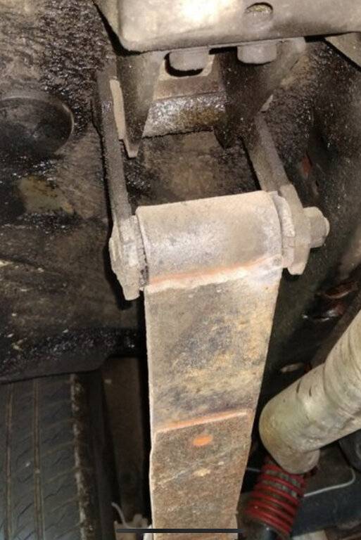

So does anybody know if they made rear leaf spring shackles in a longer length?
LoL the 1970’s are calling. That was the way a lot of my buddies jacked up their cars back in the day. Air shocks and big ol shackles. I don’t know where you’d find those now. A shop like Dunbar spring in Arizona might know. I last went there in ‘90 or so for 8&3/4 U bolts - they know what they’re doing, been around for ages. Old school.
I’m assuming this is for a nonstock modification. No idea what the factory did as far as tow options,cop cars, taxis etc.
dunbarspring.com
The FEW Mopars I saw locally that put long shackles on the back did NOT make much difference in the ride height, by themselves. Which is where the air shocks came in.
As the Chrysler leaf springs are assymetrically mounted, shorter section to the front, longer section to the rear, those longer shackles, by themselves only served to put more reverse arch in the main leaf of the spring, with not a lot of rise in the rear for the work involved. By comparison, other GM and Ford vehicles with more centered rear axle mounting on the leaf springs DID get more rise with just the longer shackles.
The reason, if I might inquire, as to the perceived need for the longer shackles?

I would like to raise it about 2 inches.
I have air shocks on it now and hate the ride.
I loved the stock style shocks and ride, bounce and all.
I read some of the threads here about re-arching
and then flattening our not long after.
Not a lot of people happy with the new one available.
Thanks for the information.
From my experiences, the air shocks, even with 60psi in them to compensate for sagged rear springs on my '70 Monaco, did not affect the ride as most of the air shocks had the larger pistons of the factory HD shocks anyway. But with more pressure, things might get a little stiffer, BUT still should not really adversely affect the ride per se. Except that the "rise" might well make the front end's effective caster way out of whack, which might affect highway stability, possibly.
If your desires might revolve around larger rear tires, that extra bit of rubber might look good, but in reality, might not be worth the added expense to make them happen, I suspect. Plus any added stresses their possibly greater traction (upon acceleration) would pout on the driveshaft assy. As in u-joints which might be close to needing replacement anyway. But that's just me AND some might have other orientations.
To me, Chrysler vehicles, or any vehicle for that matter, is best at factory ride height, or possibly 1" either way. This way, there's still enough wheel travel to handle bumps/dips and not cause other issues. Even at factory ride height, the factory dual pipes on the Monaco could drag going into some places, so extra care was necessary in doing the approach to those places. Chrysler C-bodies tend to have longer rear overhangs than other vehicles do, by observation.
ONE other thing about the longer shackles, seems like on the Chrysler versions, they needed a bolt-in-tube about middle way down, for added strength for side/cornering loads, to keep things parallel in these situations?
