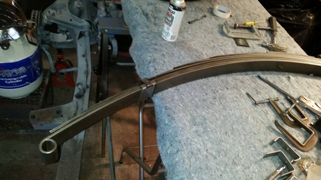

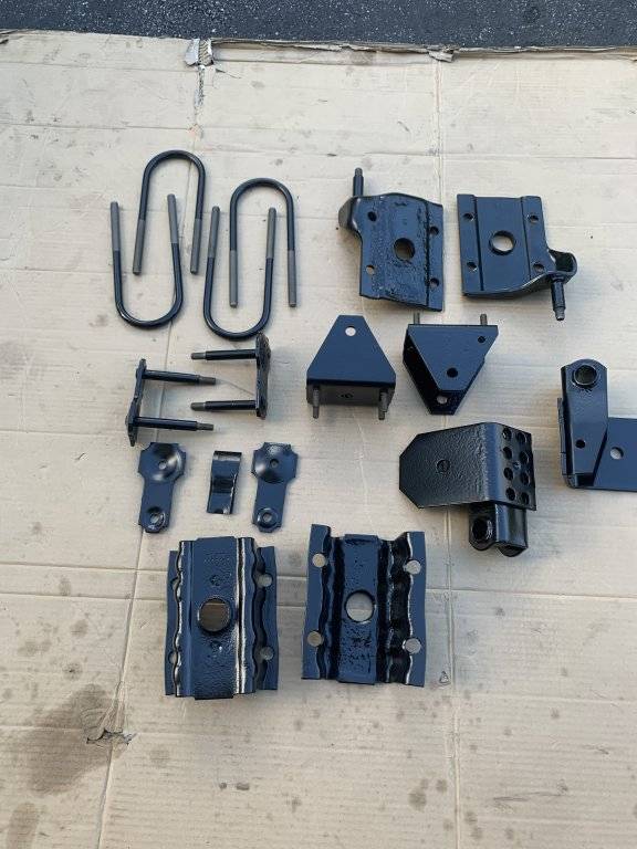

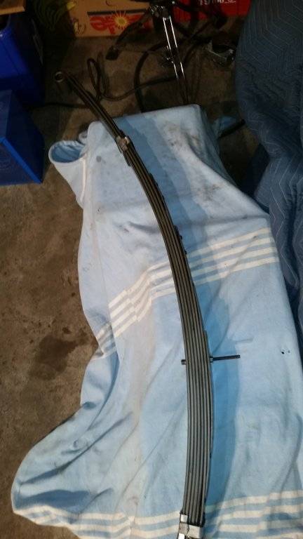

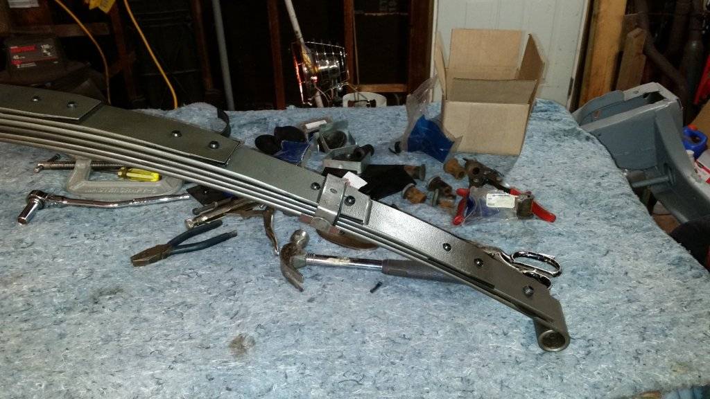

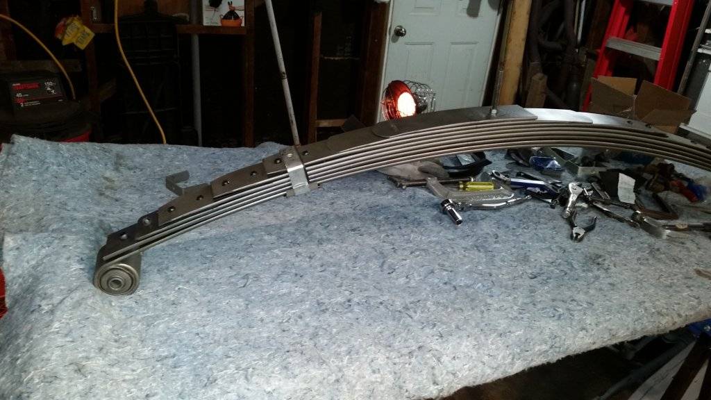

I did mine - took them off, and disassembled them. Replaced the worn out bushings with new (pressed in by my local shop) and the plastic slider parts, took the leaves over to a spring shop and had them re-arch them and provide me with a new leaf. I cleaned them up, reassembled with graphite lube rather than the zinc plates (as recommended by all the spring shops), using new spring clamps, and they sit bagged and tagged ready for installation. If it sits too high, I'll remove the extra leaf.

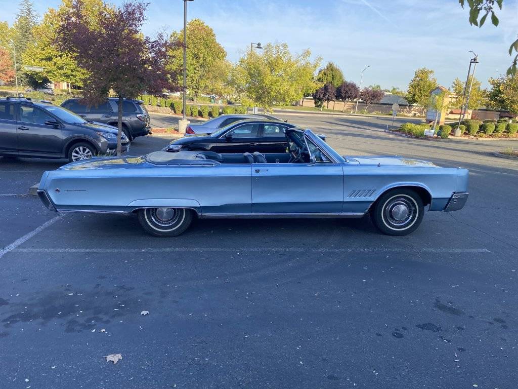

I agree, the rear looks pretty much stock, from the way the lower line of the rocker panel crosses (if extended rearward) the center of the wheel cover. The front, on the other hand, is a bit too high. What you want, for OEM ride height, is that lower rocker panel line, when extended. to cross the center of the wheel cover at the SAME place. Not too low, not too high, but just right.
Just because they are "old" does not mean they are sagged or weak. Would be a shame, to me, to spend the time and money to change the rear springs and the new ones not make any difference in how the car looks when done.
In ANY ride height change on one end of the car, remember to tweak the headlight adjustment accordingly.
"Measurements"? If you follow the directions in the FSM, it can get to be a bit complicated to do it right. By observation, the lower flat part of the lower control arm should be approximately level with the ground, horizontally, at close to the factory ride height. When done adjusting, a final check can be to see how many fingers you can get between the lower control arm bumper and their contact point, on each side, both the same.

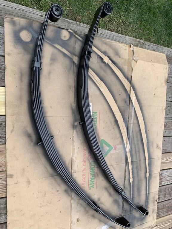

It's absurdly easy and well worth doing. Go to Springs n Things. Spring and Suspension Specialists | ESPO Springs n Things You can order them with a little extra height, or less too. I ordered a new set for our '66, then swapped those into the '68 we got as a replacement when it got totaled. Being both slab sides, it fit nicely, and improved the ride immeasurably. I counted leaves in the old '68 set, and some pissant removed a leaf for the "low rider" effect. My OLD '66 springs are much better than the junk that was on the '68. I had ESPO give me an extra couple inches altitutde to better roll over the cratered trails in these barrios.

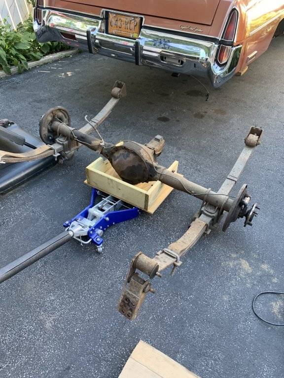

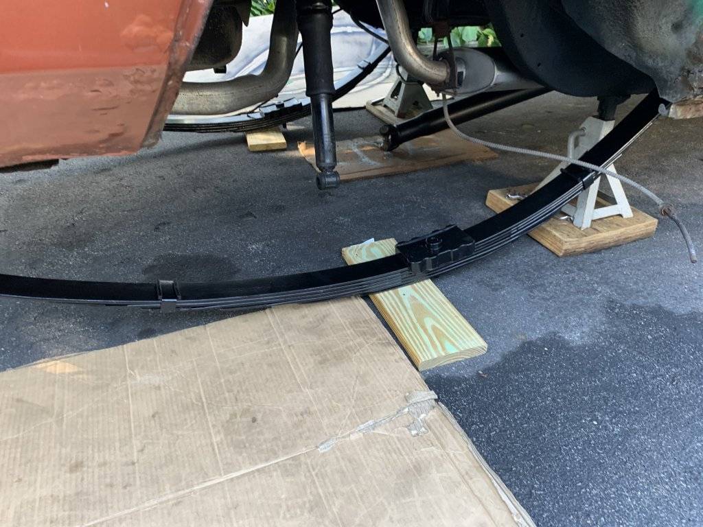

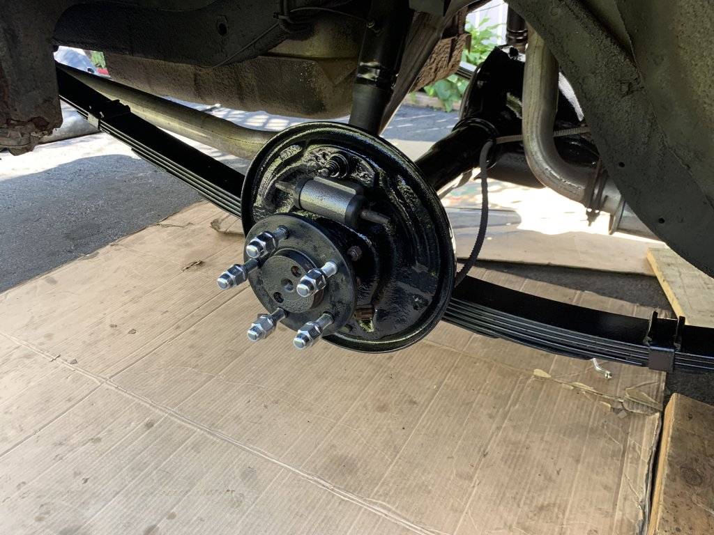

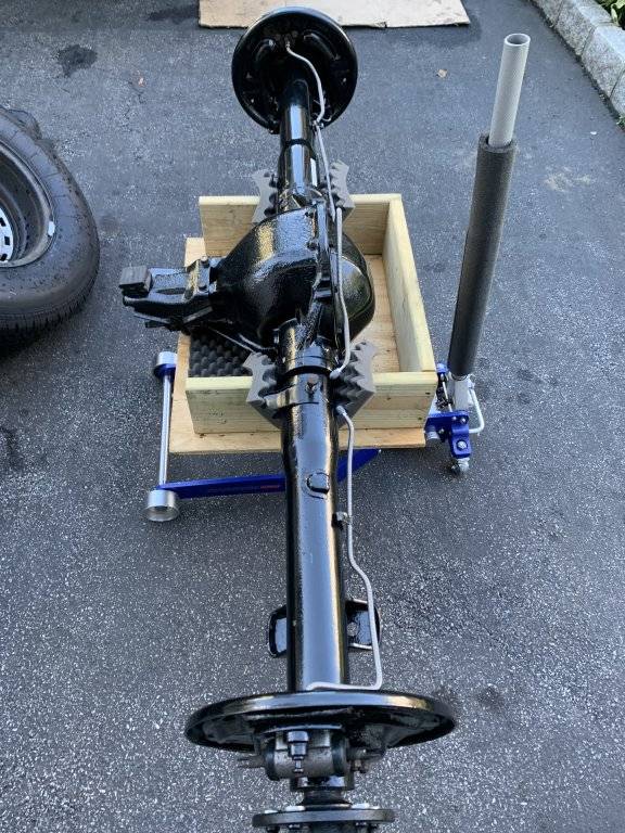

I also did the springs in a 70 polara convertible. They are not bad to do. Just make sure you brace the body on a jack stand as well as the axle. I did both at once so I needed an additional jack stand under the pumpkin to keep the axle from rotating on the U joint while I worked. A compact battery impact wrench will make this job sooooo much easier.
I went with ESPO springs and got an additional inch raise for the rear and the high performance springs (additional leafs that came with the 440 cars for that year) since the car was originally a 383 and now a 440. Love the stance (has a slight rake to it which I prefer) and it handles and rides a lot better (plus all bushings in the rear suspension were changed out at this time)
