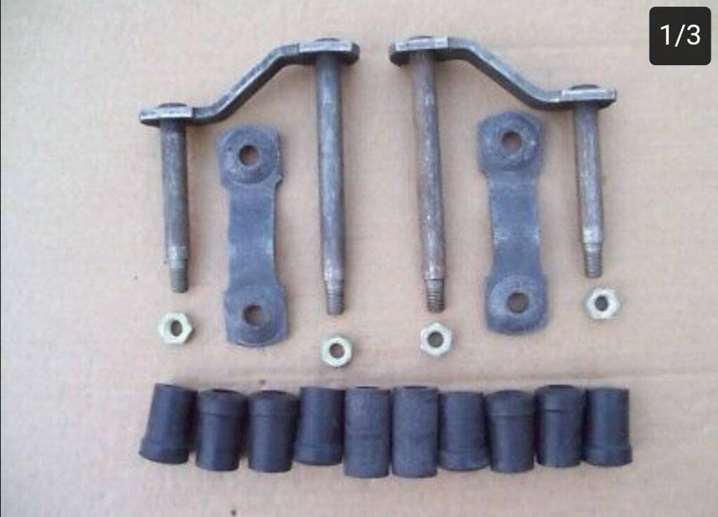

Rear leaf spring shackles

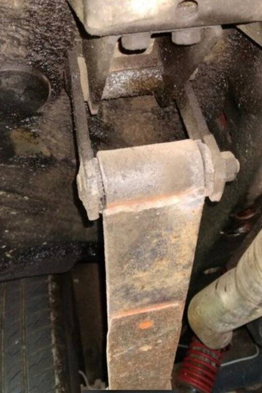

From one of Critter's posts, this shows the offset on one side.
OOPS - my bad... the one side not assembled to the pins looks flat until you look at it more closely. My 66 T&C also has a one side flat offset shackle, so when I searched for 65-68 to find my old AC Delco link, those came up from Mitchell's and without even double checking I just assumed they were the same as what my car has now.
Sorry! :lol::canada:

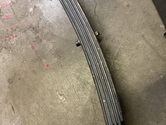

Someone has messed around with those leafs in the past. The first spring on the main spring has been cut, and is still too long, as seen in the one picture posted. Who knows what else is wrong. I'm sure the new springs will be a massive improvement.
This was a pic from another members car .
I just needed a pic of the shackle

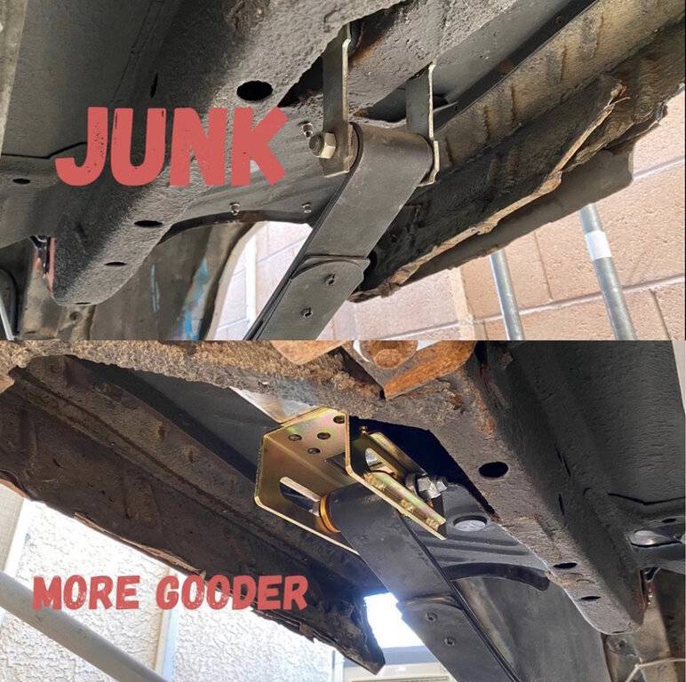

Okay I was looking at these and figured I’d pour some gas on the fire. Anybody ever use these? I never have.
PS; that’s not my commentary printed on the pics LoL!
That’s a 69 Charger by the way.

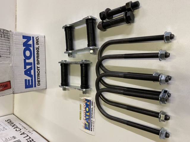

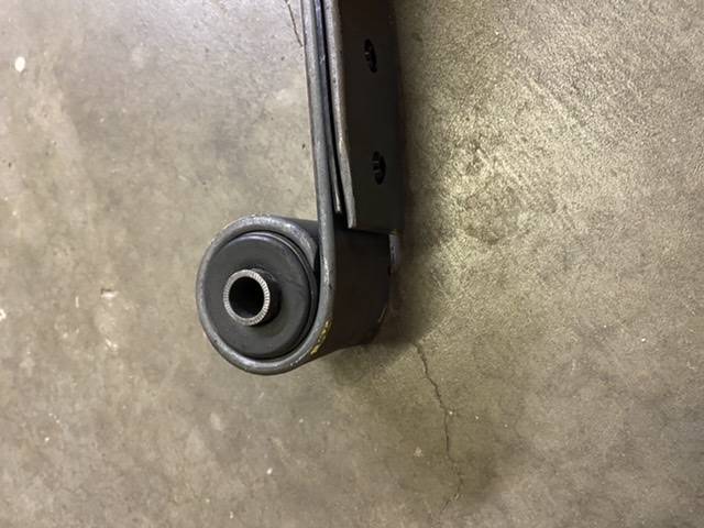

Update
New springs from Easton Detroit finally came.
New U bolts, nuts, shackles, and bushings front and back.
Install should be soon!
Update
Install should soon!

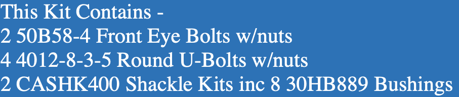

Great! If you have a chance to take pics and post them here, that would be great. Here is what their website gave me -- but I could not find any photo of the various parts, and would like to see things before ordering:
Interesting - how does one prevent the spring from walking in the shackle's slots?
I've never seen those before, by the looks of them they're designed to slide straight back and forth, opposed to swinging like a traditional shackle. Would in theory sit lower, and probably have a little less side to side play.
What are those called? I'm interested too!
Looks good! Although those aren't the correct offset shackles. Start soaking your old nuts in penetrating fluid, though it's probably best to use a nut splitter to avoid damaging the threads/snapping the studs.
This is all I got.
Thank you for posting. It'd be great if you could add a list of the numbers for the parts they sent to you.
It was @Big_John that was looking for the offset ones - I think the OP just needed the parallel ones as he received.
I think that's right. I am in the same boat as John, needing the offset parts for a couple of 1970 Polara 'verts.
