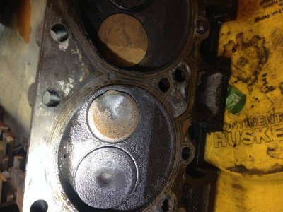

And hear it is.....
What I cant figure out is that the valve seat looks pretty good but the valve literally looks to be worn out like it had been eroded away. I've never seen that before. Likewise, the top of the valve also shows the same wear aligned with the wear on the face. With the valve shut you can actually see light between the valve and the seat. The top of the valve stem looked smooth as glass but had a very slight crescent raised edge (about a mil) on the top which matches up to the wear on the valve. The rest of the valves looked fine.

I think that was caused by a blown head gasket in that area. The escaping heated fuel and oxegen between the two cylinders was like a blow torch on that exhaust valve.
My educated guess is that you had some carbon stuck on the back side of that valve.
The end result is that the valve doens't close all the way causing leakage of high temps back into the head.
The seat is harder than the valve thus saving the seat but causing the burn on the valve which is a much softer material..
Another possible is a bad valve guide allowing oil to drip down when the engine was off.
When fired up the oil burns causing the blow torch affect mentioned by BullDogChesty above.
either way once that crack in the seal starts, it just accelerates until you get what you see here or even worse if ignored.

I ran a compression test on all the cylinders and the number three was the only one that was low. So, I'm just rebuilding the one head. With only 62000 miles, I didn't think I needed to do both now. I figure I'd do both when it came time to rebuild the engine.
However, I am replacing all the valve guide seals on both heads (several were cracked) to see if I can reduce the amount of oil that the engine is burning. I've had 440's before and they have all burned a little oil and leaked a little more than my small blocks. And, by having to replace the valve cover seals, I figure I can cut down on the leaking as well. (The seals were original)
On a separate note, the engine was very clean inside which made me feel better about doing just the one head.

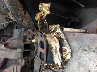

There is one more thing that I discovered in the disassembly that I'd like some help with.
I found this fiberglass tamale wrapped in aluminum foil under the intake manifold.
It appears to be an insulator between the bottom of the intake and the valley cover. My guess is that it was to keep the exhaust cross over from cooking the gallery pan and carbonizing the oil on the underside of the valley cover pan.
When I found it, it literally crumbled in my hand and the portion under the exhaust crossover was oil soaked and had carbonized into a cookie. The underside of the valley cover pan was clean.
Since this is something no one will ever see, my questions are:
Do I need it?
Can I just leave it off? I figure without it, the air can at least move through the gap when it's running or circulate through convection with the engine off.
Wouldn't a reflective Mylar finish on a flat steel panel do better than stuffing the gap full of fiberglass and cutting the airflow to zero?
thanks for all your comments and advice guys!
I do think you are right that is an insulation they put on top of the valley pan/ under the intake. toss it and when you get the valley pan get the one with the heat crossover block off

It's been a long time since I did one of these... I didn't think about the foil insulation.
It was there for a reason so let's talk about that.
I believe it was designed to prevent the following.
If the heat riser gets stuck in the closed position the exhaust gases will continue to flow across the intake after it should.
the high heat temps will cause the oil splashing around the intake valley to burn which would turn the oil into fumes resulting in the PCV system working harder plus making it appear that there is an oil consumption issue. - which in reality is an issue..
The foil is good to have if you can keep it there.
I can't say I know of any replacements being offered if you want to replace it.
Blocking off the cross over?
My thoughts on this are,
Depending on where you live and when you drive.
If you live in colder climates then you should not block off the cross over if you drive the car in the colder weather.
It's there to heat up the base of the carb which will give you better running including less carbon build up plus better atomization of the fuel as you drive with a cold engine.
Chrysler had an issue with sludge in the 70's in certain regions of NA especially the north areas.
Presuming that your heat riser is functioning correctly, the cross over only really functions when the heat riser is cold re-directing exhaust heat across the intake to warm the carb.
Once the heat riser opens up then there is next to nothing flowing across the base of the carb which is a good thing for a cold engine.
Once up to operating temps, the heat riser needs to open or it will overheat the base of the carb which could cause vapor lock plus cause your engine to overheat with the constant flow of exhaust heat across the top of the block. Bad news all around :(
If the car is strictly driven in warmer climates then you could block the cross over off (Like Florida) :D
If you drive during cooler/colder weather I would not block it off.
Just make sure the heat riser is working properly and you should be good to go.
In the end it is your decision :)
Chrysler's official explanation for the insulation was it was put there to deaden valve train noise. In fact it was called a "valve tappet noise reduction silencer". Secondary reason was supposedly to lessen heat transfer to the intake.
