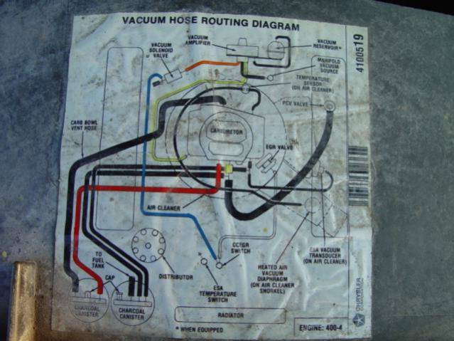

The Emissions section in my FSM show nothing remotely like that.

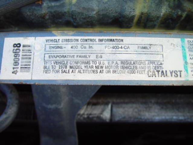

The sticker on the radiator support - Does it say it's a Caly-for-ny-aye engine?

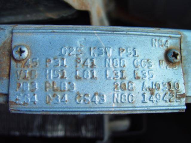

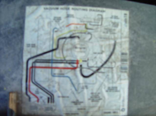

I don't think it's a Cali emission car. no indication on the radiator support. The emission tag is 4100968. I took a picture of that sticker, the vacuum hose diagram and the fender tag. I'll post them now as I'm hoping to have a flashback on posting pics. It does have 2 vacuum canisters and has a fuel filter that has an extra vent line (or return) to the fuel tank.

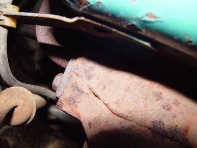

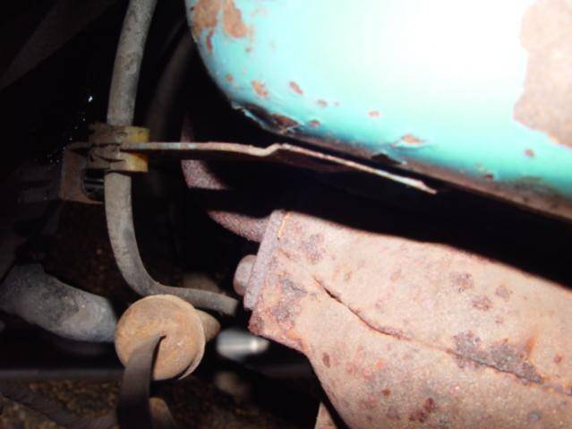

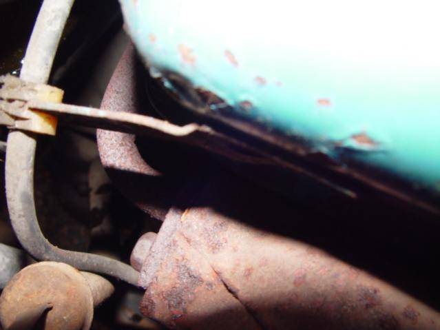

I coudldn't get any closer to the rear of the manifold. It's that 1/2" tube with one bolt on the bottom side of the tube that's bolted to the rear of the mainifold.

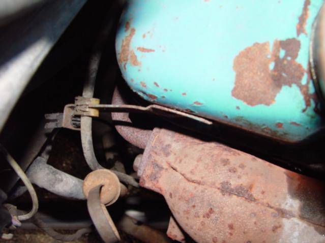

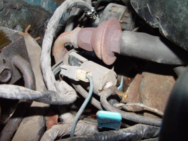

The 3rd picture shows where that tube comes over the intake and goes into that check valve then it goes into the bottom of the air cleaner base. I don't know if all 400's have this or just 1978's.

The only way to figure out why it's there is to figure out which way the check valve works.
1. to prevent air being DRAWN from the air filter to the exhaust, or....
2. to prevent exhaust being DRAWN into the ar filter.
We can then take it from there.

It's called an aspirator valve. All 78's with a cat has it. It uses exhaust pressure pulsation to draw air into the exhaust system. It draws fresh air from the air cleaner past the one way check valve (aspirator). I don't have a cat anymore. I have duals from the manifolds and flowmasters. My plan was to just eliminate that whole tube and check valve assembly since I don't need it and I won't be able to connect it to the air cleaner after upgrading the intake/carb. I don't know if you can see the one bolt mounting that tube to the rear of the manifold. I'm just leary of trying to take that bolt out of the exhaust manifold that has been there for 34 years without breaking it. I plan on hitting it with PB blaster for a week to loosen it up. I was hoping someone else has an easy mod for this. If I get it off, I was thinking of cutting it off flush and cover the hole and weld it and bolt it back on.

There's only one tube on the right manifold. I don't know about other years, but '78 400's don't have air pumps. It's the only Mopar engine that doesn't have one. From what I understand, that tube and check valve draws clean air from the air cleaner and flows through the exhaust manifold and goes to the cat.

I soaked it overnight with Sea Foam Deep Creep and it came apart easily. Threads in perfect condition too. I'm suprised since it was screwed into the exhaust manifold for 34 years.
