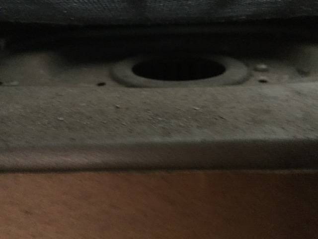

Our 68 300 has the factory rear defogger, which is neat and all, but as some of you probably already know, they weirdly mounted the motor in the passenger-side speaker opening.
I'd like to put a set of 6x9's and a bluetooth head unit in the car so want to move the motor. However, it looks like the motor intake flange is mounted in the speaker opening from above. I don't want to remove the panel over the rear speakers if at all possible to avoid damaging anything. Does anybody know if there's a way to remove the motor assembly from the trunk-side w/o cutting or bending anything?

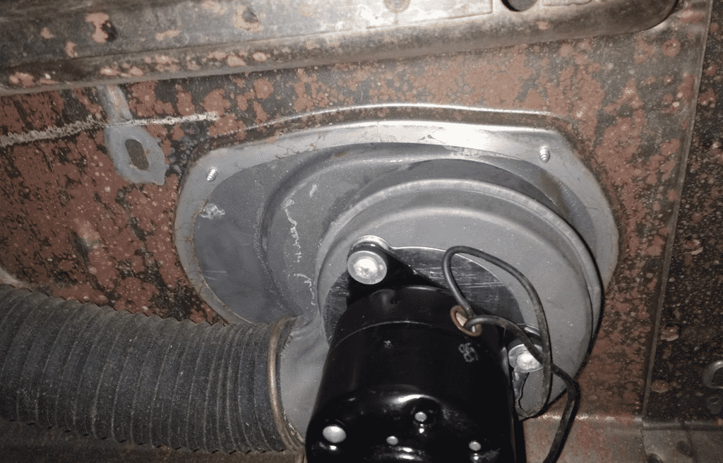

The rear defog motor does bolt up underneath the rear package tray.
So,you can undo it from the trunk.
But to be honest with you it is easier to work from inside with the rear seat removed.
With a stereo installation you may as well remove the rear seat to thread the wires anyways and make thing neat and tidy
Not wanting to cut anything up,you may have to eliminate the rear defogger altogether.
This pics clearly shows the screws pointing upwards.
hope this helps.

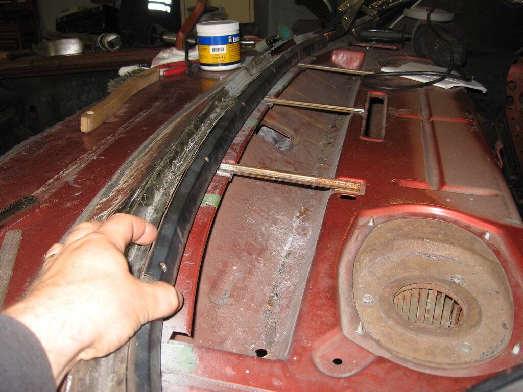

Looking at my rear shelf again. The fan adaptor plate is installed/screwed from above. The speaker from below.
My car is just the opposite.
Will post pics when I get home.
I think they were designed to be installed either way.
This pic taken after rear shelf had been re-installed. The screw heads are visible and the adapter plate is installed from top.
Note the 3” gap between rear shelf on my car.

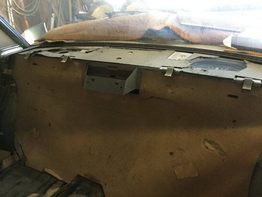

I had thought of just mounting that plate on the back of the rear seat and let it draw air from were ever so I could use both speaker openings.
Yes, I knew I wasn't going crazy...heheh.
That's what my plan was. I mean, what's the difference whether it sucks air from the cabin or trunk. Although I was also thinking of utilizing the rear fan switch as the Power ON for the amp head.
I just cut another 6x9 hole in the middle for the fan and put the speakers outboard.
You may want to consider sucking the air from the cabin versus the trunk, especially if you have air conditioning. I think the air in the cabin will be drier if you have air conditioning, as the cabin will also be warmer also.

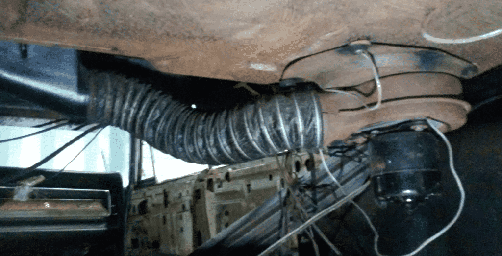

Back in the late 80's/early 90's I pulled a rear defogger out of a friends 74 Satellite that was destined for the junk yard, to install in my 68 New Yorker. I distinctly remember that it was not installed in a speaker opening. Rather, it was just mounted against the sheet metal below the rear deck in such a way that there was about a 1/4" ~ 1/2" gap between the fan intake and the sheet metal. When I installed it into the New Yorker I did it the same way. It actually did help to clear the rear window fog -- mainly in the middle where the air flowed, but it was better than nothing.
It's still in the New Yorker so I'll get a pic of it when I can.
I stopped by the building today and took a pick of how I mounted the defogger motor in the New Yorker. That's more-or-less how it was in the 74 Satellite. Maybe it was a dealer installed option on that car. In fact, maybe that's even why some are mounted in the speaker opening from above or below. Maybe if it was above, it was installed at the factory, but when installed below it was dealer installed?
