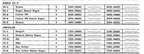

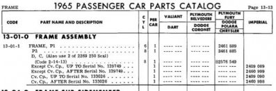

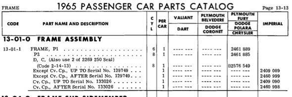

More information about 65
It didn't occur to me but I was doing some searching on my computer for some pictures that I took of the car and I came across the 1965 Mopar Parts catalogue.
I took some screenshots of the important information.
As it seems, I can use any Large Chrysler listed above or Dodge.
I don't have any info about 66 or newer.
Thanks
Eric
