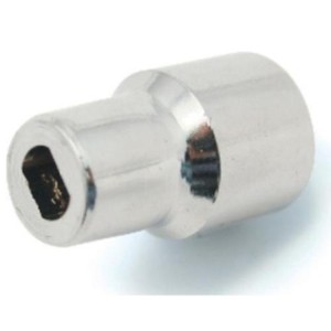

this is a socket that uses a 3/8" drive gun so you just hold the nut with the 9/16" wrench and then spin the shaft of the shock with the gun to remove the top nut(s)
Nice.
What is it?
It's a special socket to fit the rectangular pilot at the top of the shock mount stud. Used in conjunction with a end wrench to remove the nut. I've had one since the 70's and only used it a couple times before learning a better way.
