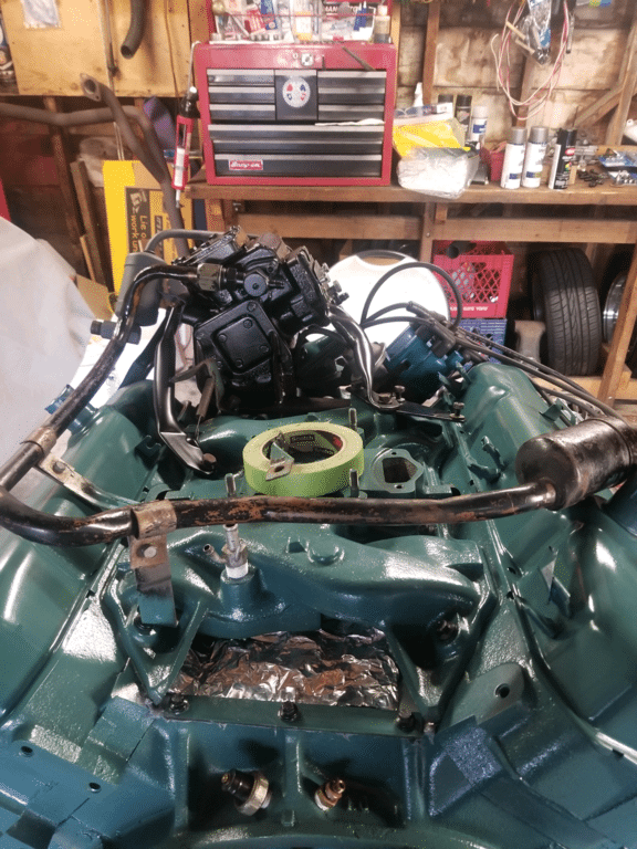

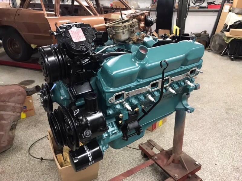

Wonderwagon, GREAT JOB! - I'm mocking up my motor and detailing it as well before installing. What color are you going to paint the AC tubing that runs along the rear of the engine.
After this photo was taken I stripped everything down and it's actually BRASS, but did see some engine color underneath. When my pops worked rebuilt the motor I think he just painted everything BLACK. Do you know if the AC tubing and canisters from the factory came brass/copper or painted the engine color?

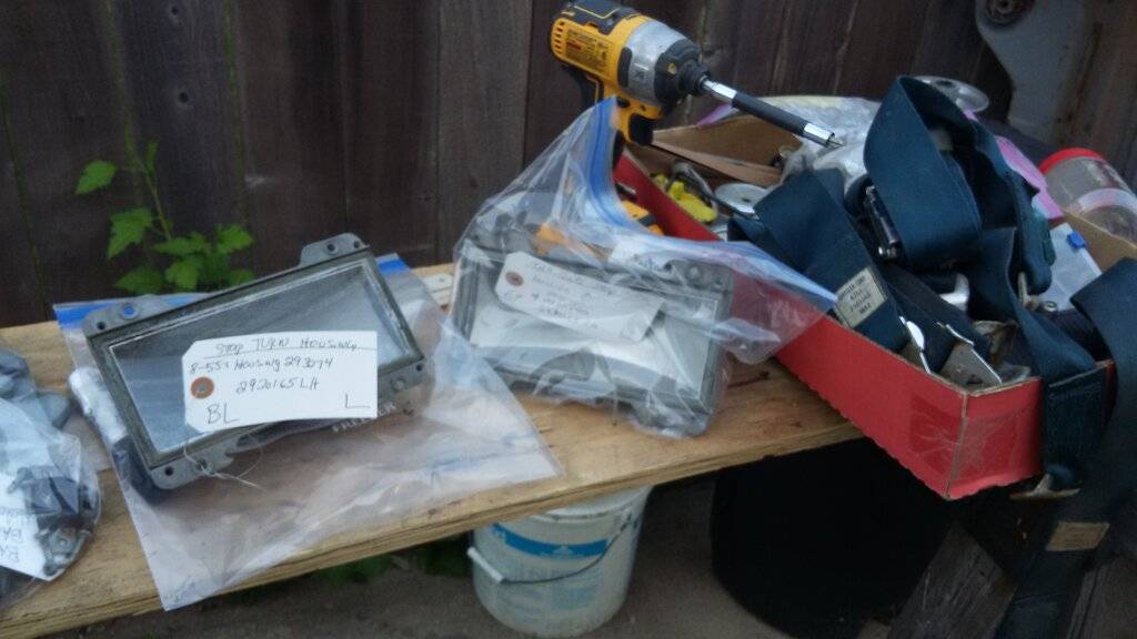

Well, got through the dozen or so boxes, bins, and loose parts, with a couple more found. Everthing has been tagged with smaller parts bagged and tagged. Hardware bags will be next. and finishing an inventory list that has its first printing. will dump each bin and check off. Two weeks at about 4-6 hours a day with a Service manual, parts book, Crash book and a couple other things. How do 300 bagged and tags parts looked organized? Sixteen bins and larger pieces stored. Couple big items missing, underhood wireharness, the radiator rock shield and the 3rd row seat footwell sheet metal trim. Dosen't look like much

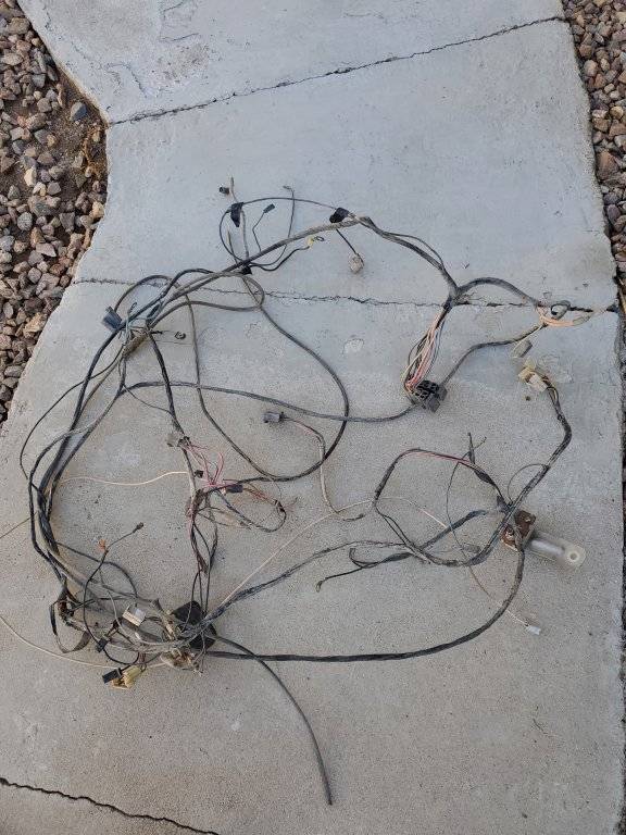

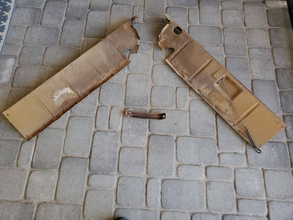

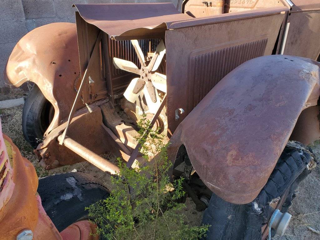

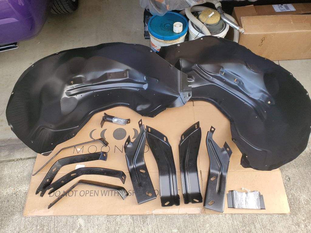

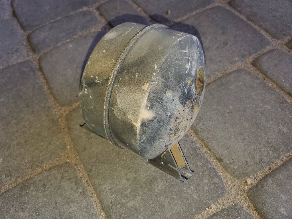

Wew, the fun shopping trip. Hidden Valley Auto Parts had the under-hood, heating/ Ac control and brake light wiring harnesses. All the sheet metal trim for the 3rd row seating foot well. Hopefully a serviceable vacuum resivour,, and parts window washer fluid tank. BORING pictures let's try again. Couldn't find the garden hose

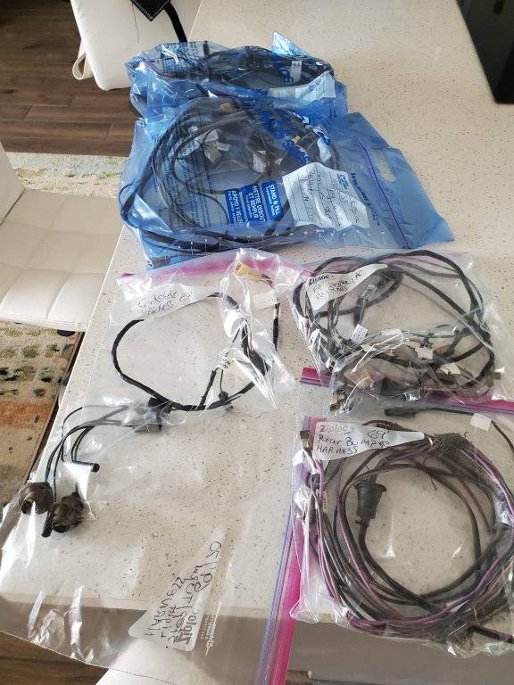

Bagged, tagged, connectors labeled for their end use devices. Have the harness for patterns, now to decide the next course. Pack'em for the flight back to Chicago this week. Still have the remains of the washer bottle and a complete vacuum resvoir to clean up. Hope TSA isn't a pain, already checked with a supervisor two weeks ago. Fingers crossed.

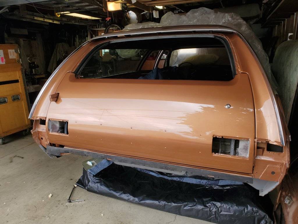

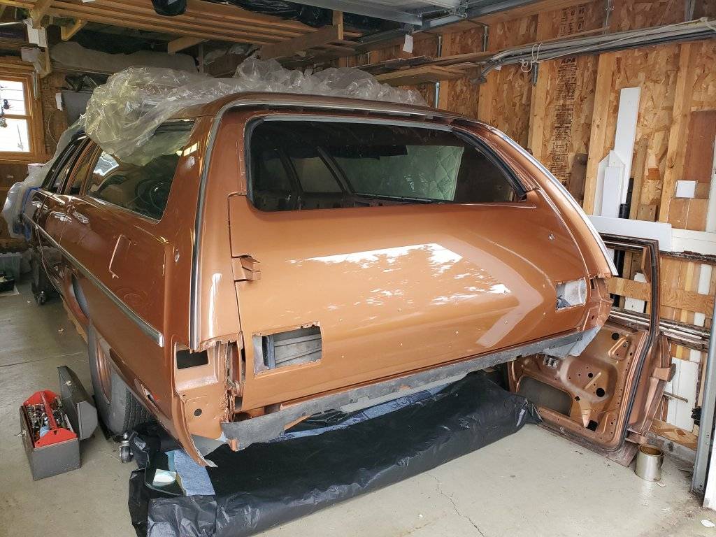

Today is a momentus day, in a couple ways. Hung the rear tailgate on the car. Things almost went sideways. The upper hing was from 1970. The upper hing pivot point uses a captured pin in the casting. 69' the pin stays with the door hing casting and drops down into the body half of the upper hing. Lower pivot point, needs to drop over the pivot bushing at the same time. The only way to do this is to spring the door open between the tailgate and door position to finess it on. Forgot the wireing goes through the tailgate pivot' so pinched a few will need to slip some heat shrink on.

Had one other surprise after the tailgate got rehung, neither the door or tailgate opens without manually tripping the latches. Hope to clean and lubricate everything, close attention to the handle mechanisim will be made
