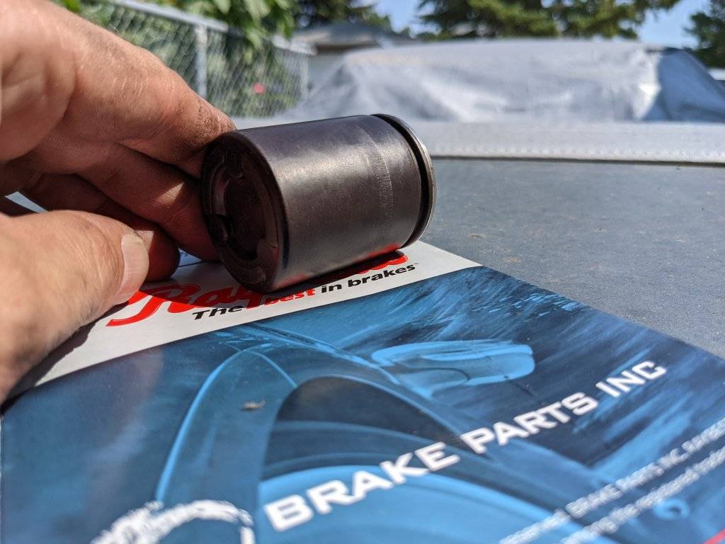

And after rereading my post, I came of negative given my frustrating experience. The cast aluminum bodies and phenolic pistons are actually a good combination, chosen for their excellent heat dissipation. The problems arise when you try to reuse old, high mileage calipers, or cheaply rebuilt calipers, with new pads and rotors. The cylinder bores develope ridges, and the pistons lose their sheen, leading to dragging brakes.

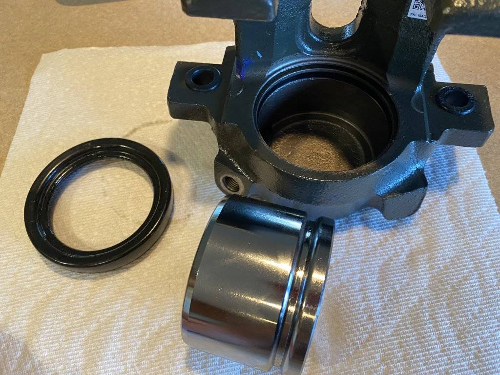

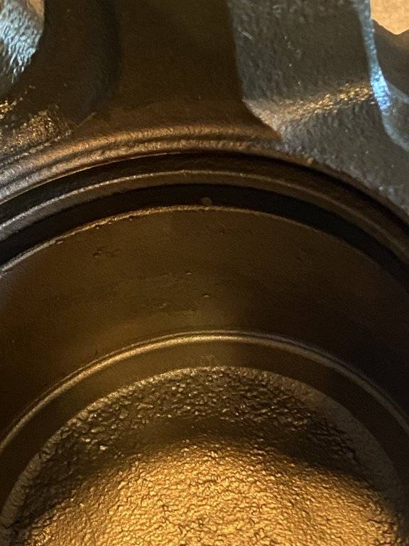

Pictures...
Looks clean, however it looks like they painted inside the bore. You'll want to remove that. The boot looks like the type with impregnated metal ring, not sure if that type works with this caliper. Mine used the all-rubber boot. Did you get a piston seal with it? Hard to tell if it's already installed in the casting....
The whole caliper has been blackened. The ones for my Magnum were too. I didn't like the looks of it, on the inside of the bore, however it seems to be nonreactive to brake fluid. It will scrape off with any misalignment caused by rough pistons, tight seals, and cylinder ridge.
Those shiny pistons are going to be nice!
yes if they didnt screw them up when they rebuilt them . i had tat happen with a 87 dodge truck .i had to get a pair from a junk yard & have them rebuilt mine was non rebuildable the bore was r=too badly scored my truck had a hard life before i got it
Someone scammed you out of a set of calipers. Piston does the sliding on the seal (except for Budd calipers) on all Chrysler products. As long as the seal grove can be cleaned enough to hold seal properly. Bore is usually nasty even on a nice set of calipers.

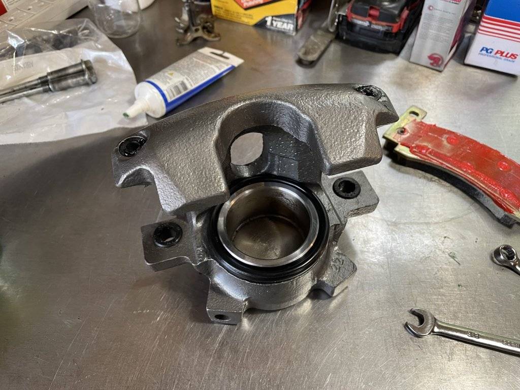

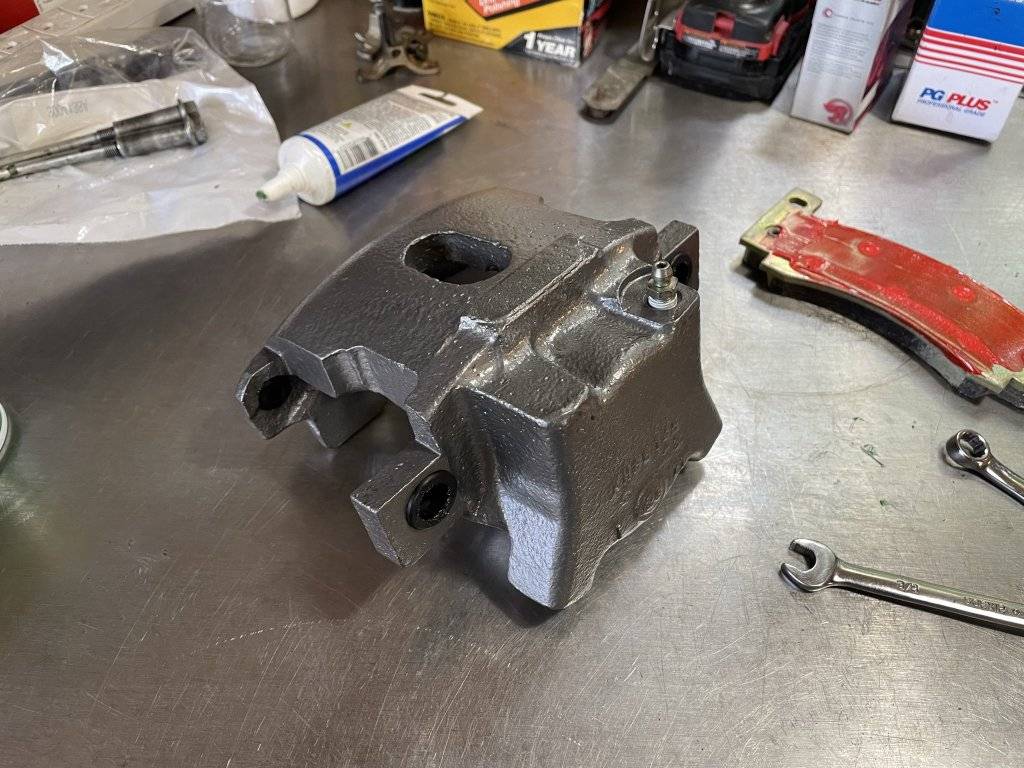

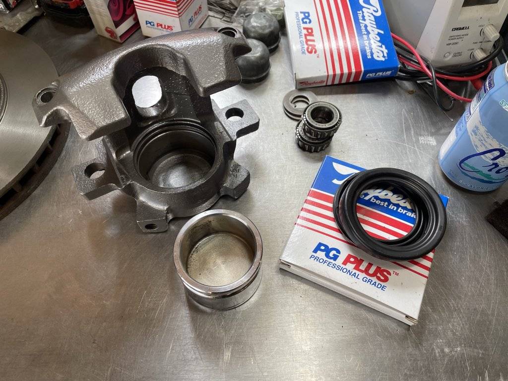

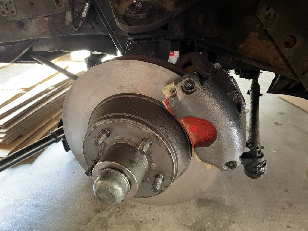

The photos below are from my 1973 NY when I rebuilt the LH caliper a few months ago.

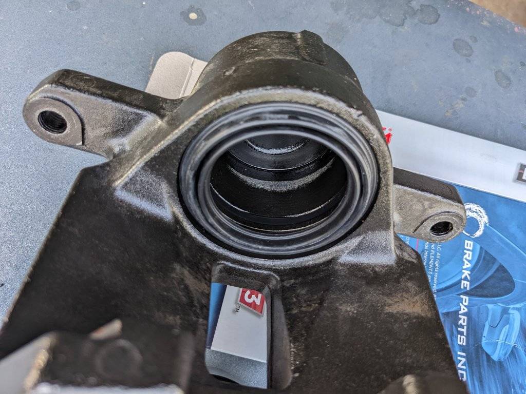

I remember getting one B body caliper with a set of rebuilds years ago, simply exchanged it for the correct one. I'm guessing it's not as simple when purchased online. As I recall the B body calipers are actually more valuable? And in that same vein, here are the rear calipers for the Magnum I received, of course the ONE box I checked at the store was the right one!
