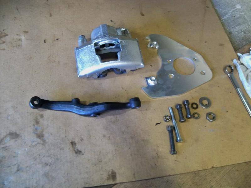

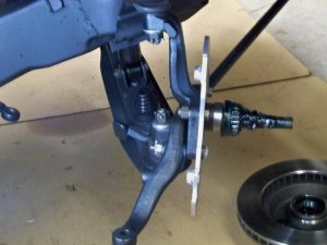

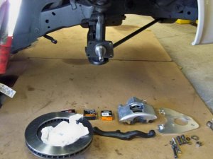

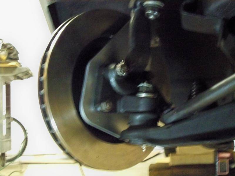

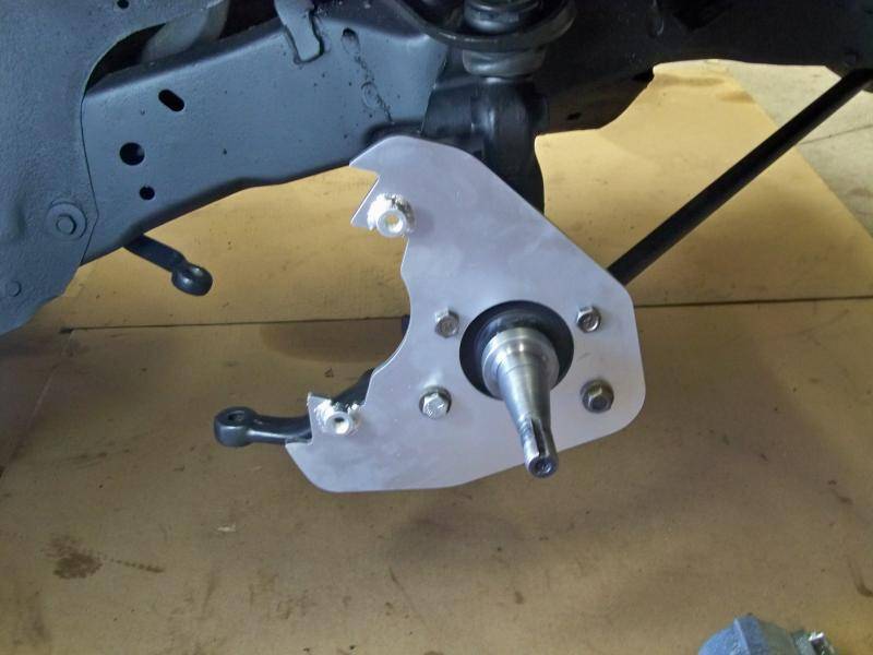

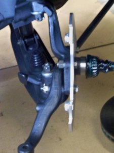

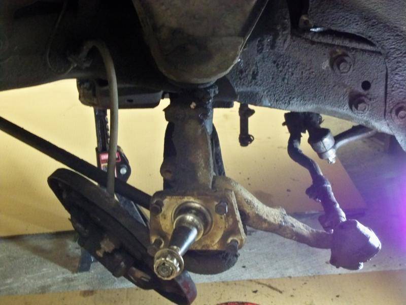

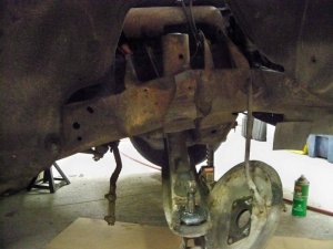

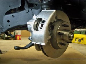

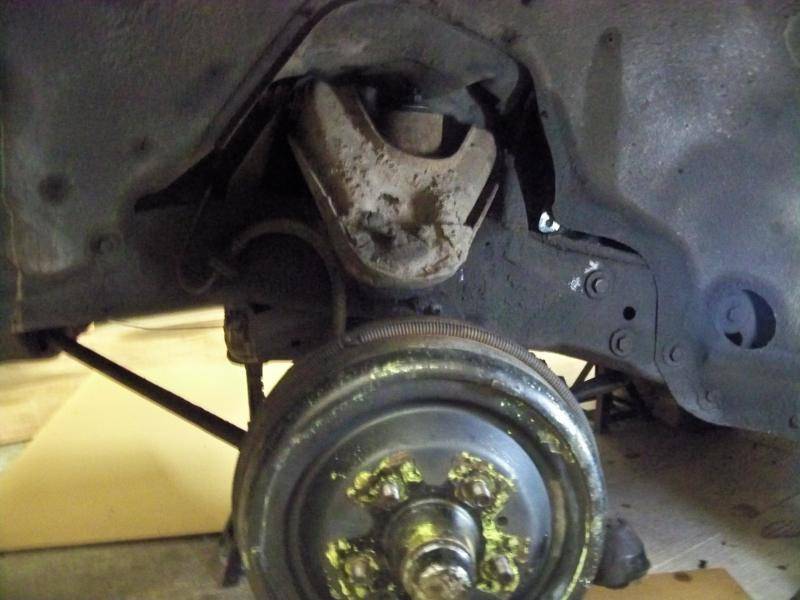

Just finished putting disks on the old girl with scarebird adapter plates, could not be happier!
Total cost was less than 400.00.
Ram calipers, plymouth fury inner and outer bearings and seals, ford galaxie 11.75 rotors. Easy install, put first adapter plate on backwards, easy fix, no grinding or cutting, everything fixs and turns with no rubbing anywhere.
Look how clean that chassis is.... nice. How easy is it to get replacement parts if something gets worn out?
I have not gotten that far, completely rebuilding the entire front end along with ps.
That's the first time I've seen pictures of it by someone who actually did the Scarebird conversion.
