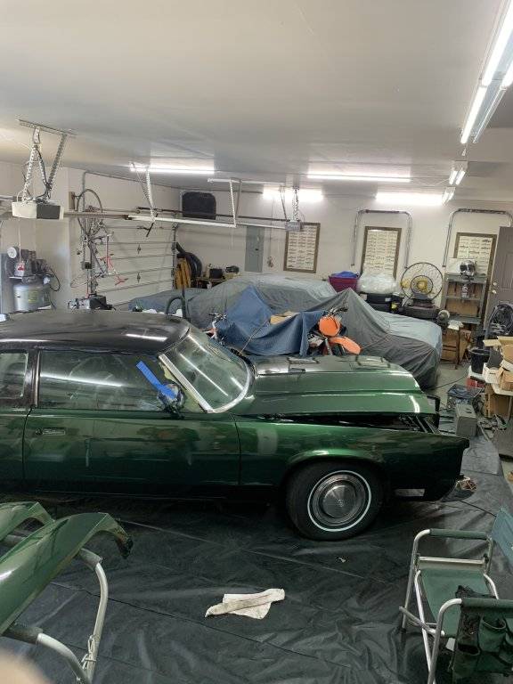

Scored me a Crown Coupe !

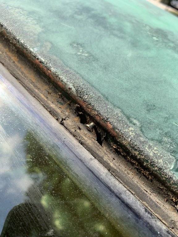

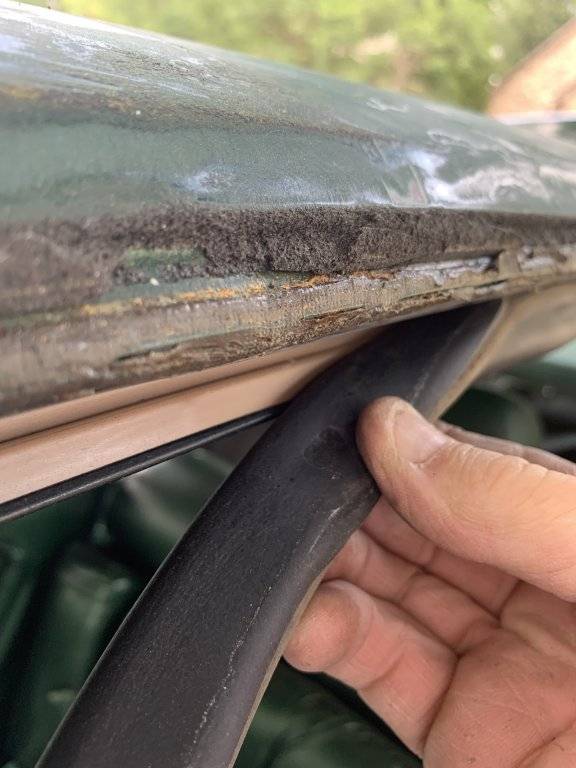

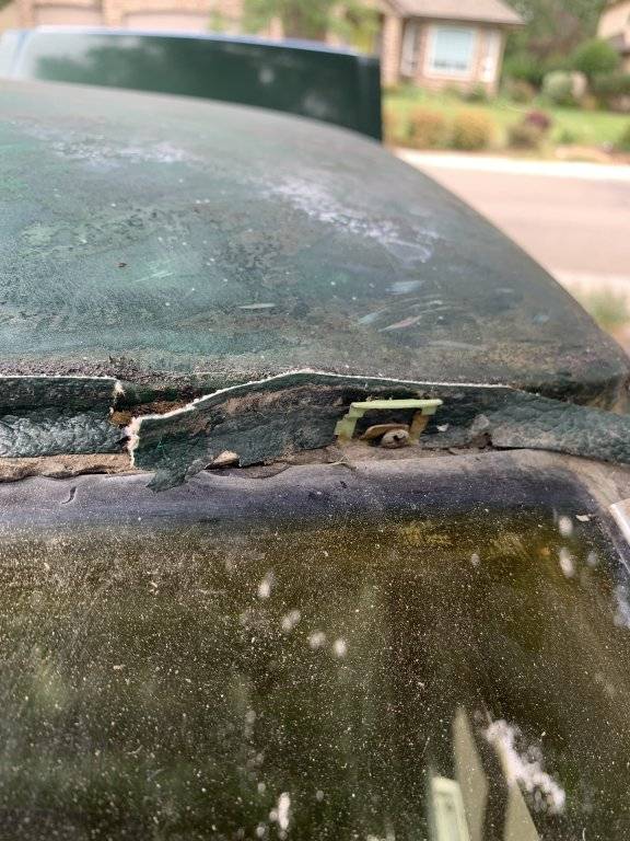

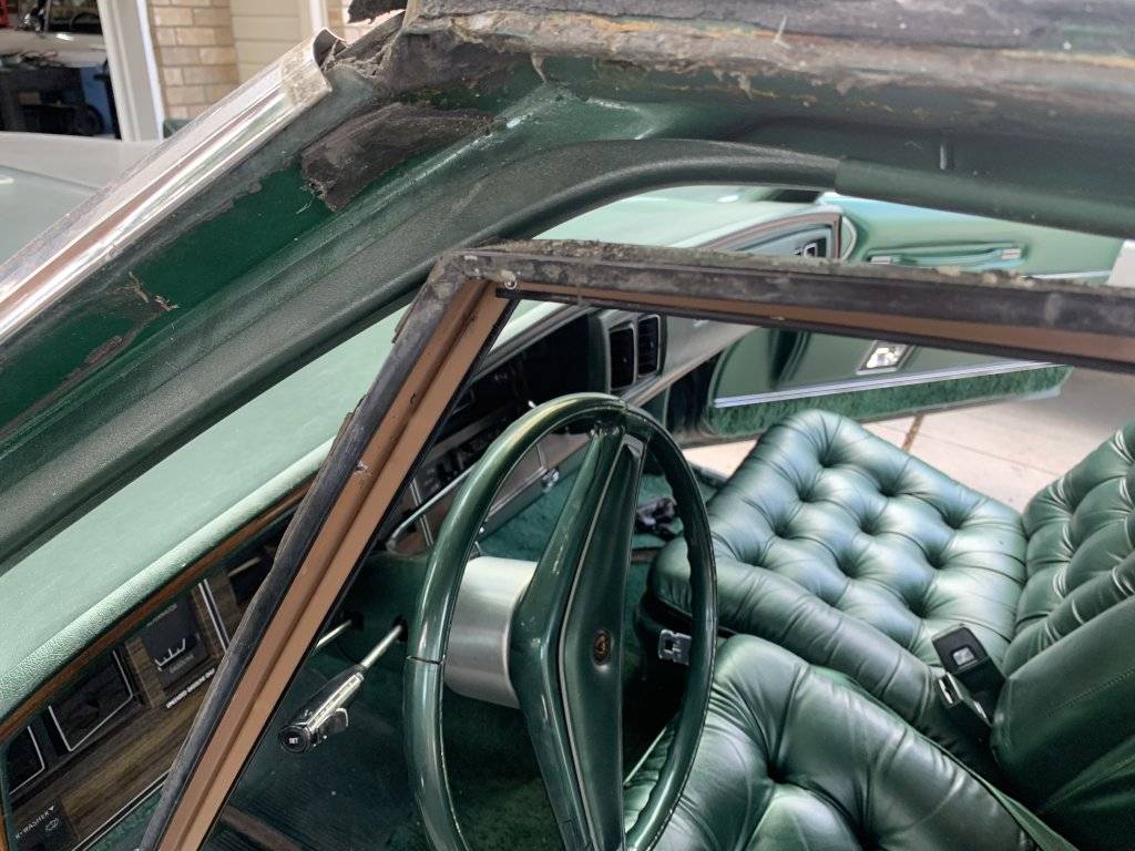

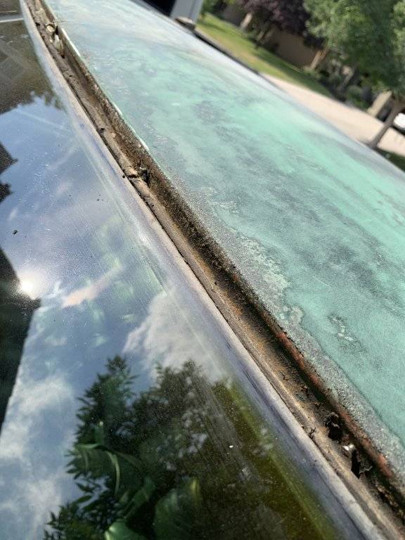

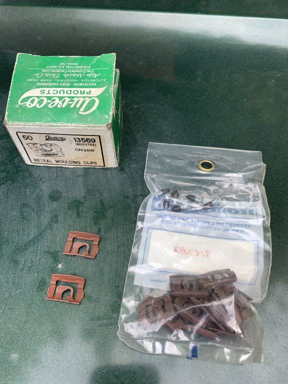

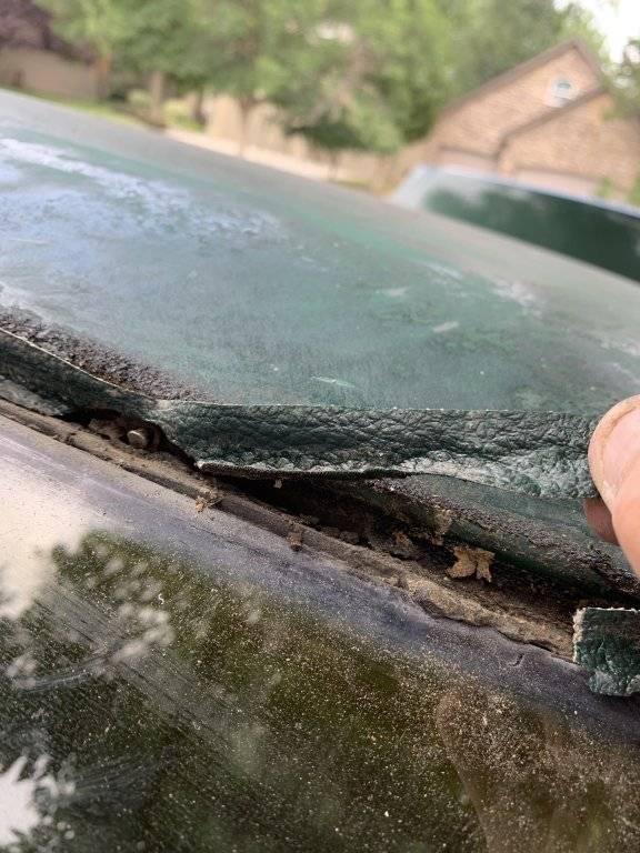

Removed the door and windshield trim in preparation for paint then top . Not too hard if you have done a few Mopars over the years and know the sequence and where the hidden screws are . Vinyl top does not tuck under windshield .
I should start a seperate tutorial thread on replacing a formal padded top .

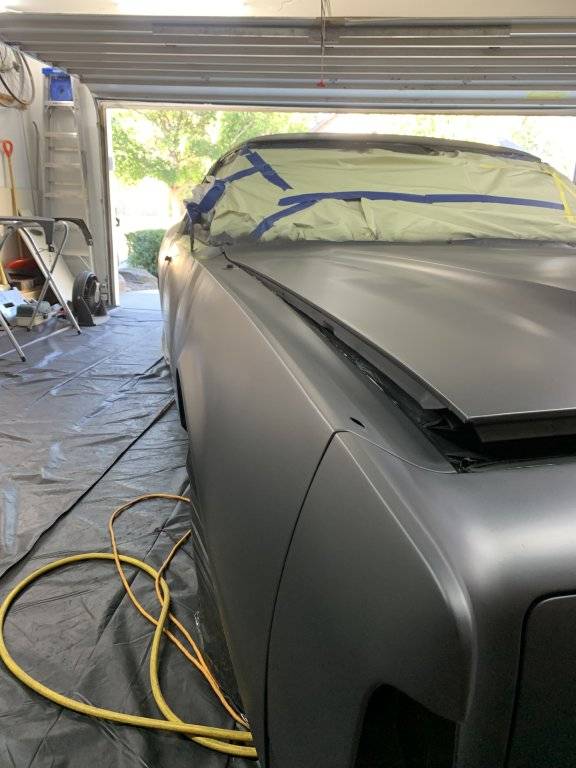

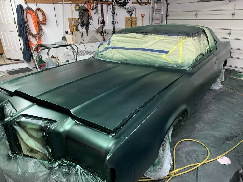

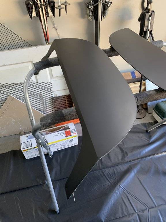

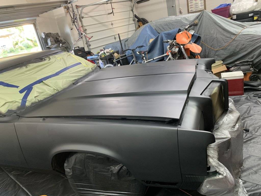

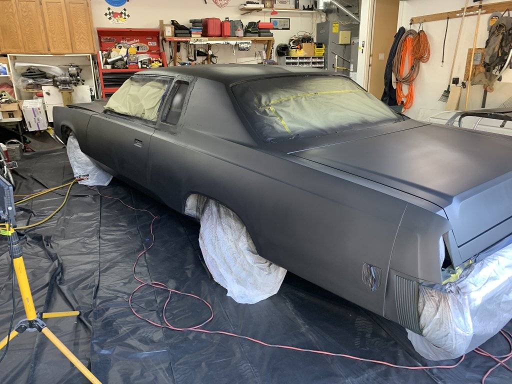

Stripped all the trim , most of the paint and prepped it for primer over the last 2 months .

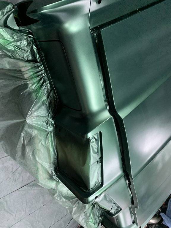

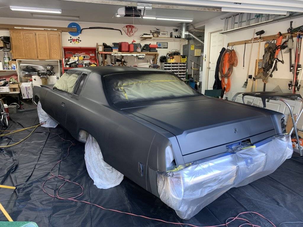

Got the primer on today and it looks awesome ! Body is super straight ! Hope to have color on it in the next 2 weeks after blocking primer down to 800 .

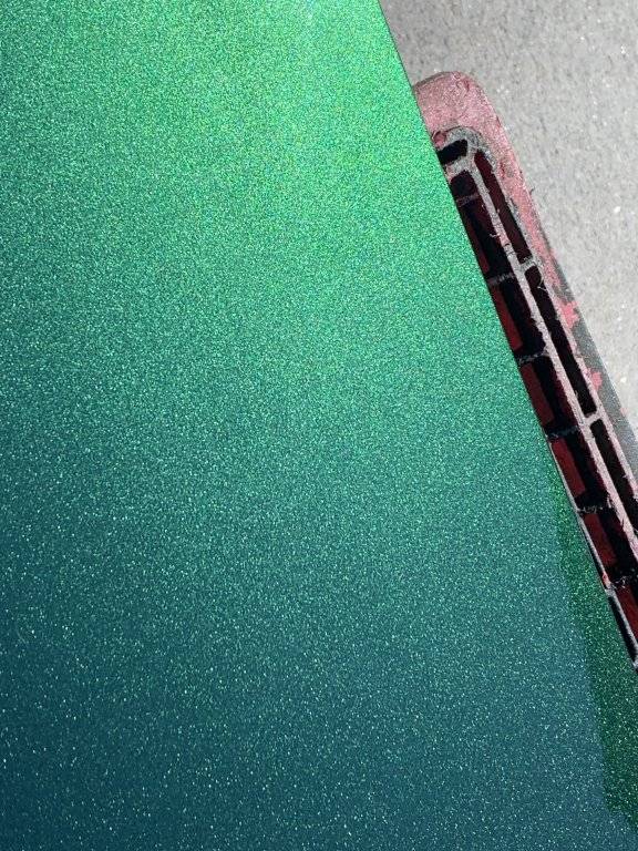

LOTTA work ! I had the paint custom mixed to original color and they sprayed a few samples to get it right . WOW !!! What a beautiful color ! No wonder so many people bought pickles ! Lol….

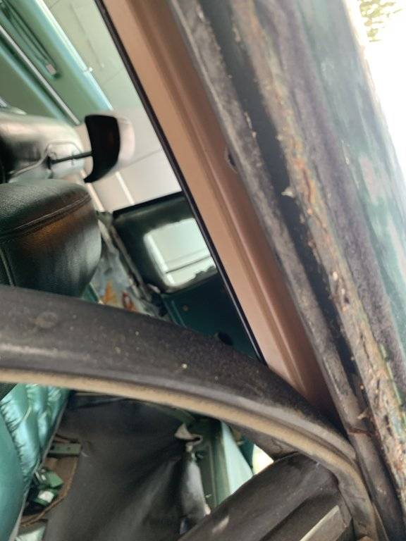

There is absolutely no rust on this car ! Freaking amazing even for Idaho !

That particular shade of green is a stunning color, especially when paint is fresh, or on a well-cared-for original car/truck. Can't wait to see your car in one color!

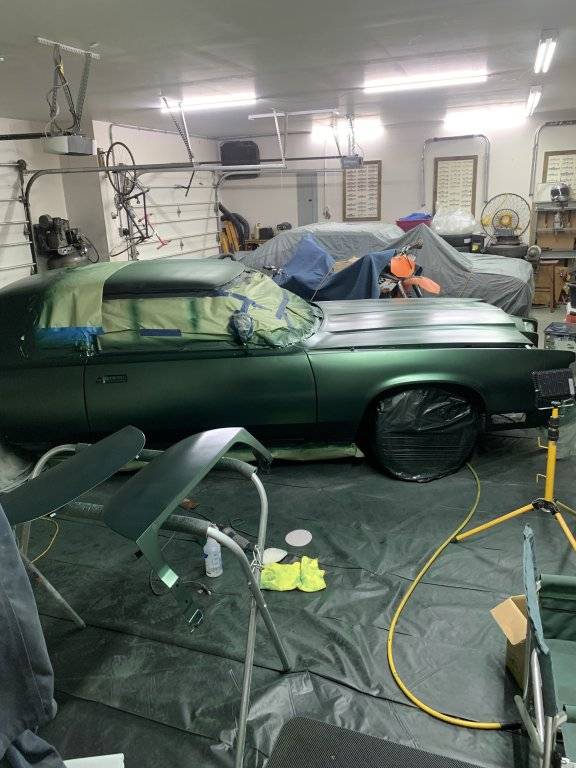

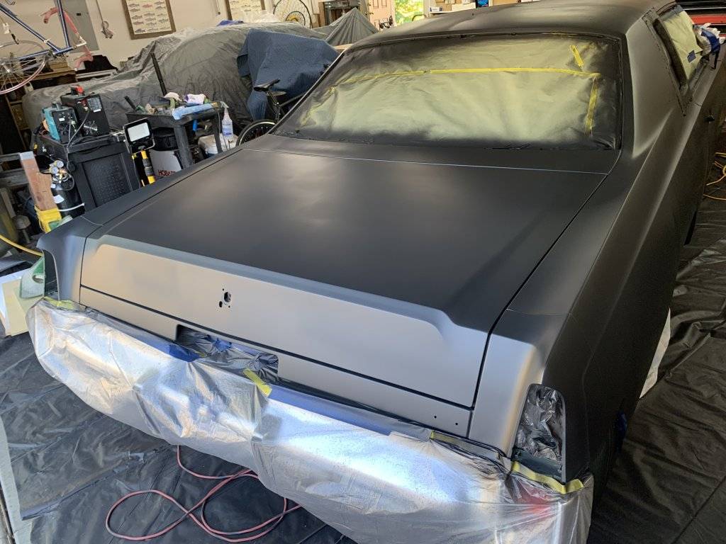

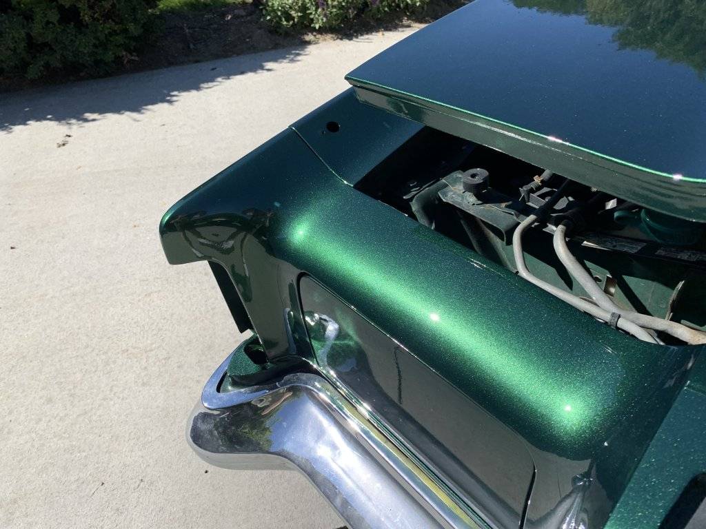

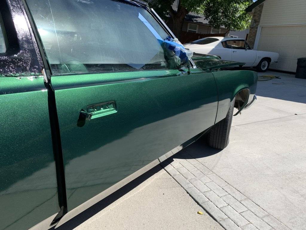

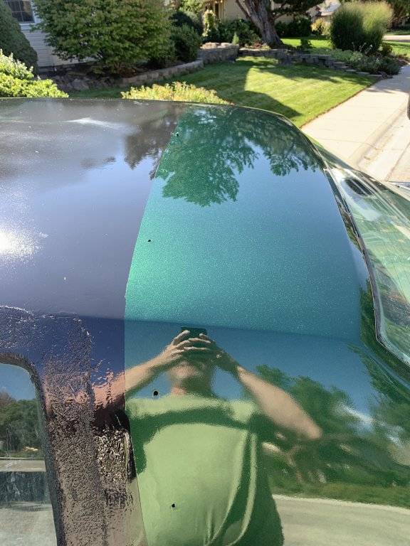

Base coat is on but hood and trunk have some tiger striping so i will scuff reshoot and clear in the morning .

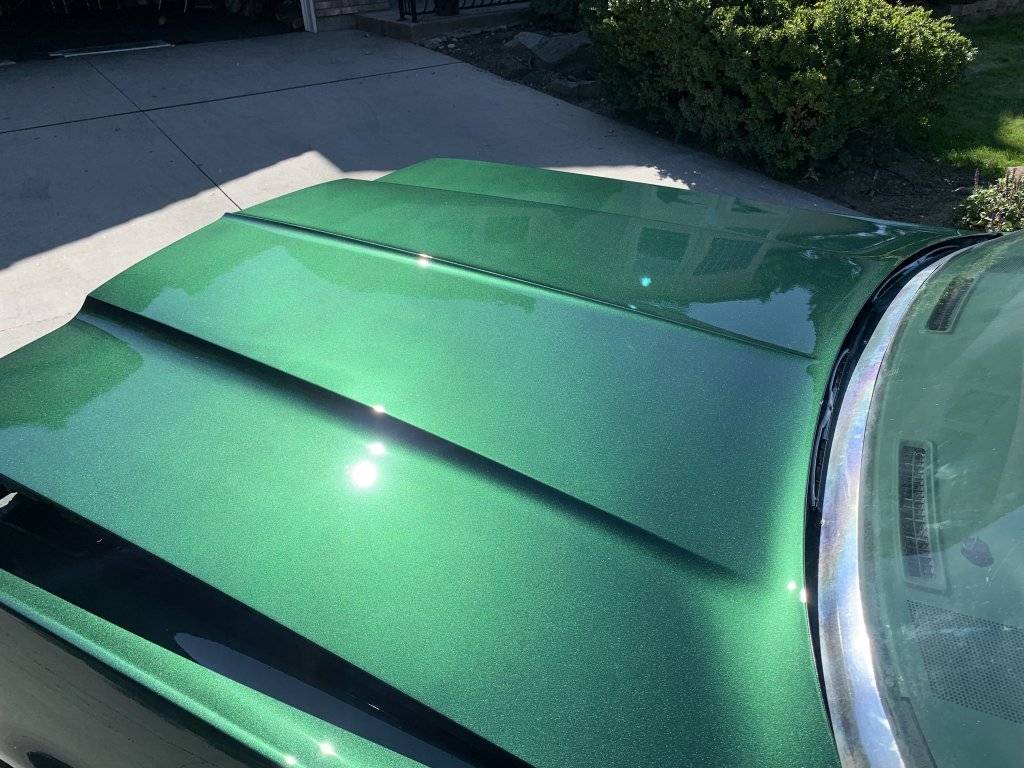

COLOR ON !!! Looks awesome . Pictures just dont do this color justice! Wow !
Now the outside looks as nice as that beautiful inside! Thanks for posting so many pics. I enjoy having a front row seat to this transformation!
Hey, do a video on the vinyl top installation. My 67 Newport customs needs replaced.
