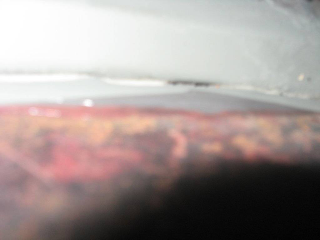

I used some towels last night and soaked up all the water out of spare tire well. The area is completely dry today. I took a better look today and noticed some rust along the bottom channel of the side window on the inside of the tire well. I also noticed some watermarks on the inside glass from top to bottom. I am thinking the rain was coming down hard and the window seal must be suspect. I got to figure how to remove the outside trim and get a look at the gasket. looks like the same scenario as described Wonderwagon above. going to check the FSM if no luck ill take it to Bodyman that repaired the rust. don't want to eff up the trim. will let you guys know. I am leaning towards the 3M brushable sealer as it seams to be the easiest to get into the nooks and cranny's of the spare tire well

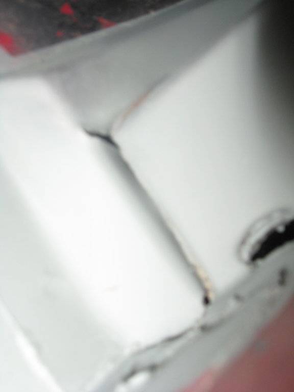

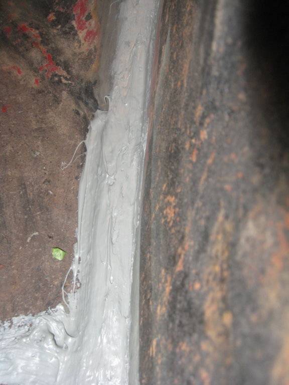

spent better part of a afternoon removing all the seam sealer in the spare tire well. I found 3 holes that the factory sealer had shrunk and exposed along with the seam along the bottom of the tire well and the 3rd seat foot well. I got some brushable seam sealer and will seal all the holes then check the side glass for water intrusion. I sanded all the areas to bare metal then coated with self etching primer. took pictures but the digital camera will not download to computer working on getting a newer one and will post when I can make the download.
Sounds like a good plan! Those spare tire wells have always been very exposed to perils that normal quarter panels are not. Following the seam sealer application with some paint and then spray-on undercoat might help, too.

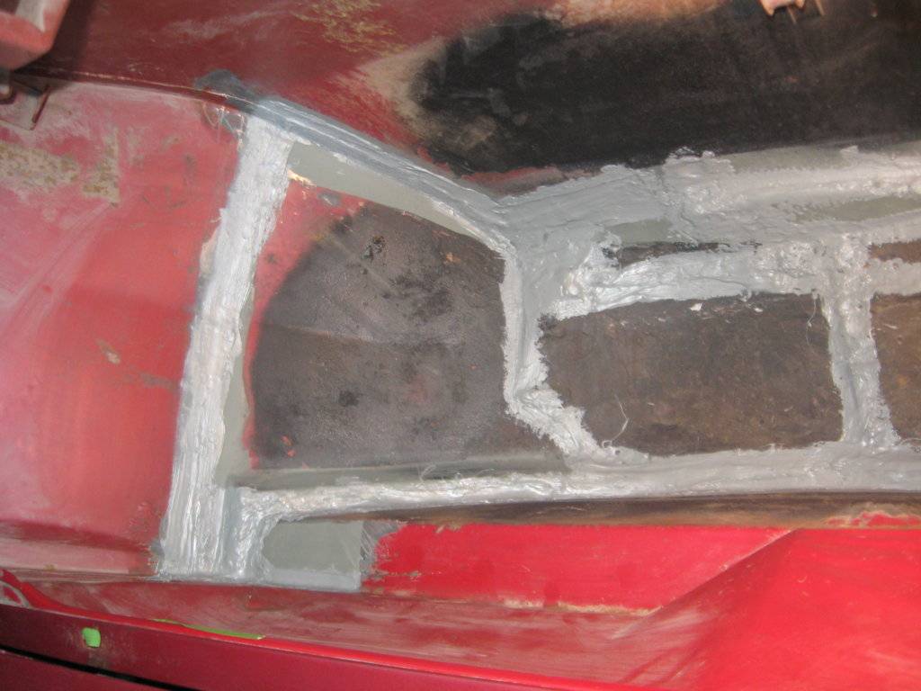

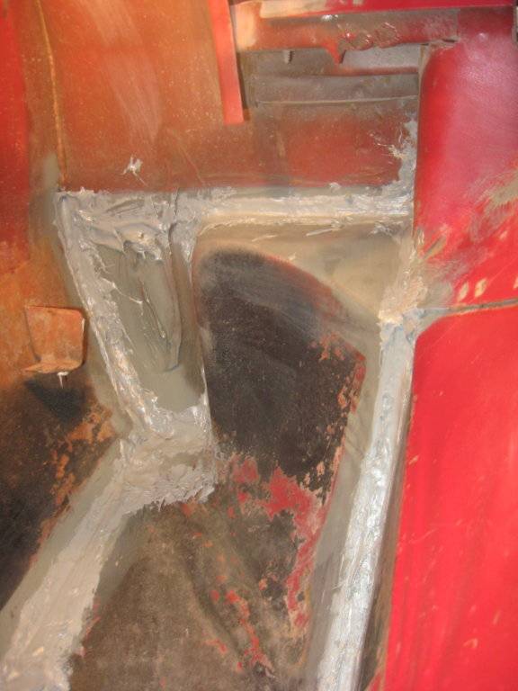

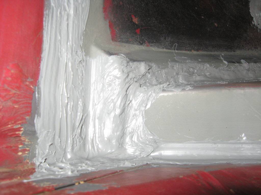

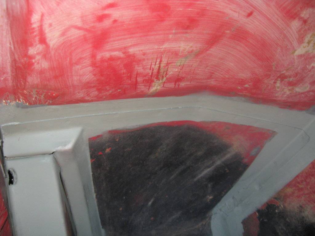

Update: I resealed all the suspect seams in the tire well today when I got home from work. I used a product called Transtar Seam Sealer. The Auto Body supply house was out of the 3M product they said they sell equal amounts of both products. I asked the body guy who repaired the rust on the wagon and he said product is good and easy to use but he uses the 2 part type or a single stage that both require as special applicator and for my application he recommended it. it was easy took me about 45 minutes to doo the whole job. I think it looks great. will let dry overnight then paint. directions say it can be painted in a hour. I put it on heavy in a couple spots so wont hurt to wait. here are some pics of before and after
A little extra cure time never hurt. Looks like it ought to work.
