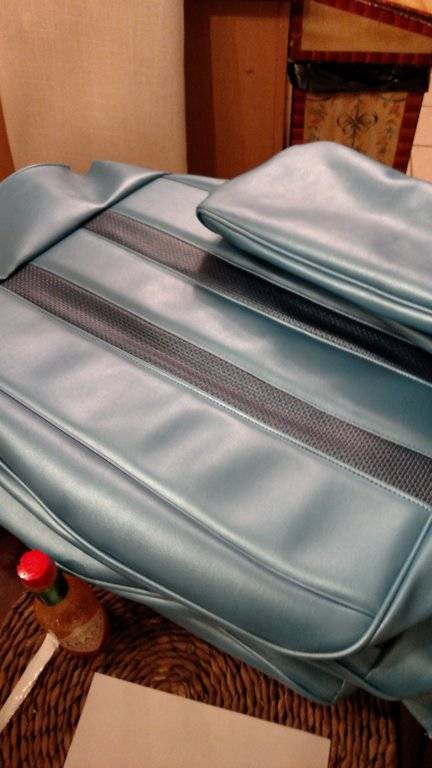

Ordered through Dante's. Made by Legendary. Includes armrest and map pocket. Can't wait to put em on.
Looks nice. I ordered my Legendary covers from Dante's also. Got them in last week, but haven't opened the box yet. You will have to post some pictures once they are installed.

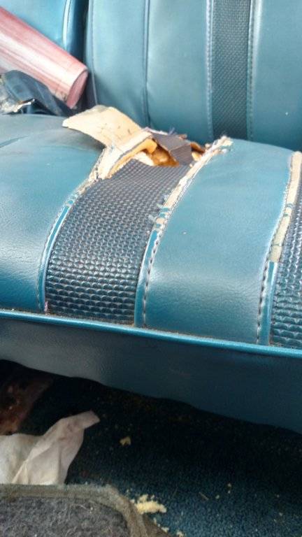

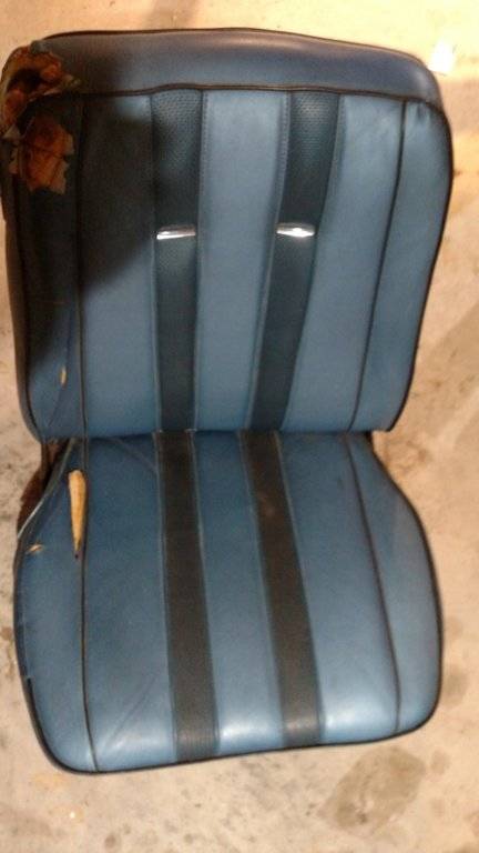

Pic of driver's seat. Worst one of all. We have a local place called Foam and Fabric that should have foam that would work for replacement.

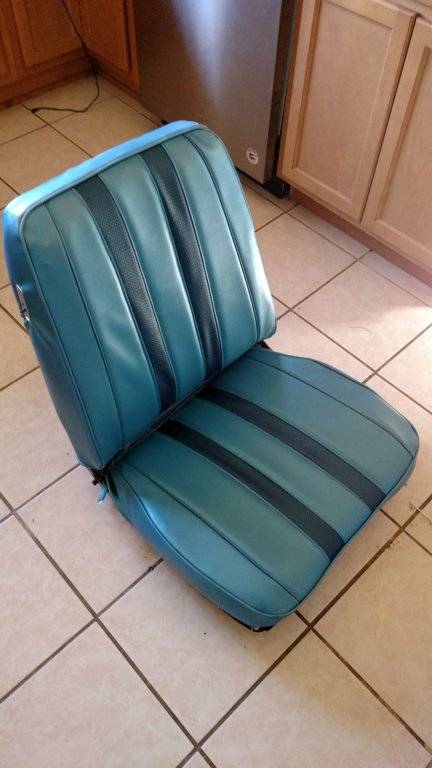

Nothing like having a good seat cover to replace the less than perfect ones they replace! I felt like I had a new car when I got the correct bench with a freshly recovered seat.

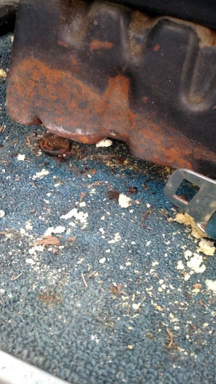

Just discovered that the driver side seat has no bolts on the left side. Photo is me holding that side of the seat up.

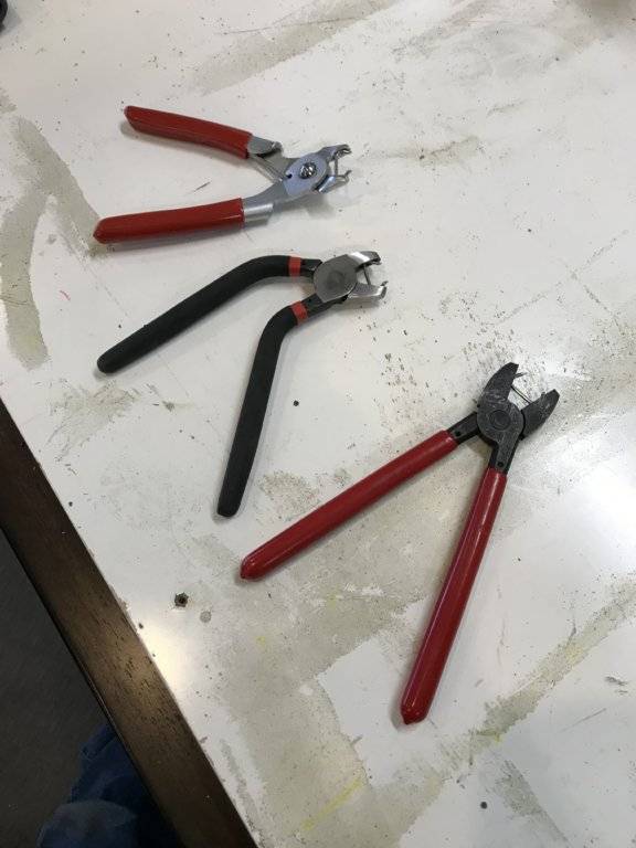

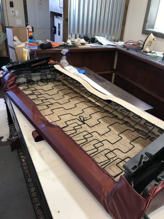

Make sure your recovering space is warm and take your time. The next day you will feel like you just wrestled an alligator. Don’t forget your hog ring pliers.
The bent handle ones worked the best followed by the ones on the left. Start in the middle and work your way out smoothing and stretching as you go.

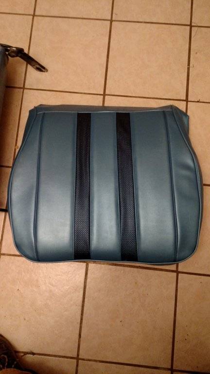

Got the bottom on. This is a tougher job than I imagined. I have rheumatoid arthritis, so I will probably feel this later.
I had to hold the last end down with my knees to get enough give to get it done.
